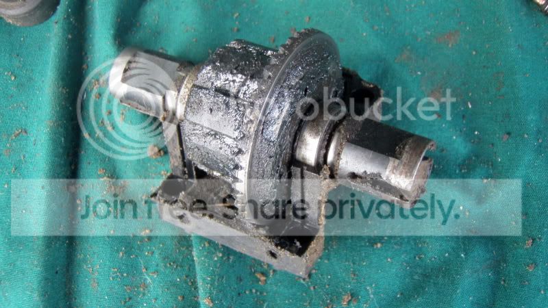

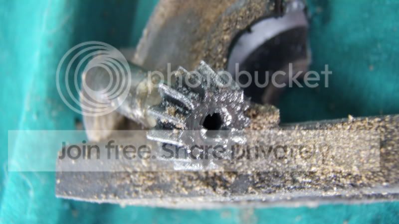

thats my diff... anything wrong?
Look inside the diff cup and make sure the gears are still good. If everything is good, try checking your slipper.
