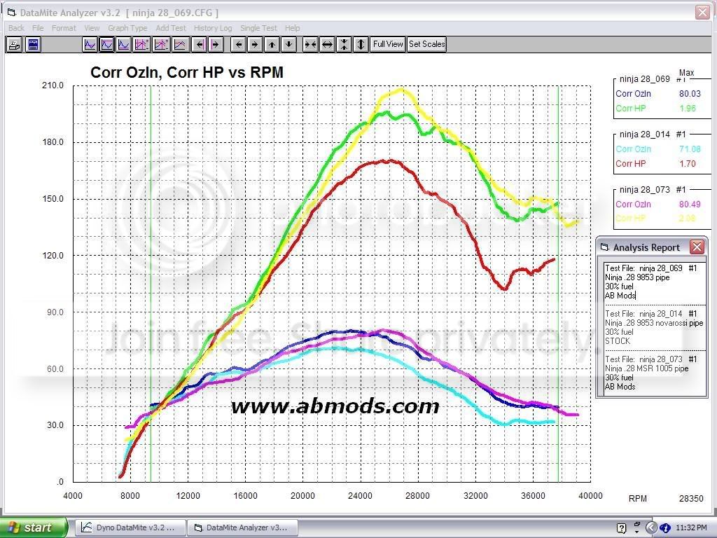

Ive never looked into coverting them to pull start... BUT i do have dyno sheets on it for you 🙂
