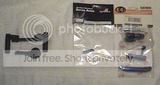

GH Blue Steering BellCrank w/ Bearings
GPM Blue Engine Plate
GPM Blue Arm Lock plates
GPM Blue RollBar

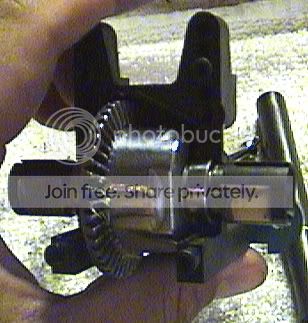

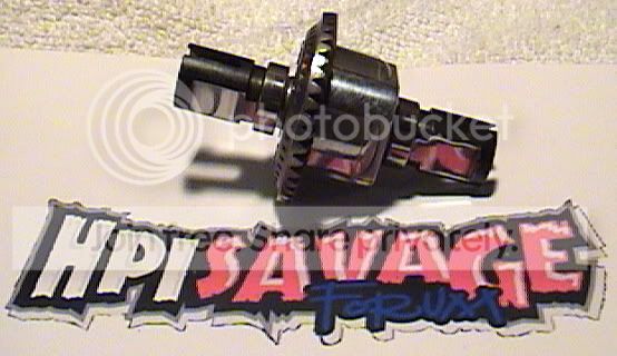

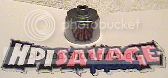

HPI Aluminium Diff Cups w/ new 4 gear diffs (added some bling, look below)
BEST CVD's for both front, rear, and center
Newer Steering Servo Hitec 5945MG (Have HS-5955TG on its way)

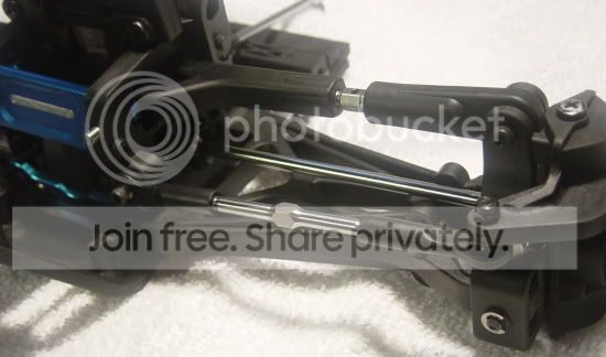

Lunsford Titanium turnbuckles

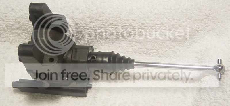

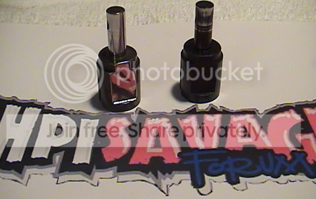

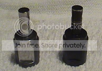

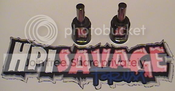

Polished up the out drives and Diff cup.

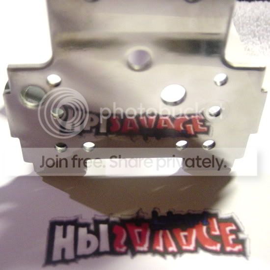

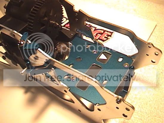

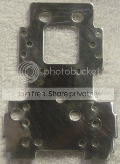

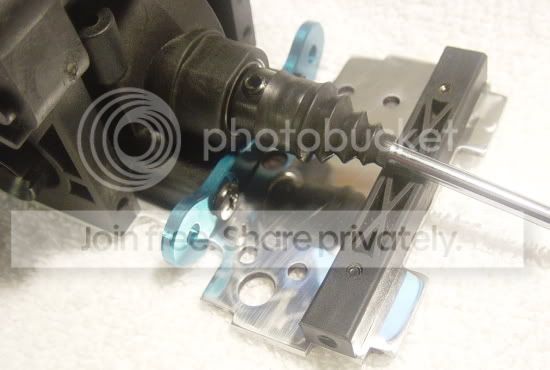

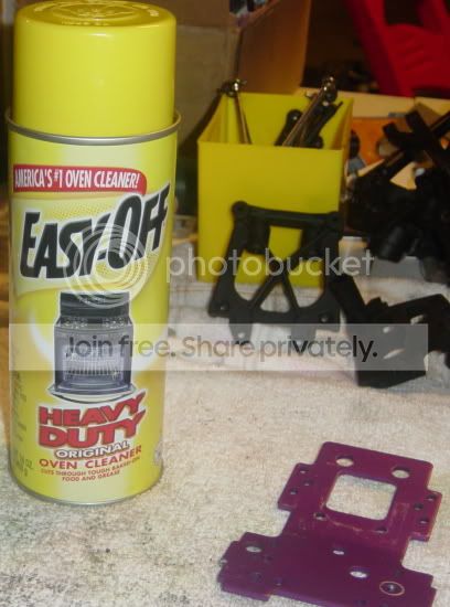

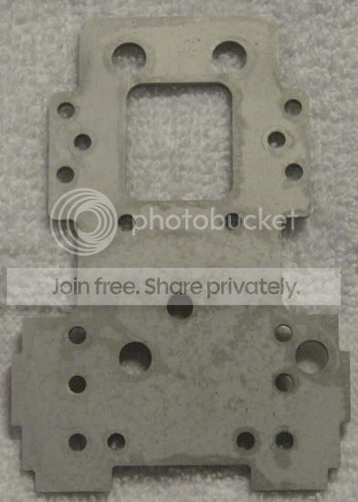

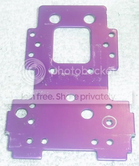

No more purple. Here was my process for the Lower BulkHead. Started by useing a can on easyoff.
And the lower plate.
I got this.

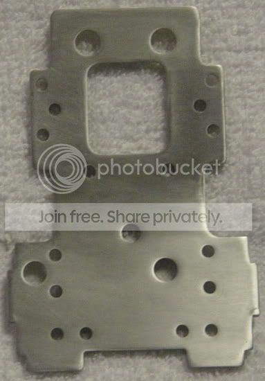

After that I started using some "600 grit" sandpaper to remove the rest of the white. And got here.

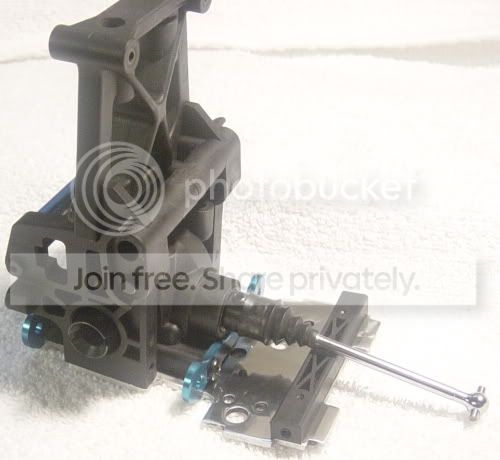

Then I used 2500 grit sandpaper, and the dermal with some polishing to get here.

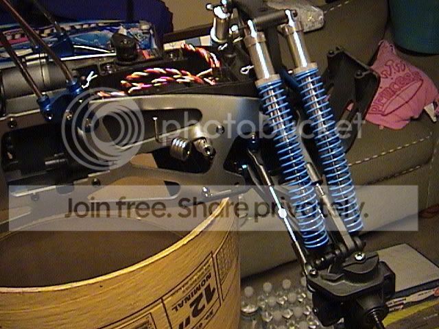

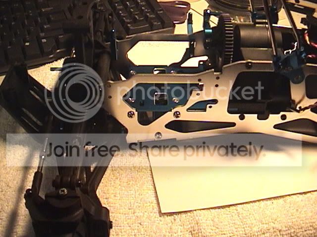

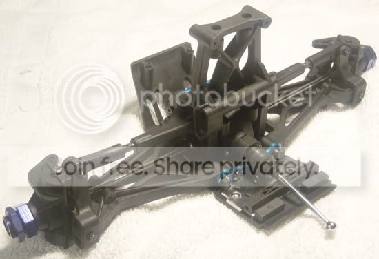

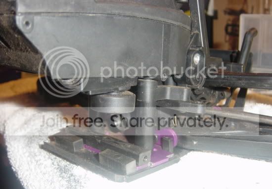

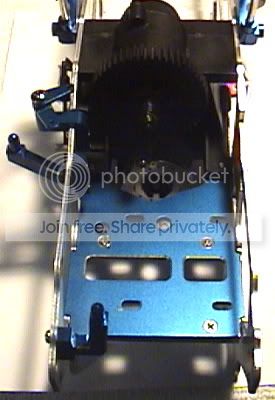

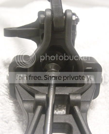

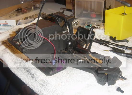

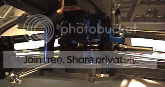

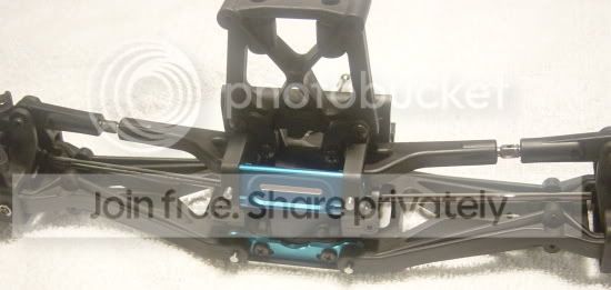

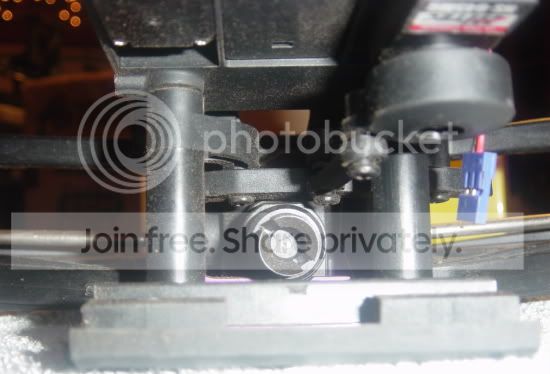

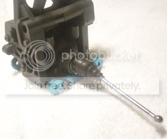

Before shoots of the front End.

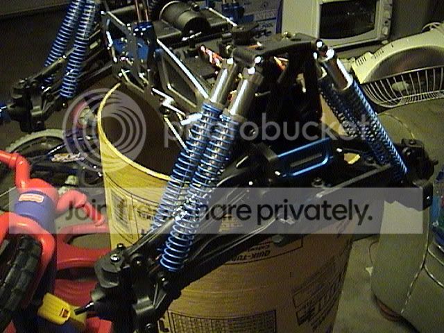

After Shoots of the Front End

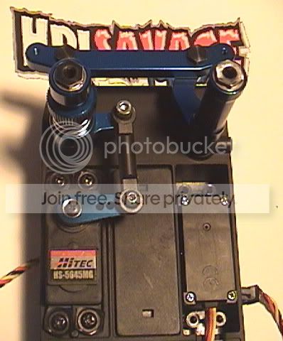

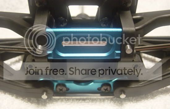

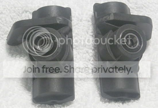

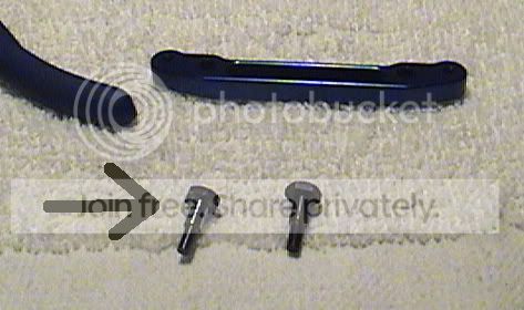

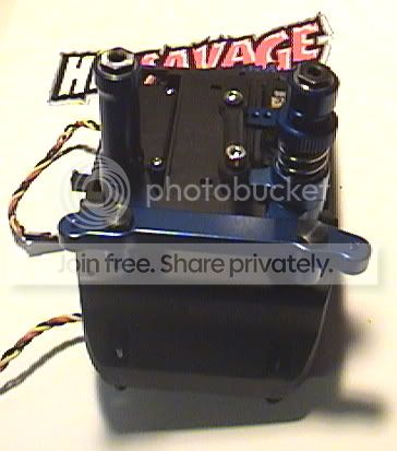

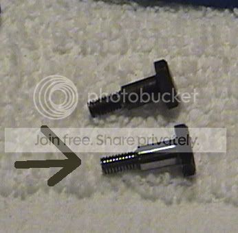

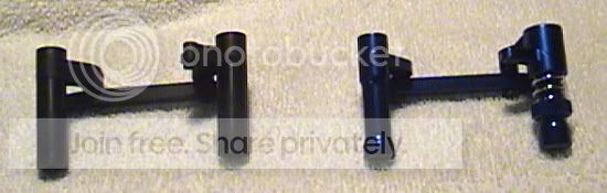

I had to mod the screws in the GH BellCrank.

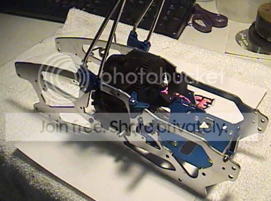

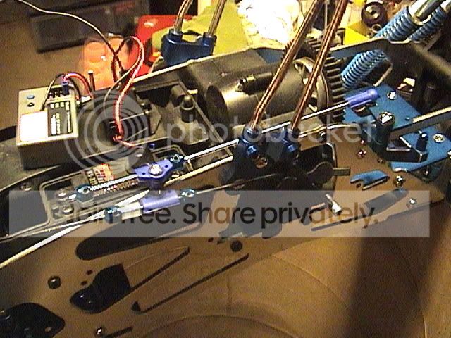

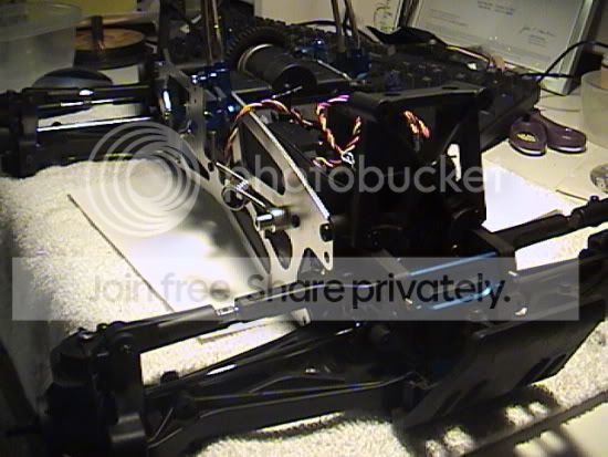

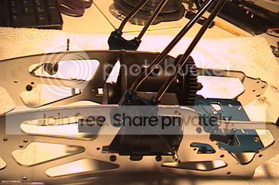

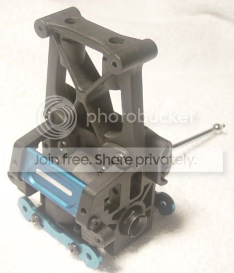

Here is the center
Close to the finish line.

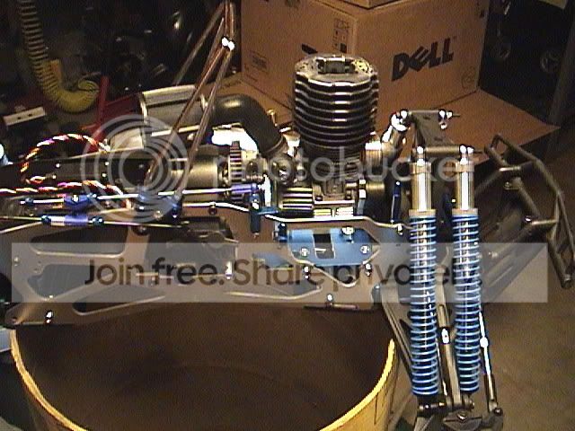

OFNA Throttle Linkage
Some finished pics with the wheels and body are to come...
skip the 600 go straight to 1000 other than on the tooling marks and from the 1000 Mothers and a rag. 2500 is a waste of time. No dremil it adds swirls
Mirror results every time.
That mill plate is not clear but is the running joke. Its against a mirror for the QC shot. But de-ano weekens parts just FYI this one lasted two weeks b4 cracking. They need the hard facing it provides

What was up with the GH bolt?

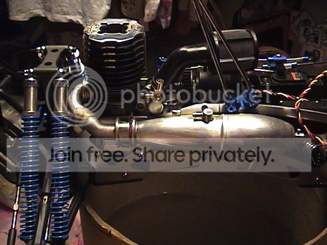

Last ? what pipe is that it looks bloated.
I would have to disagree with this, my process in cleaner and way faster then I'm picturing the process you are refering to. I'm using the 600 grit to remove the white off the plate that the easyoff did not get. Then I'm using the 2500 to get the mirror affect. Then I use the dermal to fix the spots that the 2500 grit did not get.
Cool Ive yet to find a polishing tip for the dremal that does not leave a mark on the finish. How long does that method take? After easy off mine is 8-10 mis per a piece faster on flats then in threads. I use the 1000 because the chemicals in the mothers don't need it finner than that to take it to a mirror finish. But if you hit it with 600 first those marks must get sanded out. Hit the pieces you have done with the mothers! You will be stunned if you don't use a dremil that is.... it will make it worse. Just a soft rag and don't push down!!! It does the work for you. Pushing will leave marks too.:resp: you will be able to place it on a mirror and not see any difference Between the two!
