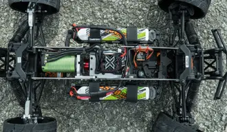

My new street basher is complete and ready to kill some tires, I build it like a kit, had to order stuff from quite a few shops to build it like I wanted.
Some of the mods:
º Machined bulletproof diffs
º Modified diff cups to mount 8x16x5mm bearings
º Aluminum rear hubs
º 20 Kg Absima servo ACS1622SG
º Alza racing center diff kit

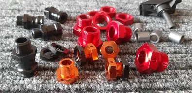

º 24mm hex hubs
º HPI RF-50 Receiver
º GTXL-1 VINTAGE BODY HPI-110238
º Castle MMX 8S + 1650kv motor sensored
º CNHL racing series 9500mah 11,1v 3s 90c batteries
º Modified dogbones with bigger pins in one side
º 46t spur/ 24t pinion

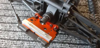

Diffs:
If you guys notice, on the hub side, the pin is a little bit short for the size of the shaft:

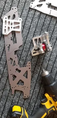

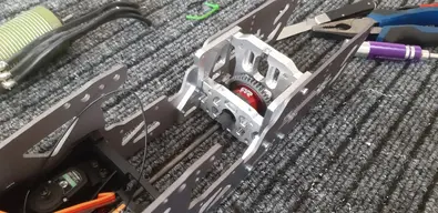

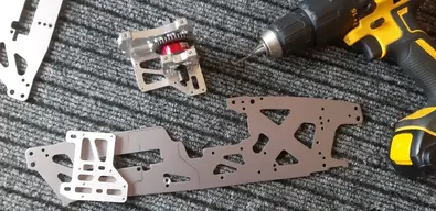

When you buy the Savage Flux GTXL-1 it comes with two different TVP's, the right side TVP is different from the left one, to accommodate the gear box, the right side one is a little bit weaker than the left one, I'm using two right side TVP's on this build, it's just a speed basher, so I don't need a very strong chassis. Well, the Alza center diff kit will work with pretty much every chassis as long as you drill the holes in the correct place to make it work, that's what I did. But Alza sells a chassis with the holes already in place.
