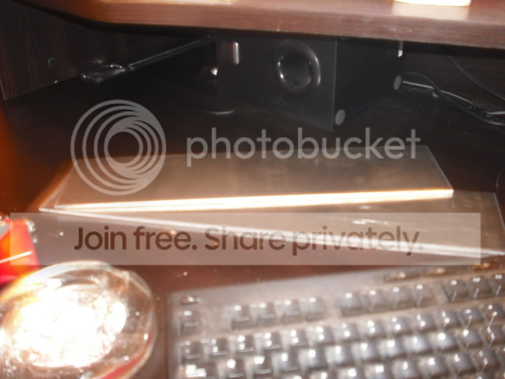

ok just scored these 1/8" plates of 6065 aluminum and i have 2 savages hmmm can any one say custom project ? i was thinking along the lines of japans race savage with the sidemounted motor but use the savage trans i still want a basher but i want something different.

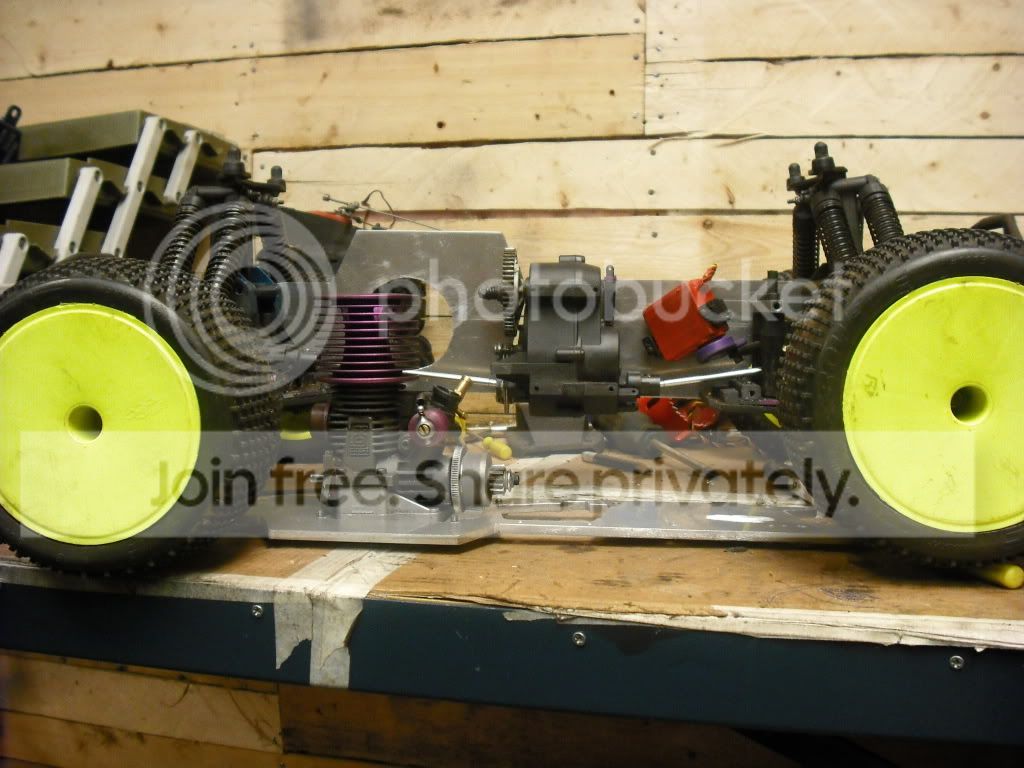

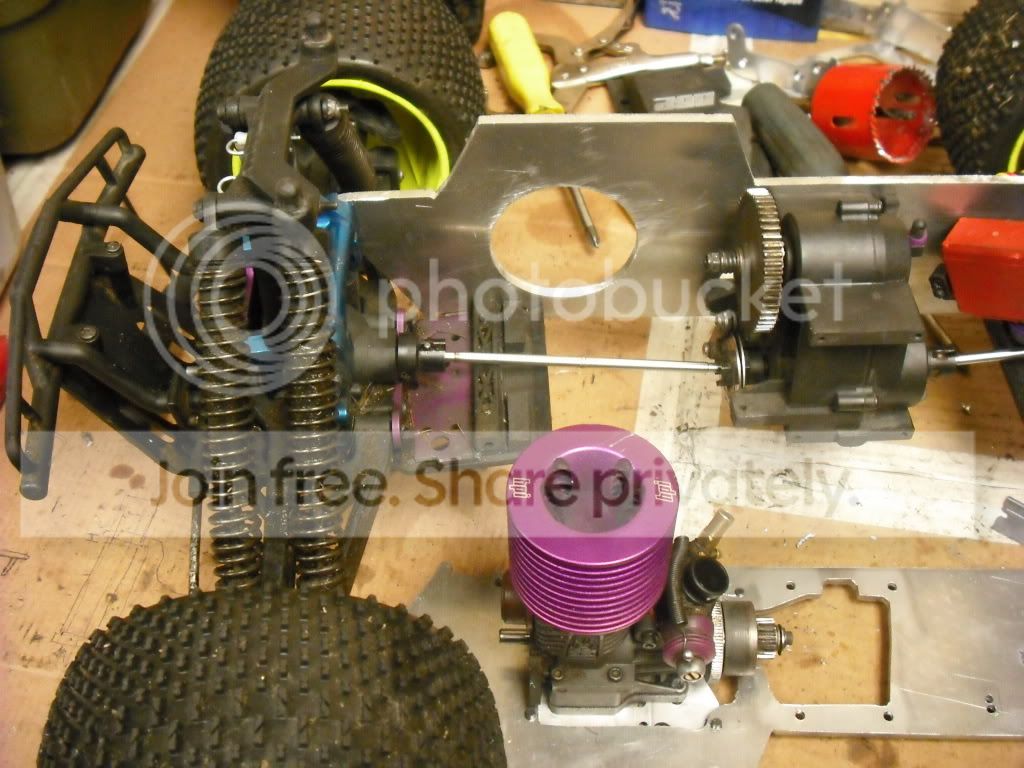

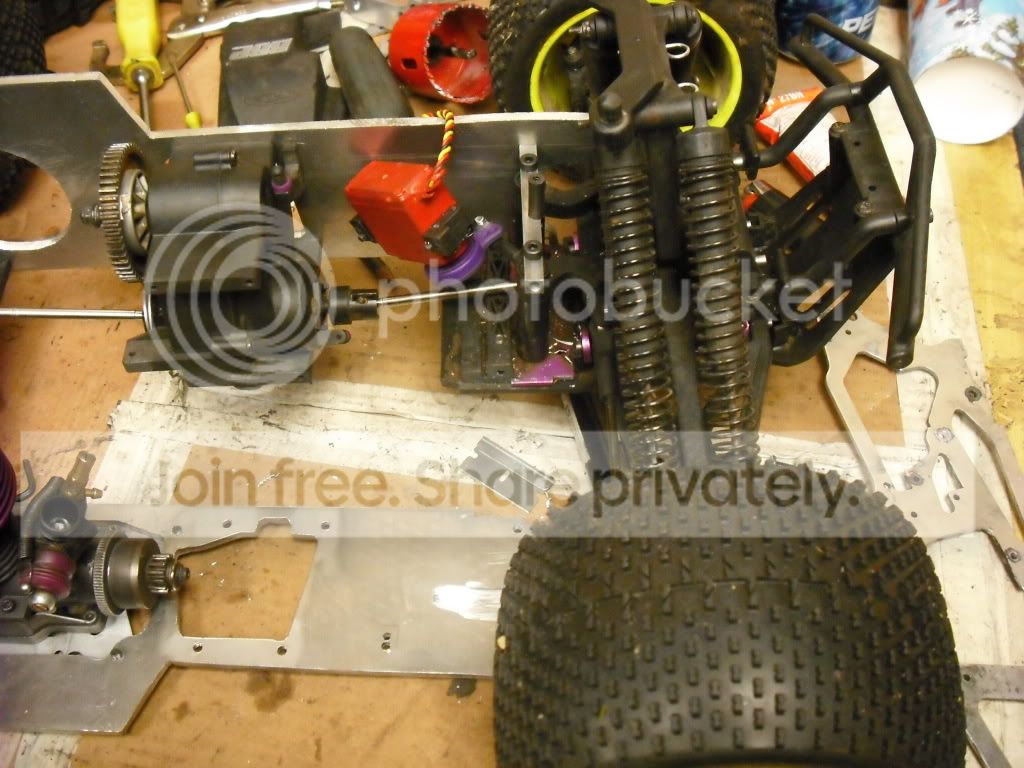

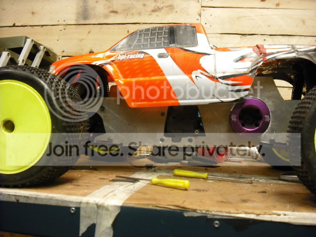

well i got started today on this project and got cut short by a burned up saw need a new one lol . got the tvps outline cut out now its on to the insides and lay out of the truck . i figured on using the savage trans which i will be able to do . I'm just putting it in the chassis as low as posible and with the engine on its side it will sit low enough that in gonna have to make a skid to protect the brakes. they will be hanging out the bottom of the truck . will add pics once the truck is together and running. should be good .

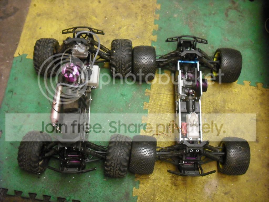

ok so i lied here are some pics of what i have been up to with the project .

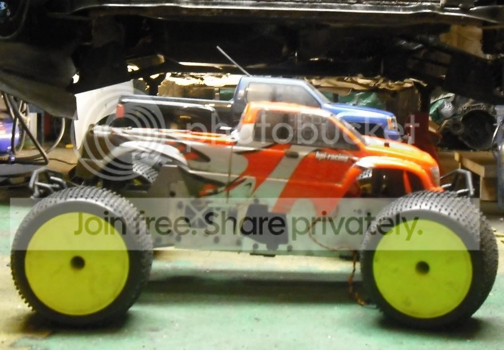

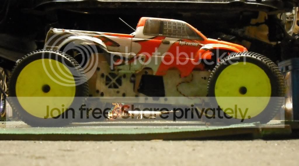

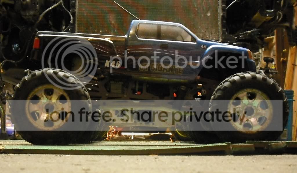

here is a shot next to my xl

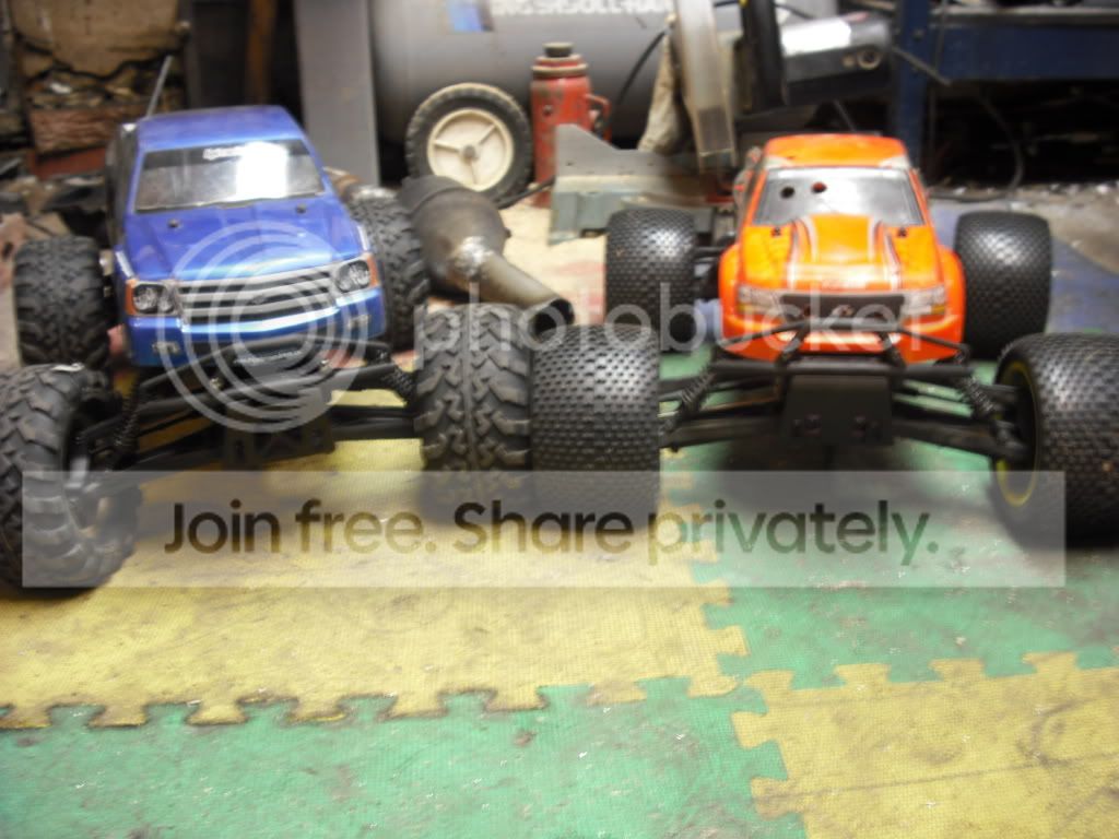

this shot shows the difference in ride hight the best
mickey, that is a very interesting project .... never seen anything like that... what benefits does the side-mount offer over the conventional way? looks very well protected in there! nice work/very creative...very interested in seeing the completed project... + rep..
sweet should go fast, be durable, and handle well. You should get some short shock tower and get some proline, or buggy shocks on there. The truck would look just like a truggy.

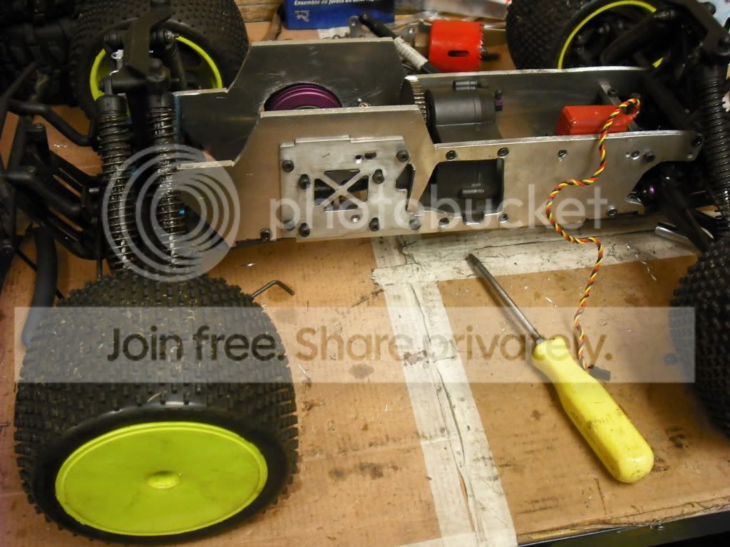

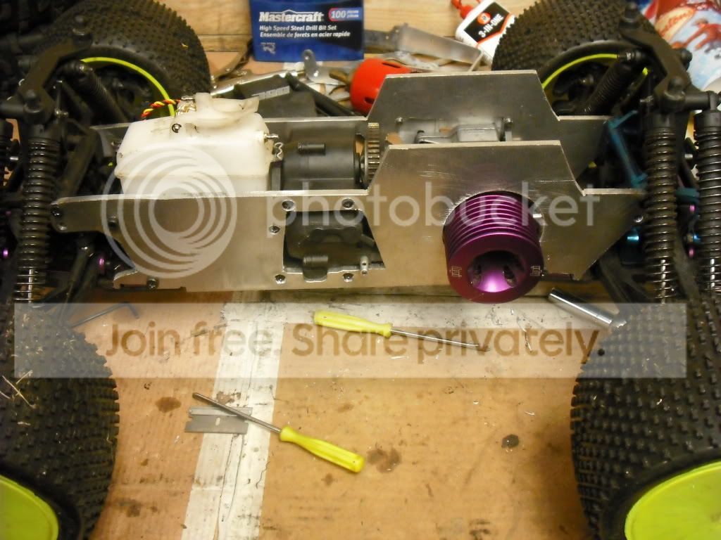

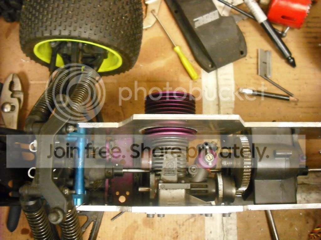

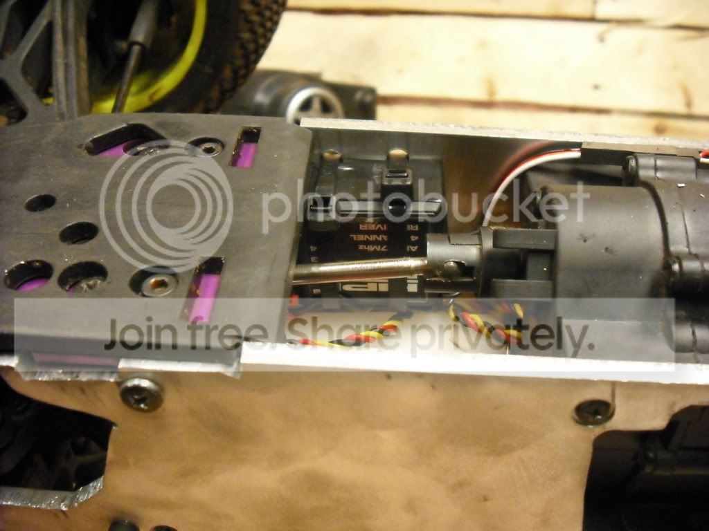

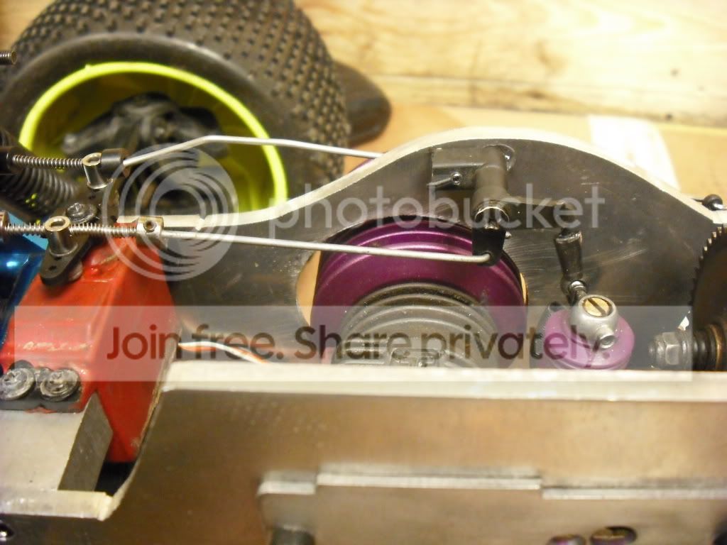

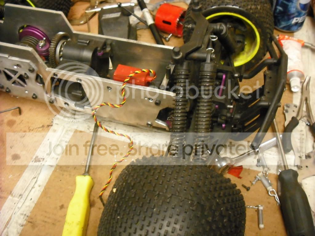

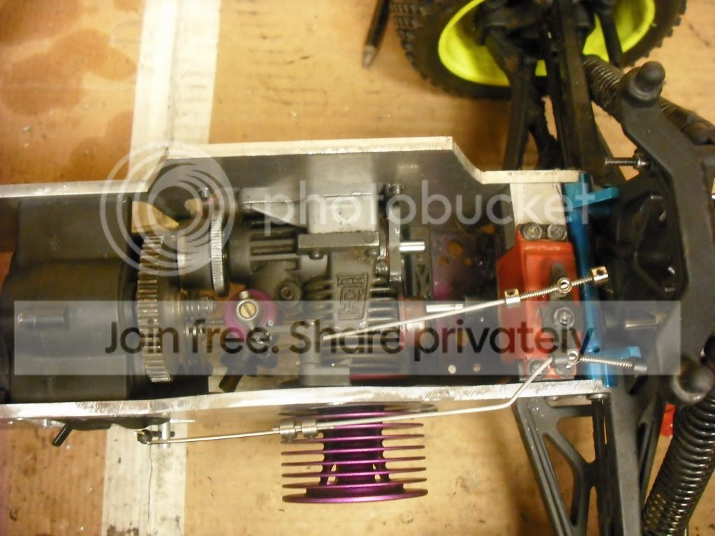

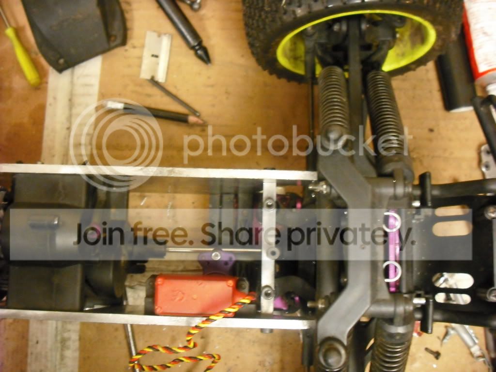

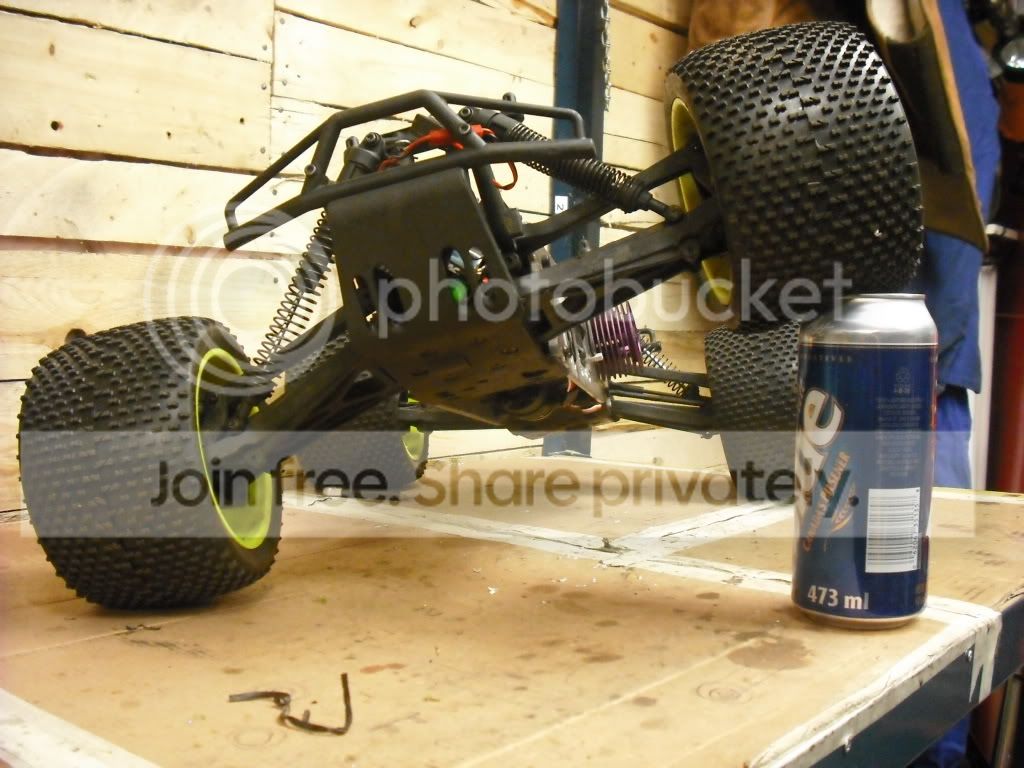

its still a work in progress I'm workin on getting some shocks and modding the towers to lower them . well here are some update photos of where its at now. got the linkage to work with the brakes and throttle. trimmed down the one side tvp and got the reciever mounted.
heres a little flex shot lol i need swaybars
and a 11 second vid to show the linkages working
coming out nice mickey, your linkages are workin' real smooth... any idea when you are gonna run it?
well its snowing here so no vid yet and the sock savy exhaust manifold just wont work gotta get one from an xl or hellfire and mod that to get out the frame. gona put the air filter on and trim the other plate today and reoil the shocks to thicker oil.
