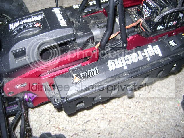

Something I would like to fix, however, is the battery boxes. These batteries fill the width of the boxes entirely (maybe even warp them slightly) and because the covers don't lift entirely vertical they can be hard to get in and out for charging. Does anyone have any tricks to allow the battery covers to open completely?
Thanks in advance.

Is the box catching on the battery or is it the hinge itself that's not opening all the way?

Pic 2 is for WoodiE showing the battery cover. That's as far as either open. If they would just open to the complete vertical then the batteries would pop in with no issue.
OK, this may sound stupid, but can't you just put the right one on the left side and vise versa? That way the hinge would be to the outside, if you keep the battery's wire exit in the same location.
I did think about that, but that won't work because of the way it locks. It not clear in that pic, but towards the rear there is a horizontal "arm" with a piece of grass on it. That is one of the locking arms for the box. It's hinged from the bottom of the box and swing up to a locking tab on the top of the box.
So I could probably swap them, but then I couldn't lock the doors shut. Even as snug of a fit as these batteries are I'm pretty sure they'd bounce out pretty quick ;)

My other thought was that since it's not waterproof that I could trim a chunk out of the top (there is a bit of a pointless bulge on it) to allow it to lift more.
So here is a better shot of the box that shows the clamp mechanism. The box "fit" in reverse, but the screw holes on the forward and aft mount points don't line up. There are also mount points underneath (that double as part of the lock hinges) that will not mate up correctly to the chassis either.
In pulling it off though, I got a better idea of what the problem really is. I thought it was the top, but it's the lock tabs on the top that are actually the problem. If I turn them to the "locked" position that helps some (especially on the right side, but the left hits the ESC). So maybe removing the whole locking mechanism and going the velcro approach will take care of it.

Can you move the mounts with the box, so the holes line up?
Not without drilling new holes in the box, but they'd be so close to the existing holes that I'd most likely cut through into the existing holes and make the mounts useless.
I think leaving them mounted as is and just removing the plastic locking system and replacing it with straps will take care of it. I appreciate the idea and the spur to look closer at my problem.

Not sure if what I said was correctly understood or not. I meant to leave the mounts screwed into the battery box, but detach the mounts at the TVPs. Then switch the whole assembly to the other side.

Got distracted by working on the real cars and a broken toe, but finally tore into it today. What I found is that what prevented it from fittingly correctly when I played with it last time was some tabs on the underside of the fore/aft mounts. A hobby clipper and file took care of those and everything fits perfectly reversed.
Here are the the before/after for the tab modification:
The underside of the box where the under mounts connect as well as the chassis without the boxes to show where the under mounts are. The lock arms are attached with pins that are threaded at the "top" so they came right off:
The finished product. I picked up some Team Associated battery straps to wrap around the boxes (2 packs of 3 for like $7):
Hope this helps someone else.
