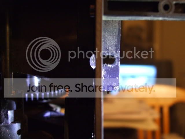

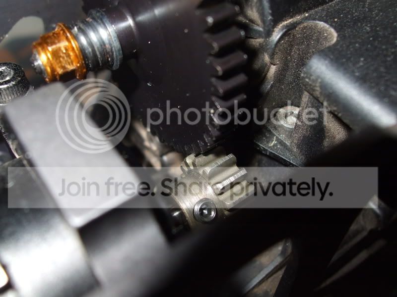

I got a new ESC :rock: it should be here next week sometime. I have fitted the new flux 45t spur, RRP 14t pinion and slipper pad. I wish HPI make bigger spur gears because it's going to be a PITA to set the mesh. I had to notch the motor plate mount to get enough adjustment on the mount for a good mesh. Now the outside screws are under the TVP, so I'm going to have to set the mesh using the other screws, then remove the motor plate with the motor attached, tighten the last two screws then refit it. Here a few shot of the progress.

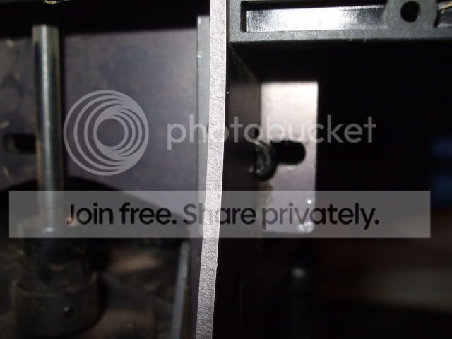

The heat of frying the slipper stuffed the locknut, so I replaced it with nice new shiny one. :bling:
DOH!!
Thanks to a round ba$tard. :lmao3:
That a bit better.

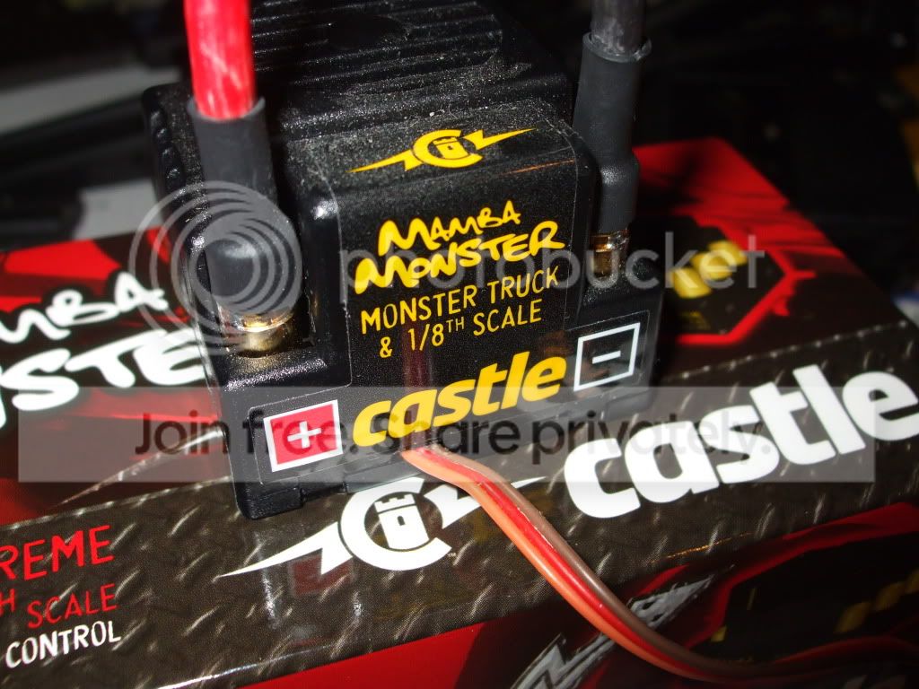

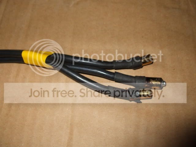

There a little worse for wear, or should that be ignorance. :retarded::bigsmilie: I'm going to shorten the motor wires about 50mm for a neater fit, instead of having to fold them under the body mount.

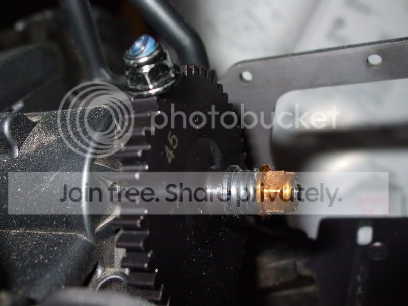

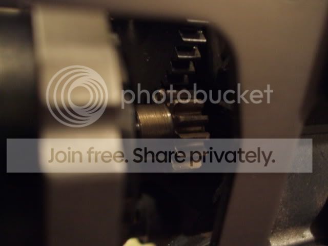

I also got a question, the pinion doesn't quite come to the end of the motor shaft, is that OK. Or should I file a little more flat onto the shaft, so I can move the pinion back making it level? Thanks.
nice work. let us know how it works out. funny how the swear filter wont let you say the name of your file, lol
As long as the shaft isn't more than one or two mm deep inside the gear, you should be fine. Lots of guys are using the Novak pinion with no problems just like that.
And HPI does make a 52T steel spur, but you'd have to use a larger pinion(16T) to get the gearing right, so you might not be able to fit that ratio in with a 52T...
Will do Freddy. Yeah, I had to do the file gag, couldn't help meself. :istupid:
I thought about get Robinson's 48t steel spur, but I wasn't sure if the spur gears were interchangeable between nitro and electric, so I got the flux 45t, probably should have got the 48t, but oh well. If I get sick of having to rip the motor & trans out every time I try a different pinion, I'll get the bigger spur. I've really got 15t and 16t pinions. Thanks Ascender.

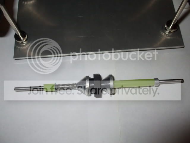

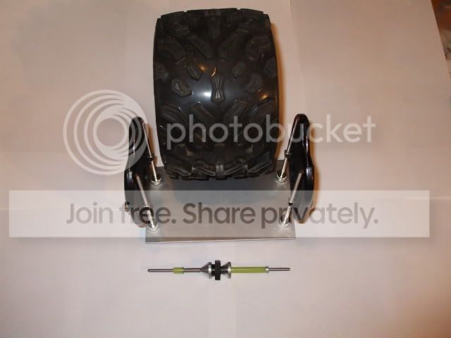

Also cut my wheel balancer base just need to get a longer shaft.

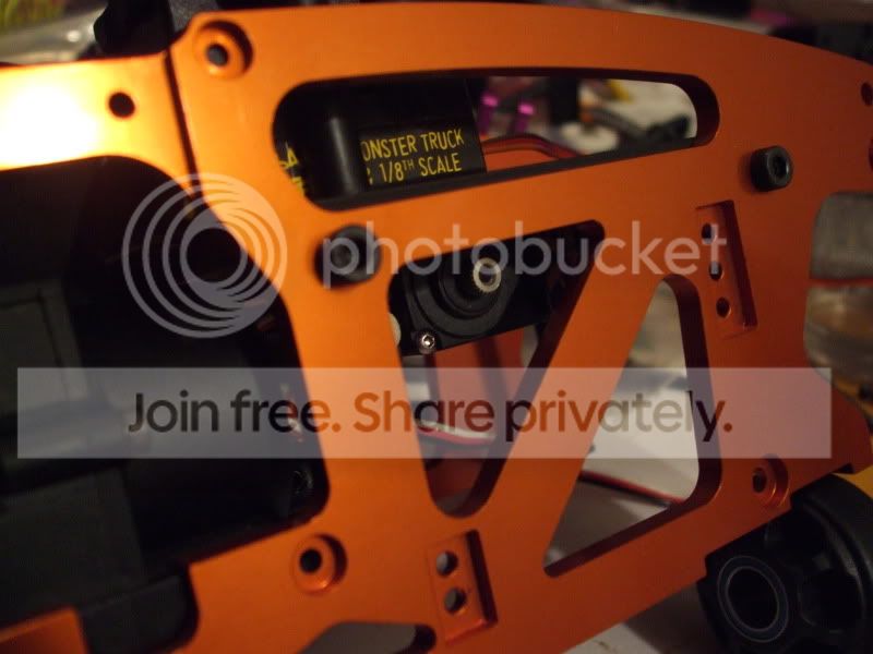

Well my new ESC finally arrived today, I got the new TCS TVP's last week, and hopefully I'll get the carbon fibre wing mount and RX plates in the next couple of weeks, so I can get my beast back together.

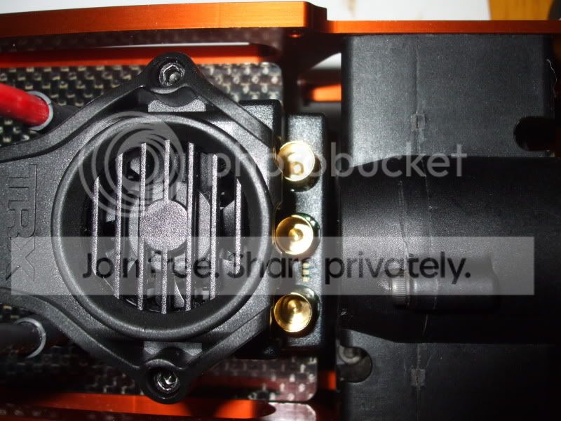

I'm been working on a new wheelie bar. It will mount to the skid plate and wing mount. Also moving the ESC up front.

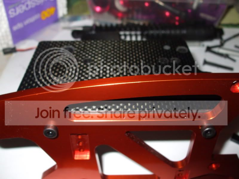

First carbon parts
Got my Carbon Fibre wing mount & customised PRC125 (250cc tank plate) yesterday thanks J.

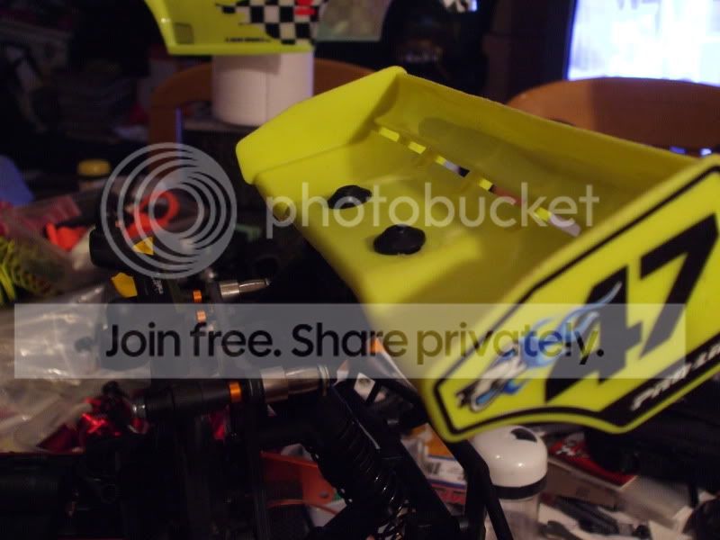

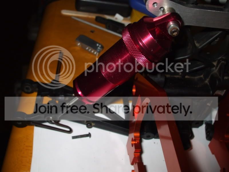

I can't use the outer IRC shock brace on the back now with the wing. Anyone know if just using washer to hold the shocks on the standoffs will cause me problems?
Just gonna use an old beat up wing for now.

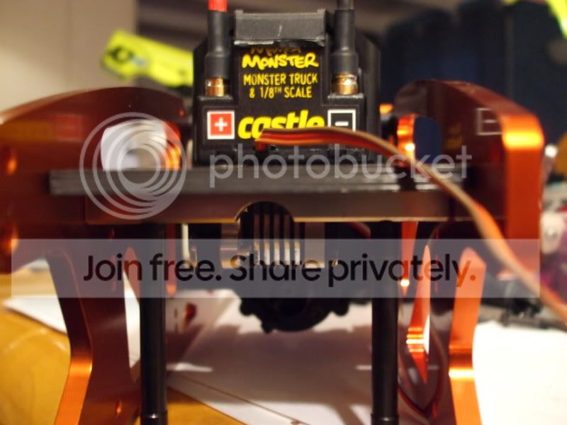

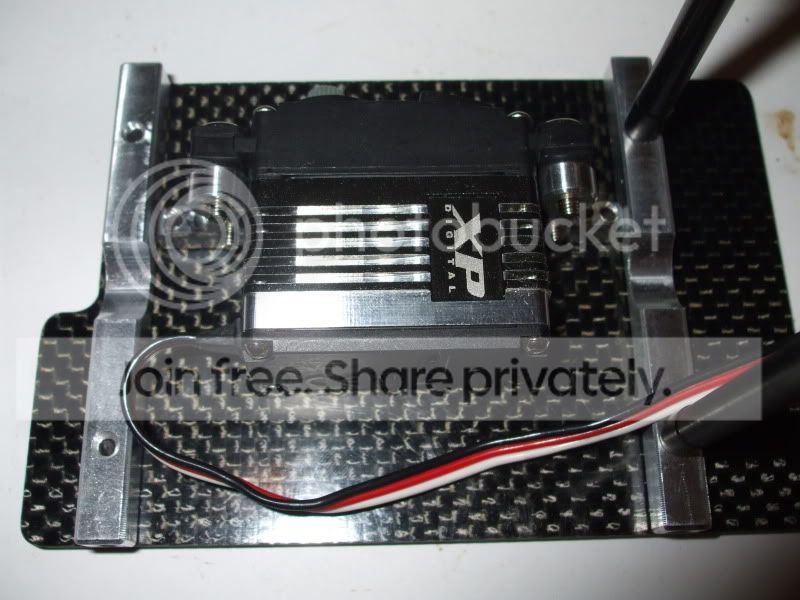

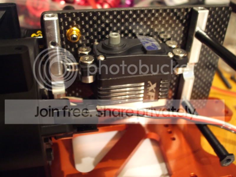

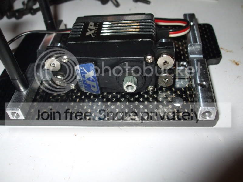

I had drill a hole in my TCS tvp,s to mount the rear support of the RX plate. I also countersunk the servo mount holes so I could move the ESC up front and secure it with a BL Revo mount. Turn out pretty sweet I think. Upgraded to an Associated XP DS1015 servo too.
Awesome truck mate!! Looks great!

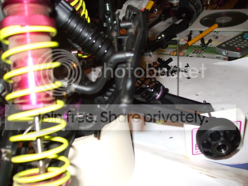

Iv got a PRC wing plate on its way too and using LST shocks w/I-RC LST kit, iv moved the whole rear shock assembly to the front of the tower/arm, leaving the whole rear of the tower free for the wing plate/stay.

No worries mate, i was trying to figure out how i was gonna work it with the I-RC kit and PRC wing plate, id seen others on here with the shocks on the front so i thought thats probably the best option.
Yeah, I've seen them too, just wasn't thinking. I did a quick mock up it it should easierly clear the tvp. Thanks for reminding me.

id adjust the shock location holes.your lower arms are sqating you whant the lower arms as stright as possible for better handeling
