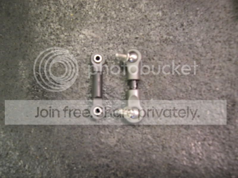

One more part I would like to upgrade is the short link that connects the servo to the bellcrank, but I can't find anyone that sells an aluminum rod or upgrade for this. Does anyone know wher eI can find a replacement for this?

As far as the steering link I've seen a few guys use the Baja linkage (hpi85467)
This picture is from FX's build <<<--Clicky
i did what dooley did, works perfect, mine has revo rod ends, you can also order just about any lenght turnbuckle from lunsford, that will NEVER break
