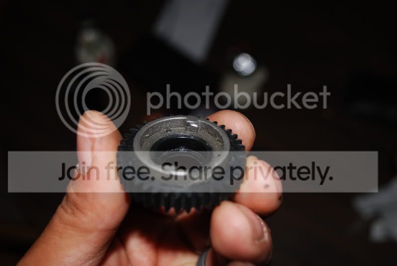

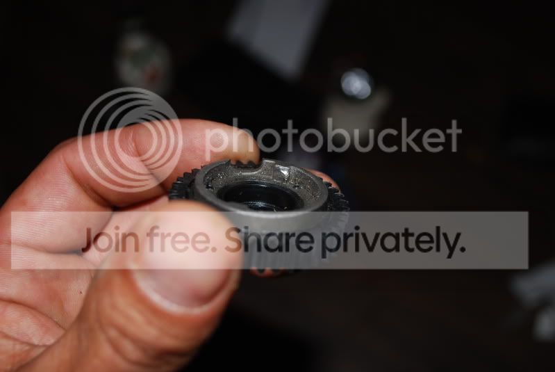

I would take out the gear pack and with my finger nail pull out the arm to make sure its not stuck for one. then check the pawls on 2ND gear. pic below shows 2ND blown out. Also if you took out the shift clutch make sure its back on the tranny in the right direction

to be honest with you i'm not sure what i'm looking for in the pics.....is it the grooves??
do both grooves have to be square like?? so that means the one with a curve is the one thats blown out correct??
in that case i have found the problem because i do have a curved groove as i recall when pulling it out..
alright man i just took mine appart and i have the same thing showing they are both stripped. i think i need a new one.
