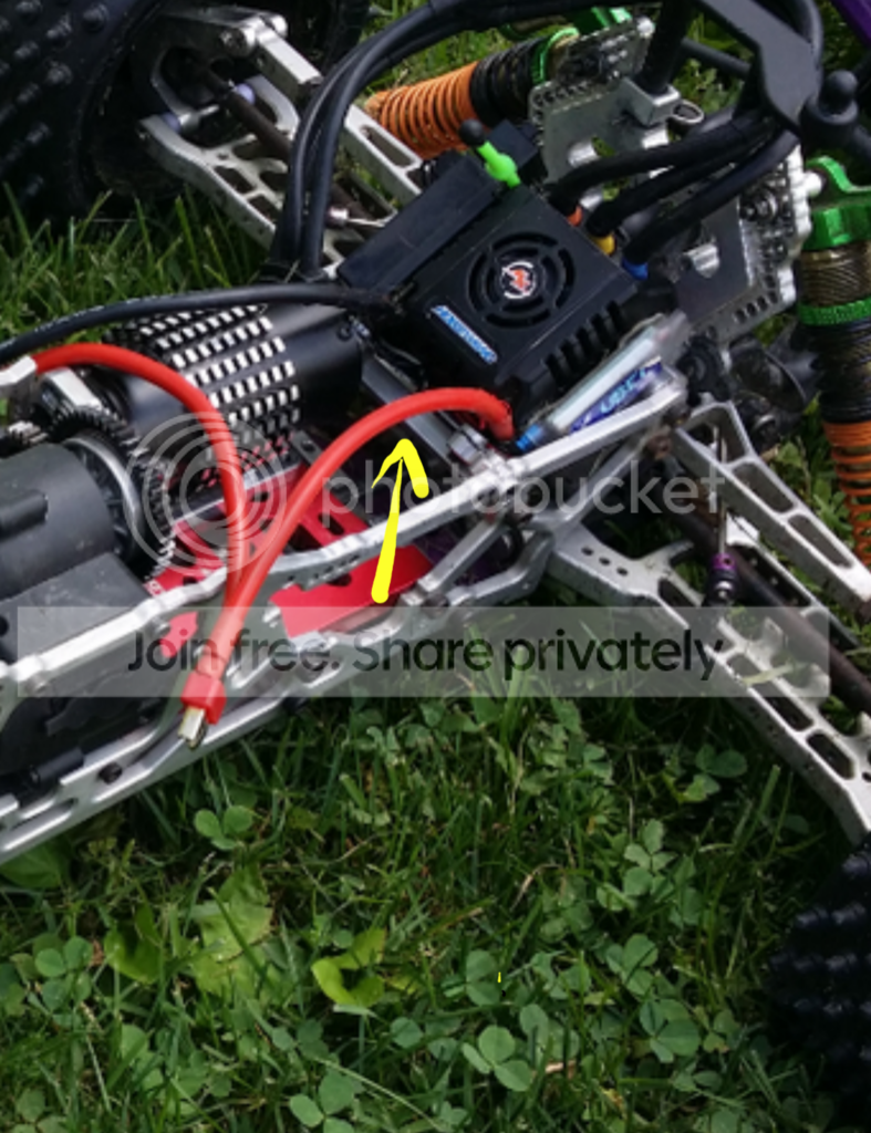

My new Savage Flux conversion. Alot of pics
Thanks ravaging-savage, if you have a bottem skid plate that should be enough to give you some extra bracing for when you cut the tvp. I went a step further and braced it at the top too so it's fully boxed in. I'll try to get some pics of the top brace.
i do have the skid plate. I'd like to see what you did when you get a chance. I was thinking Instead of going with a big pinion for more speed, which I cant fit. I will just get the 39t high speed idler and smaller pinion and gear it that way.
Just the skid plate will be fine. I ran mine hard and flipped it numourous times with no damage to the tvp's. I was also thinking of getting the high speed gear but I've read somewhere that there not good. But I'm not sure since Ive never ran them.
Ok I see what you did there.
