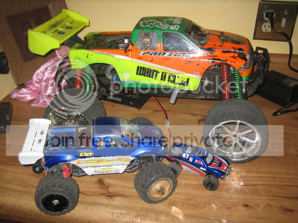

I wish I could put a 11.1V LiPo in this thing it would be crazy. I run a 5400kv BL and a 3 cell in my MLST but can only run a 2 cell in this thing as the speed control and stuff will never handle it. Here is a pict so you can see the size comparison between exteded savy 1/8 scale, Losi Mini-LST2 1/18 scale and Micro Desert Truck which is a 1/36 scale.
Holy crap that's a small rig!!!!!!! How much do those run? I've never even seen a 1/36th scale! My lord it's small! I'm gonna find one, and make it the cat chaser, it could handle the table leg turns better :D LoL That's pretty sweet man.

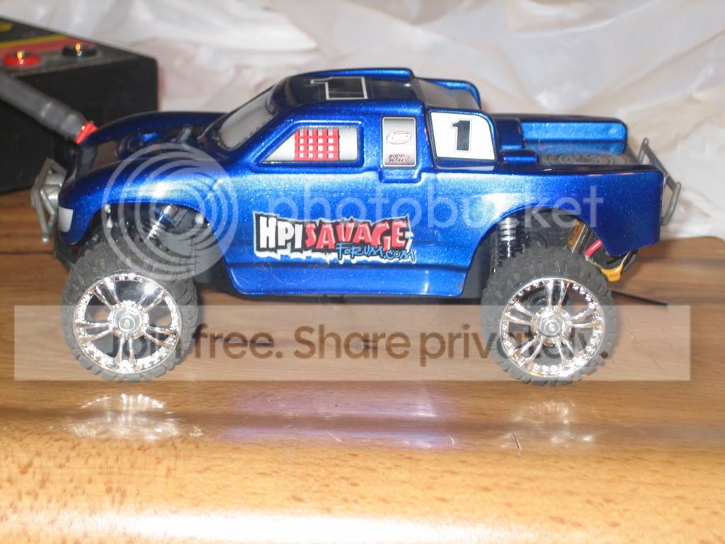

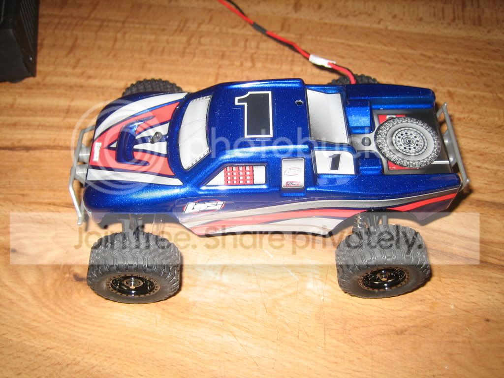

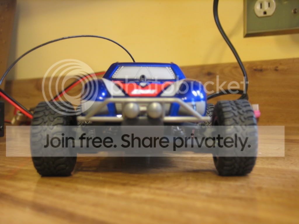

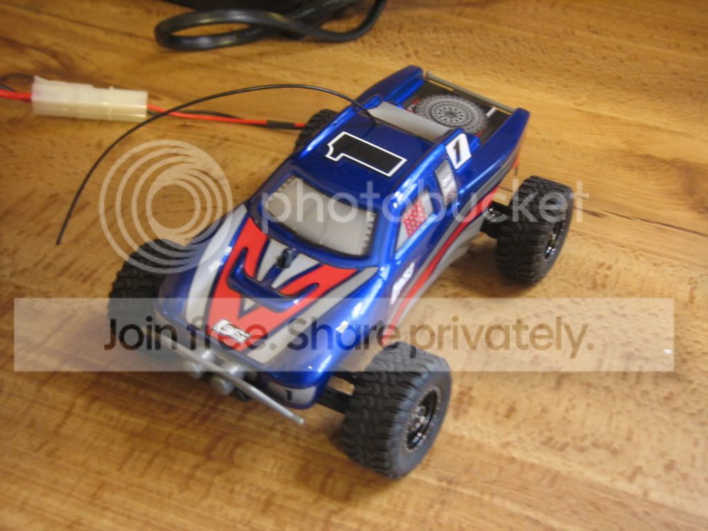

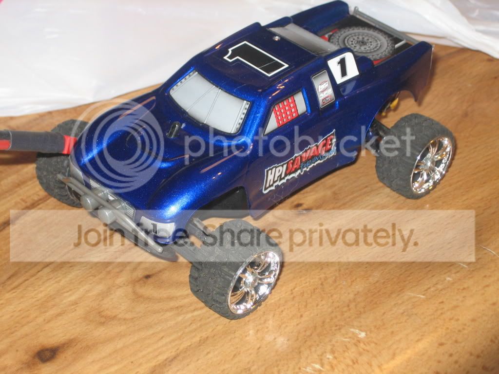

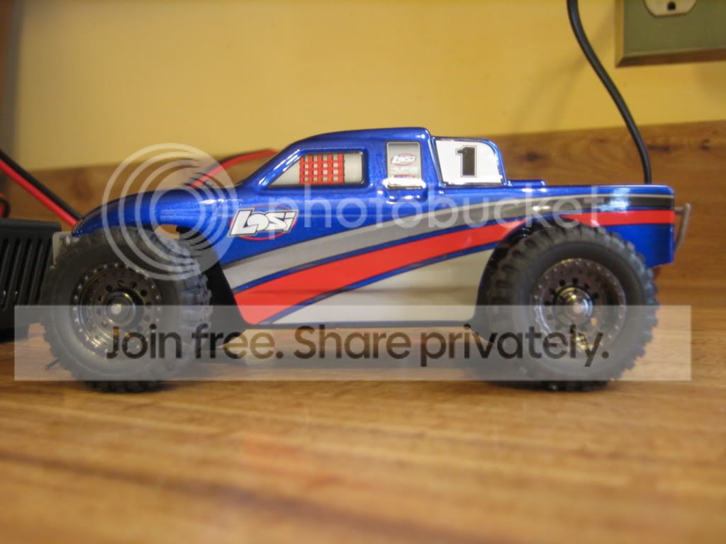

Yes the LiPo made a nice difference and the Atomic BB motor seems to have more speed and power with the LiPo. I also replaced the pinion gear with the middle sized one that came with it as it came with the smallest one this intern gave it a touch more speed. It is now about to fast for in the house but is allot of fun. My guess is it runs about 27-MPH now. I will get a video of it once it gets nice outside again.
Here are a few Pict's of it with all the changes now. I have added HR oil filled shocks which made a world of difference and have added some Atomic wheels and tires which are very soft and very gripy I also removed some of the stock decals. It will pull wheelies when it gets traction.
