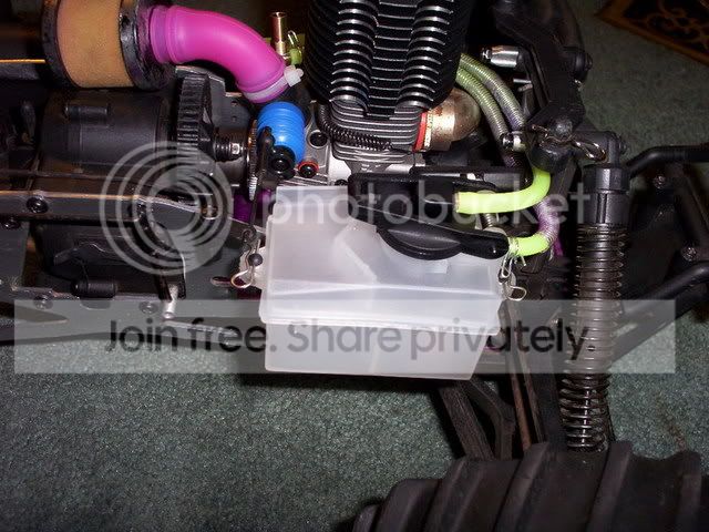

Ofna sells a tank that works very well for this, however it offers a shorter run time due to it's size and it requires some basic tools and fabrication skills.
Ofna Tank Clicky Here
Here is a photo of an installed tank:
  • Photo credit to Twistedsavage - Lake in the hills, Il.
