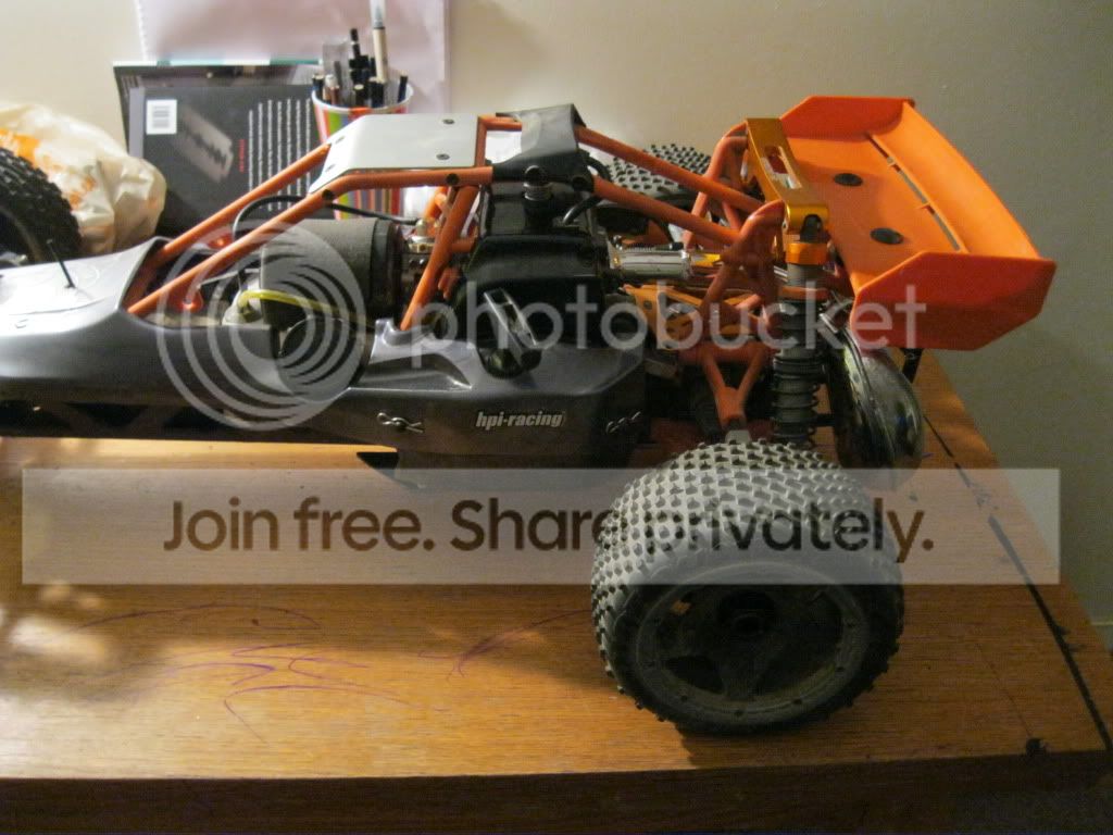

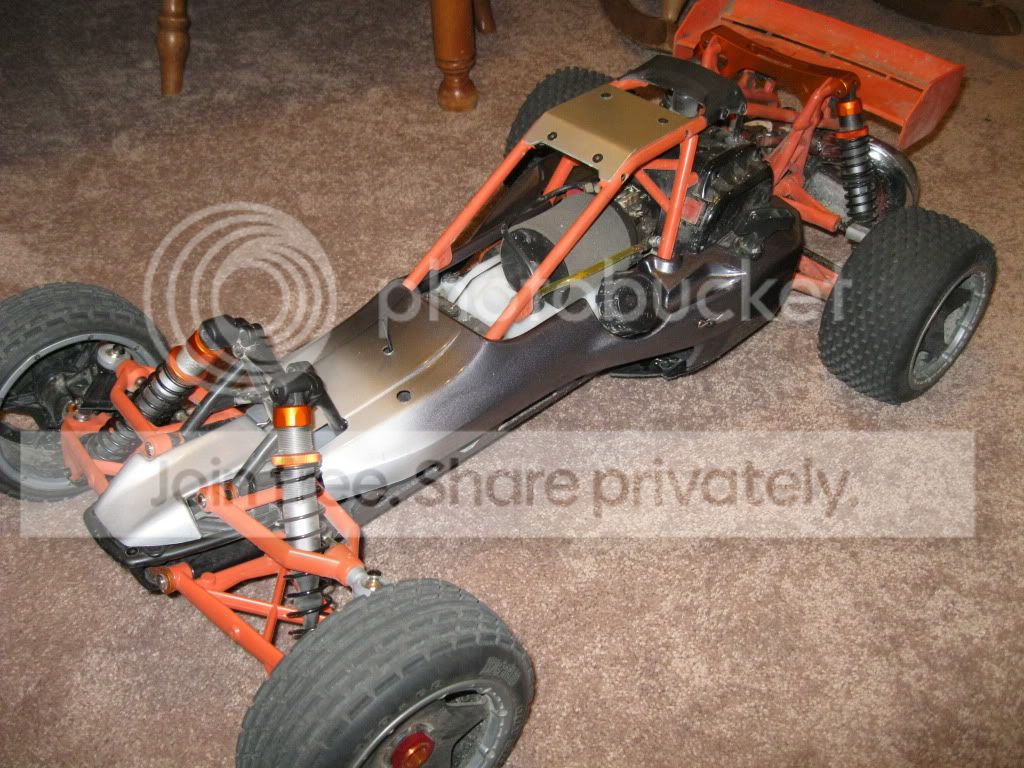

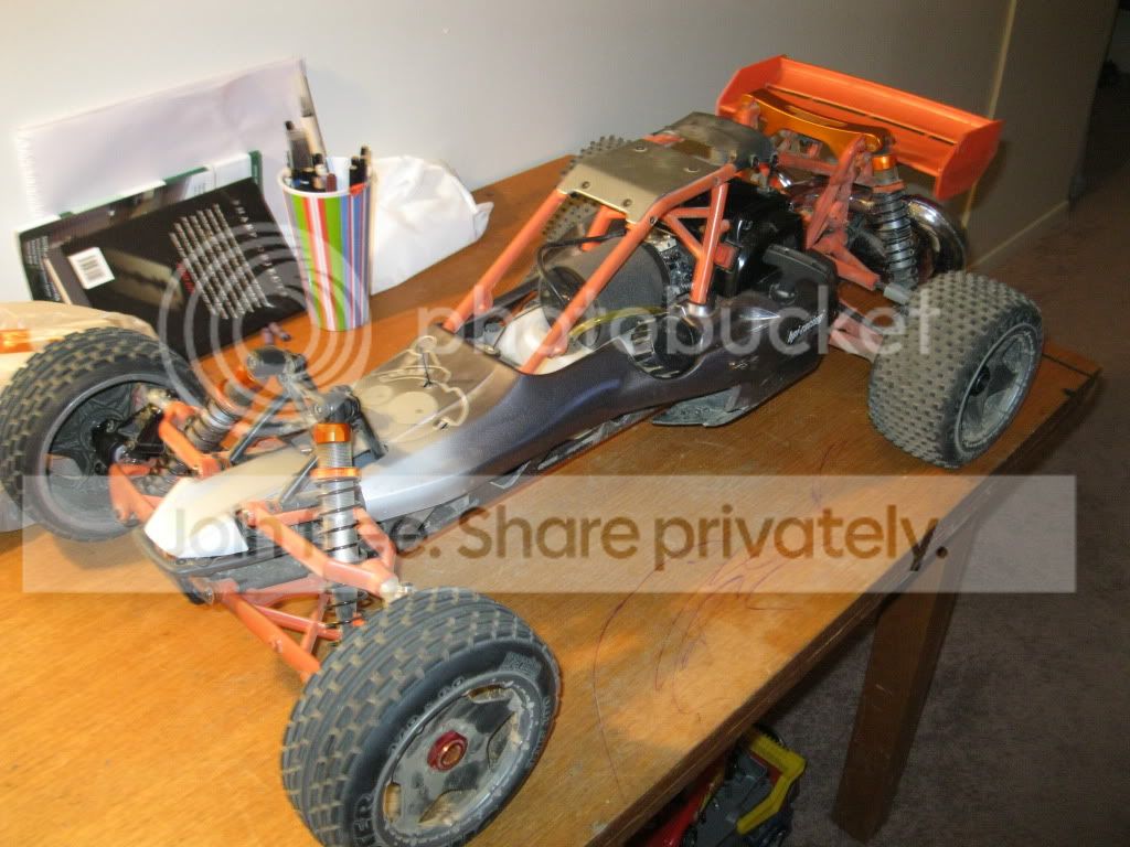

well here it is is all its glory sitting on carpet.

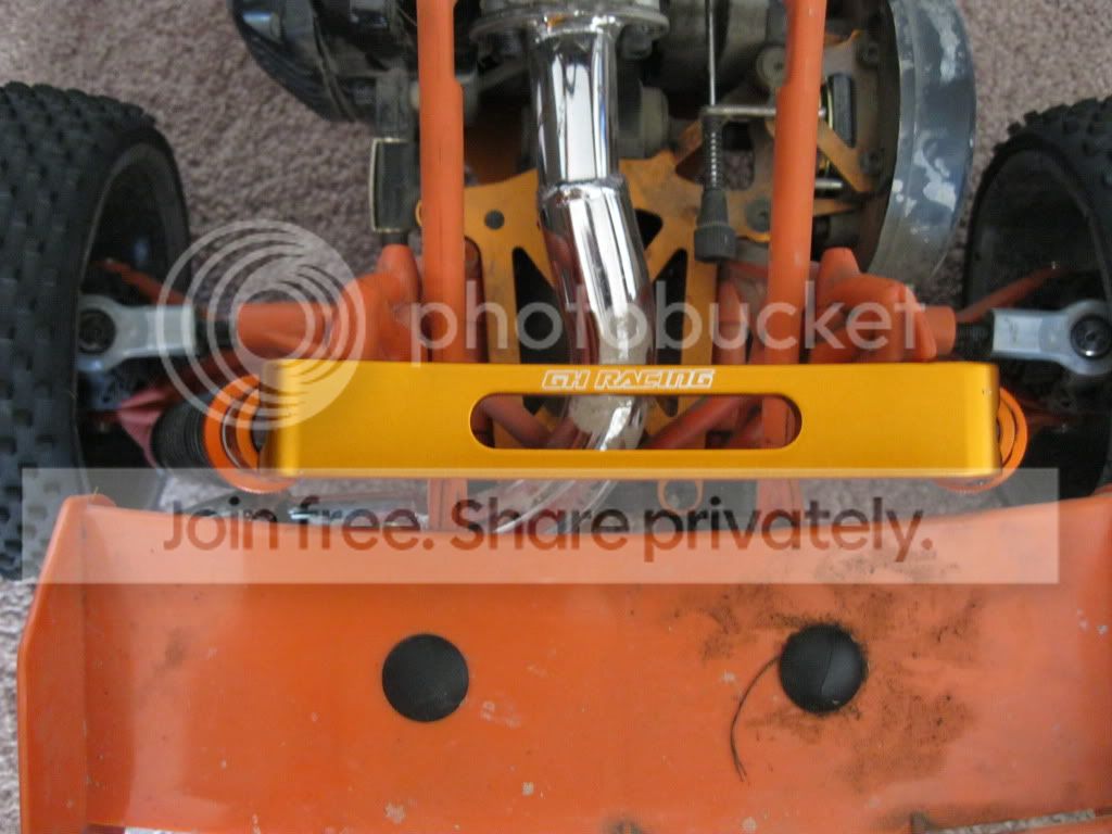

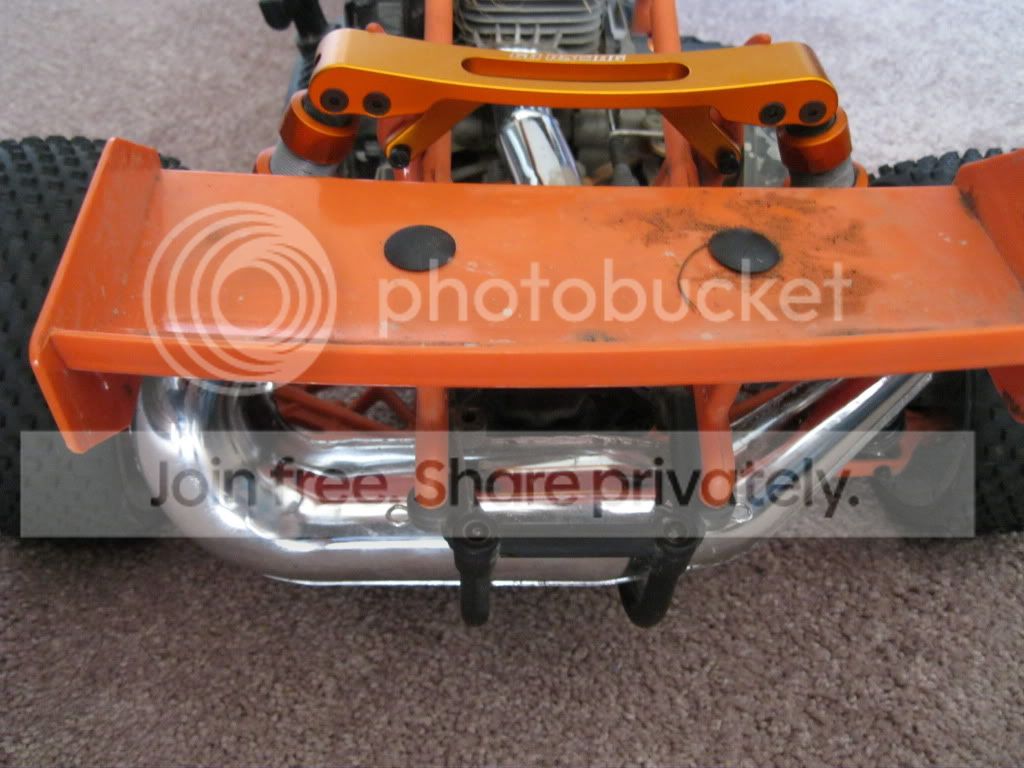

one tank through it and there have been a couple of issues. throttle servo hangs at half throttle, the rear tire foams have completely disintegrated so i installed proline blue moulded foams, the brass threaded piece in the rear shock towers pulled out and that was repaired by pushing them back in with some ca glue and installing the shock brace. its going to a track aug 14th to get beat on some more. ill update the failures as they happen.
EDIT: should be noted that the seller heat hobbies that i got it from refunded me 25 bucks for the foam and servo issue.

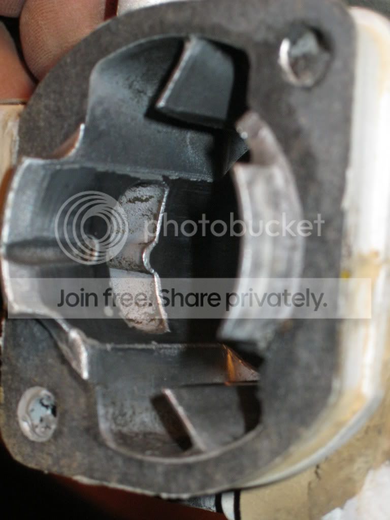

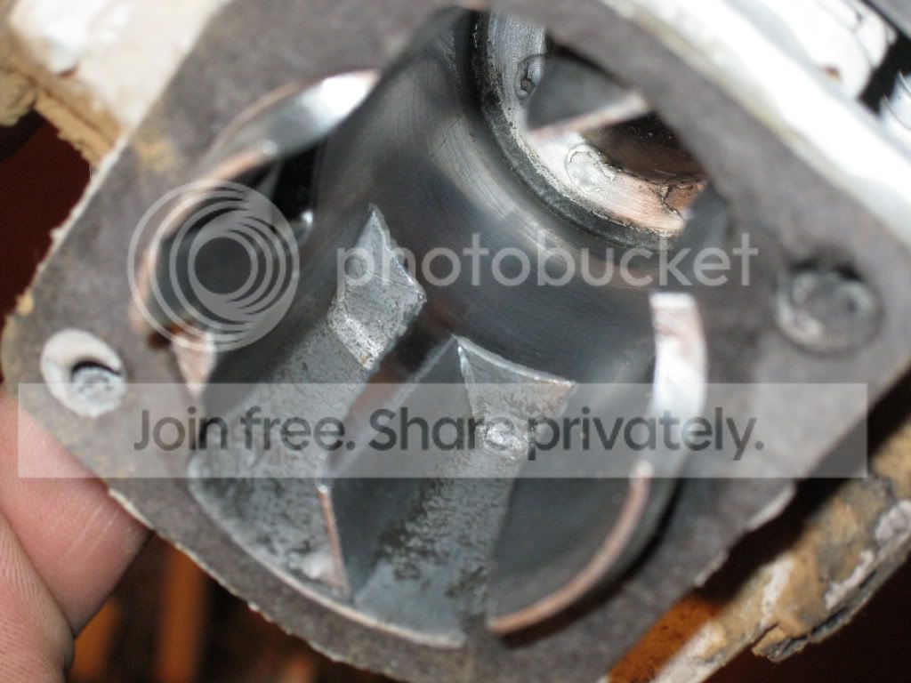

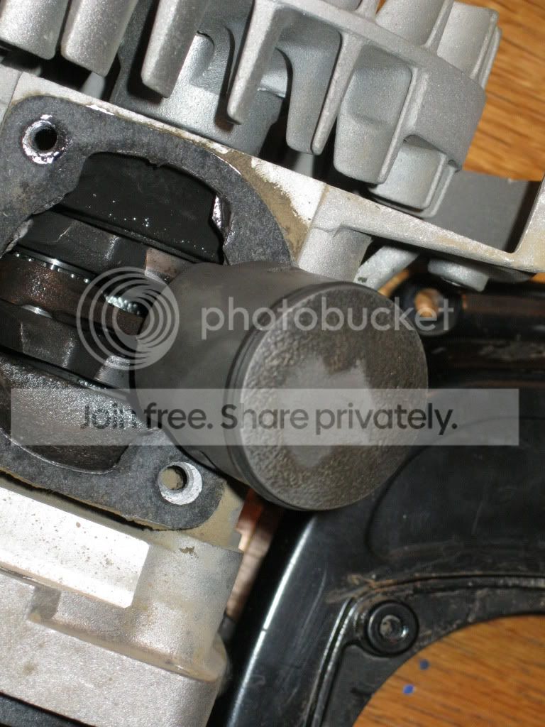

i wish i hgad vid of what it did to me today. it got tuned by a baja pro thats had them for years and was running awesome , then all of a sudden it starts getting boggy and dies. tried to restart it and a bunch of baja guys looked at it and the conclusion is the same. motor is toast . I'm gonna pull it tomorrow and have a look inside. then i blew the steering servo horn on the d8t shortly after that so i was marshalling the rest of the afternoon
that totally sucks. i wonder if its the head gasket. they say that its a very common occurrence with the 2-bolters.

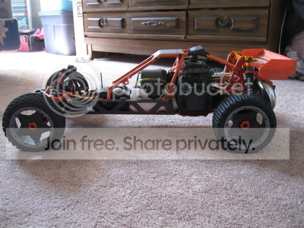

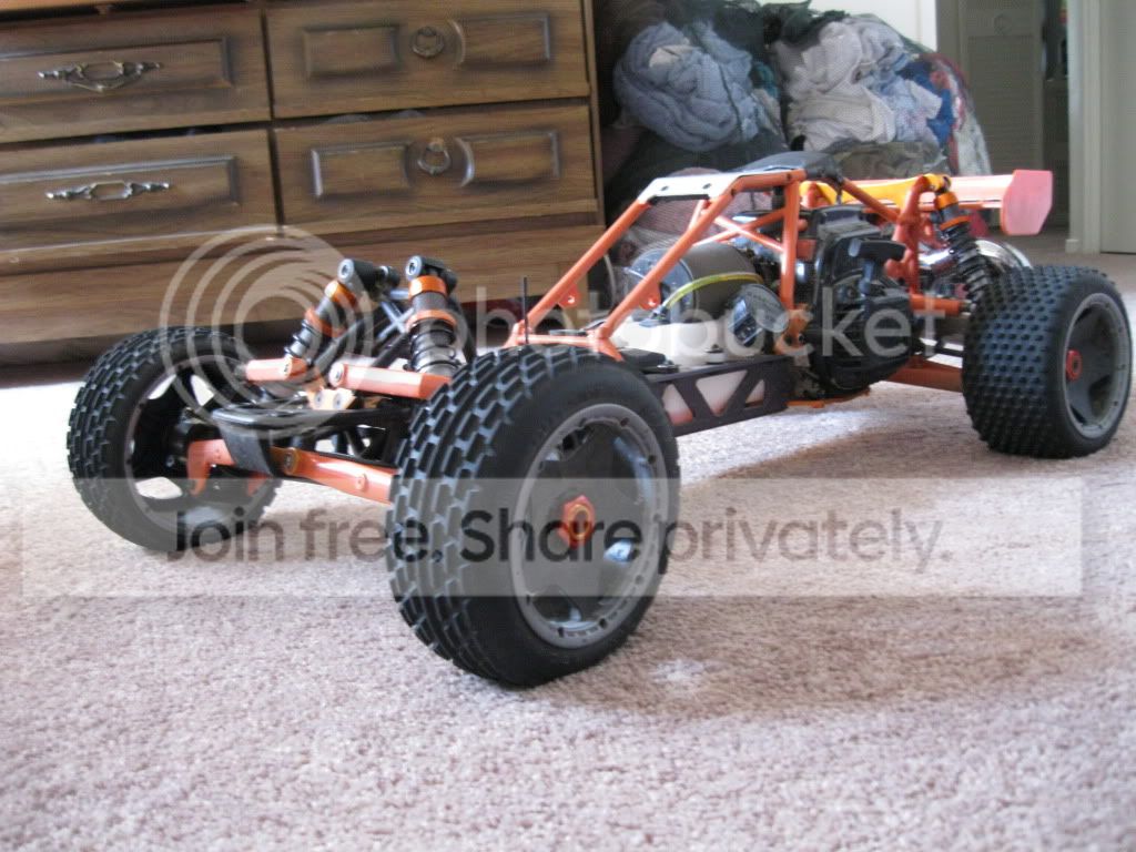

well another update the 26cc found a new home after i rescued it from madmikes shelf in his garage. the darksoul extenders i got from 88 are almost installed. the rears were easy the fronts not so much. i have to remove some material from the lower control arm to clear the screw and washer from the extender. i also have to shim the washer a bit so it doesnt side load the bearing ( i guess i found another spot the clone is not identical to hpi. all i have at home is sand paper to do this and after almost 40 mins of sanding on the first side i figured to heck with this, these will wait till tomorrow when i have air tools at work lol.
on a side note every thing just seems to line up better with the cy engine in it
looks great mickey. I bet those axle extenders will really make a difference for you. Cant wait to see a video bro
i never used the screw and washer on the fronts, just the e-clip and it holds fine.
the screw binds the carrier on the hpi version also so i didnt use it.
those e-clips are a pain tho, and not near as reliable as the screw. once its on its there till you want it out, it wont pop off during a race or bash session.

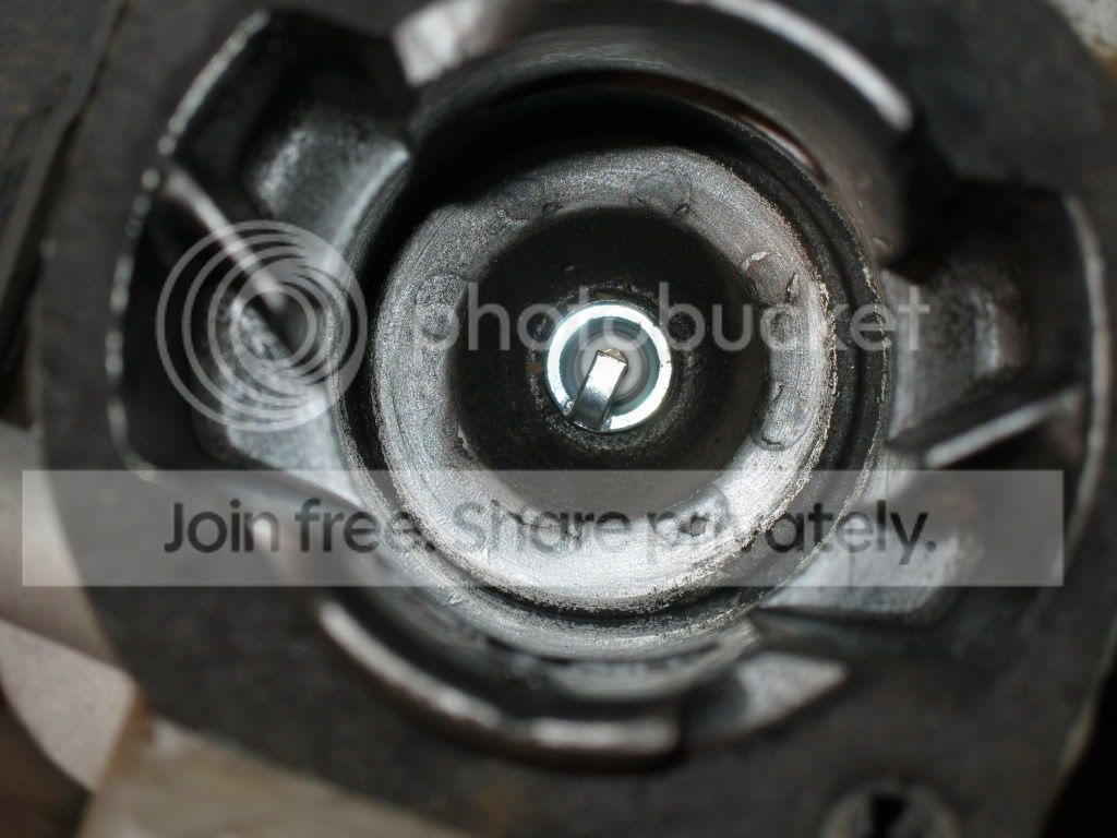

here is what i got from heat hobbies :
Thank you we have received the photos you sent us but this is way beyond are knowledge as reseller as we have absolutely no idea how the manufacturer build the cylinders on this baja.
