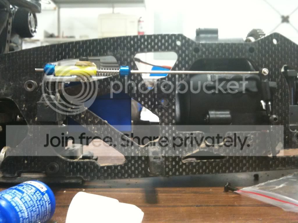

Here are some pictures of how bank did it so you get an idea of what your trying to achieve... Bear in mind you should only look at the BRAKE SETUP not the throttle........

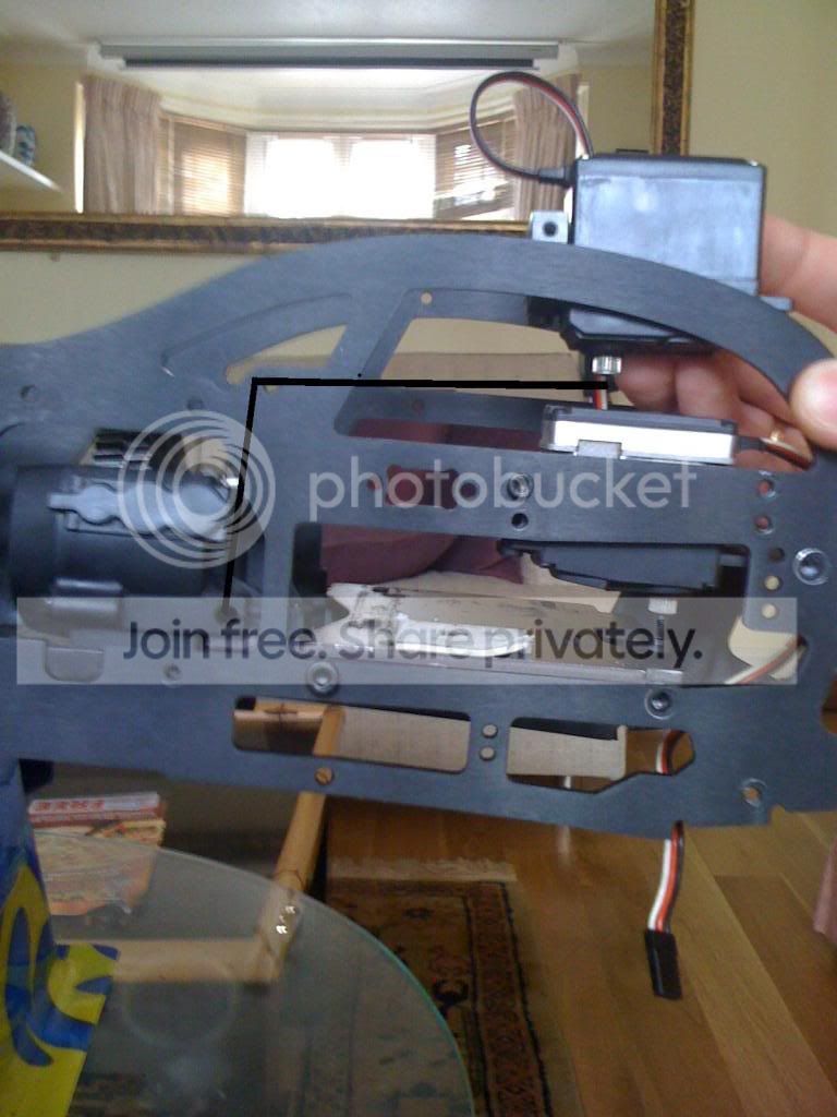

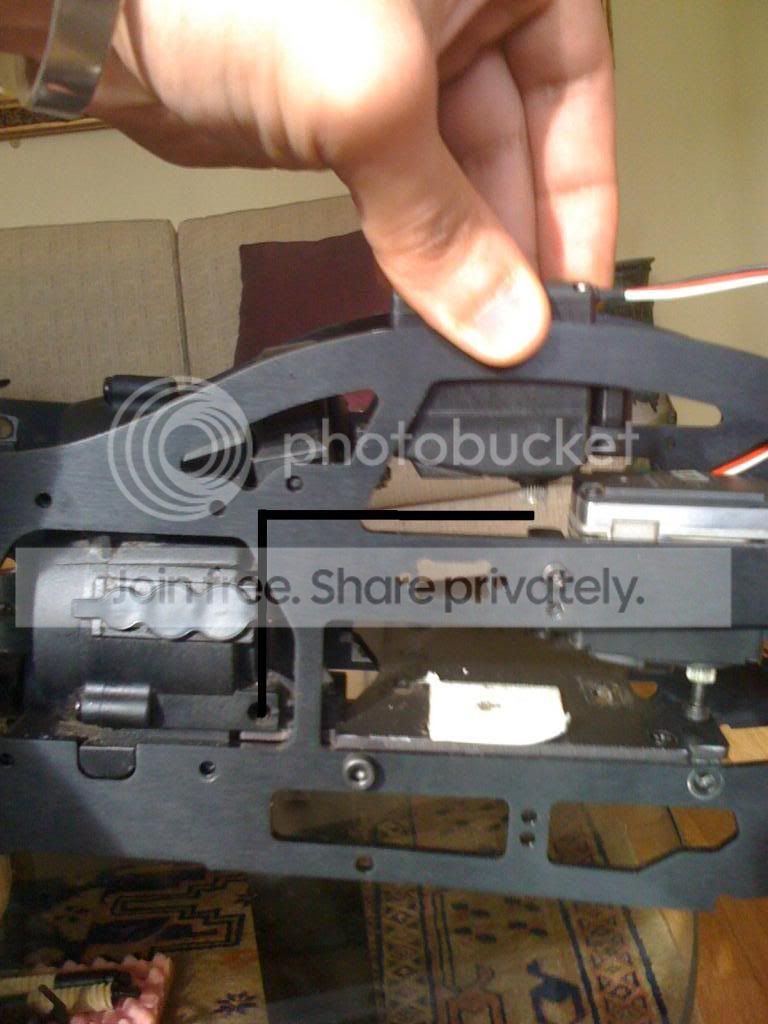

I wasn't exactly sure how i was going to go about doing this... Here are some pics relating to the DB-17...
I was originally thinking about mounting the second servo above my steering one like so:
But thought this would make it a little too vulnerable... So i think this is the best place. It doesn't interfere with the spur gear, so this is probably where it will be mounted... Any objections?
Anyway Help & Advice is needed to complete this so i can do a detailed write up of how it all goes together when my parts arrive....
