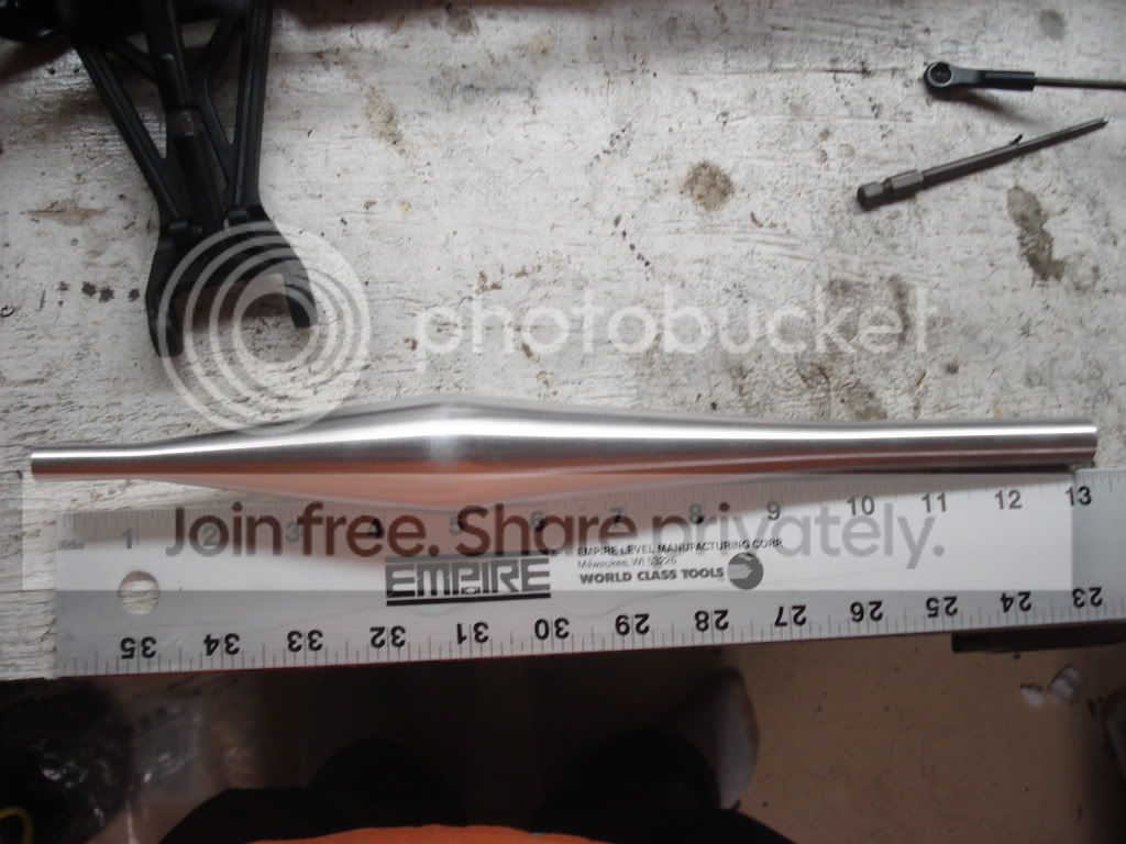

#1325 marine pipe is about 13 inches in legnth and will need to trimed to fit and a pressure fitting installed.

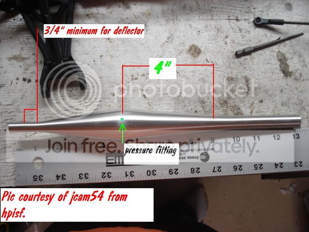

Here is the directions/tutorial pic that Robin mocked up for my little project
pretty straight forward there in the pic....
#1)
You will have to trim the pipe down to size (as to why these measurements...honestly I'm not sure but Robin from www.extremercmods.com came up with these numbers and I trust his experience with nitro motors, tuneing, and modding).
The stinger can be cut down to a minimum of 3/4" to fit a silicone deflecter to keep the oil/spent fuel off of your truck since this is a straight through design.
Next is the header side of the pipe. You need to trim 4" from the band (widest/fatest portion) of the pipe.

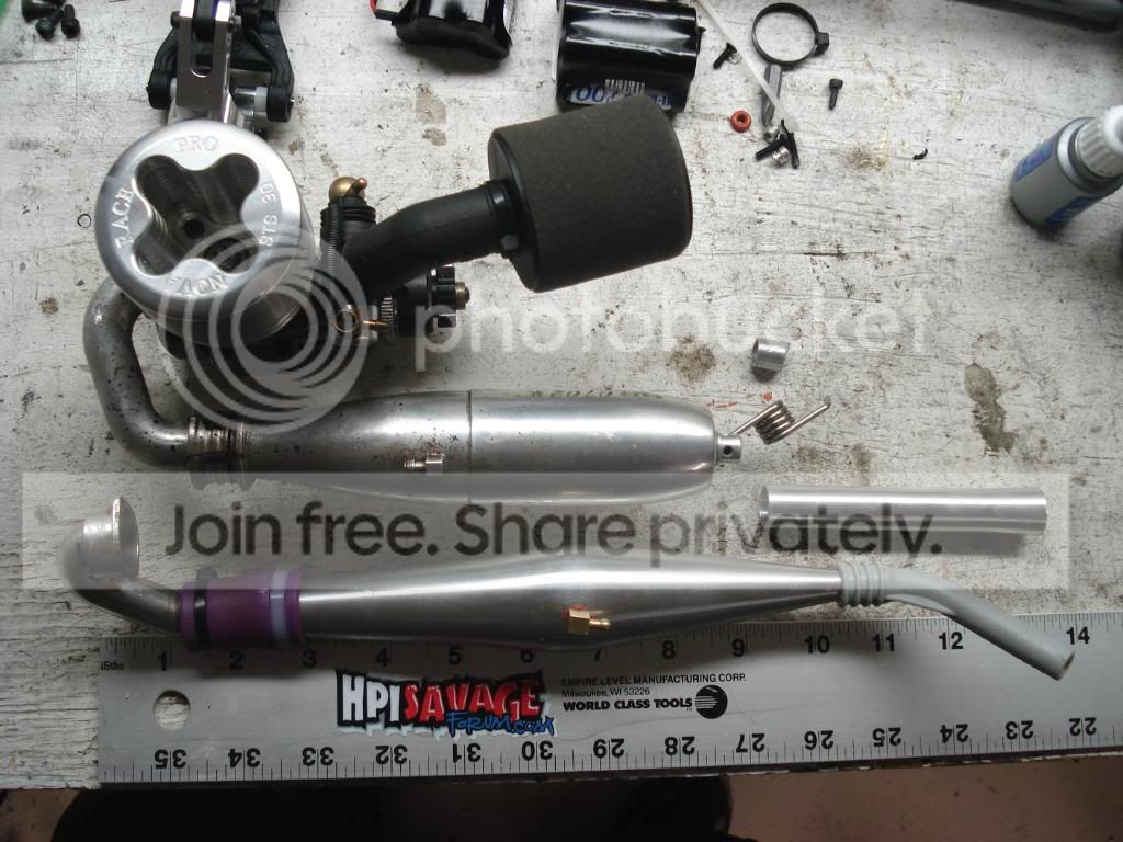

The pressure fitting must be placed at the band of the pipe...the fatest/widest portion of the pipe. Now you can use several different kinds of fittings to position the exhaust pressure line to the tank in the poper location for your application (stock savage fuel tank/midtank mod). I used a MacsPro 90 degree fitting like this one http://www3.towerhobbies.com/cgi-bin/wti0001p?&I=LXZ661&P=7
The 90 degree bend will help protect your line from getting riped off and it is a stronger fitting. I sealed up the fitting with Permatex Copper RTV, but any good high heat RTV will work or if you want to go a step further you can use "jb weld" you must make sure you use the HIGH TEMP jb weld, as some of the jb weld products only hold up to @ 190f...read your labels! No point to have a sweet pipe and blow your motor or chase that tune because of a tank pressure issue!
Helpfull install tip.....

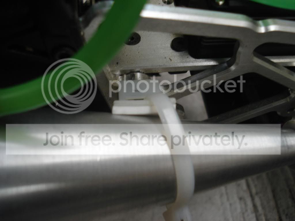

After drilling the hole for the fitting I found it easy to use a large zip tie with a clump of putty/clay (in my case I used "clay magic" bar for automotive detailing--it is tacky and holds the fitting well) I pressed the fitting into the clay/putty and then pressed it onto the boxed end of the zip tie. I was then able to snake it into the pipe and into place.
#3)

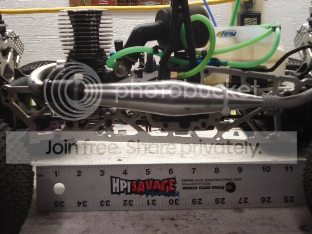

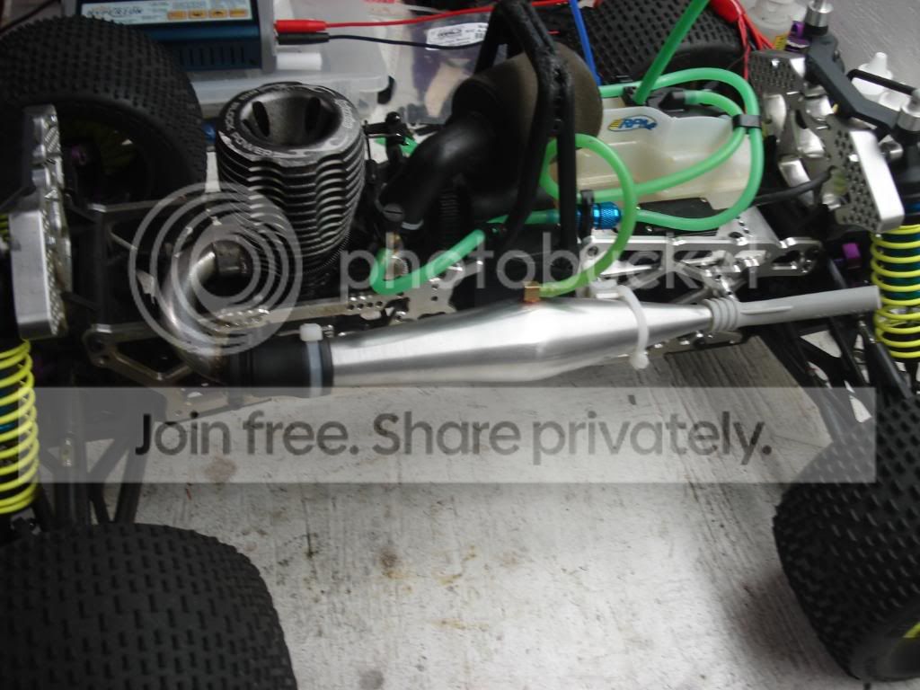

You can use the stock HPI Savage header with this pipe and the silicone coupler.
Here is the best part...you can tune the pipe....by sliding the coupler farther onto the pipe you can change the characteristics of the pipe (torque/mid/top end). Just tweak it down with zip ties in the location for the tune you are looking for.

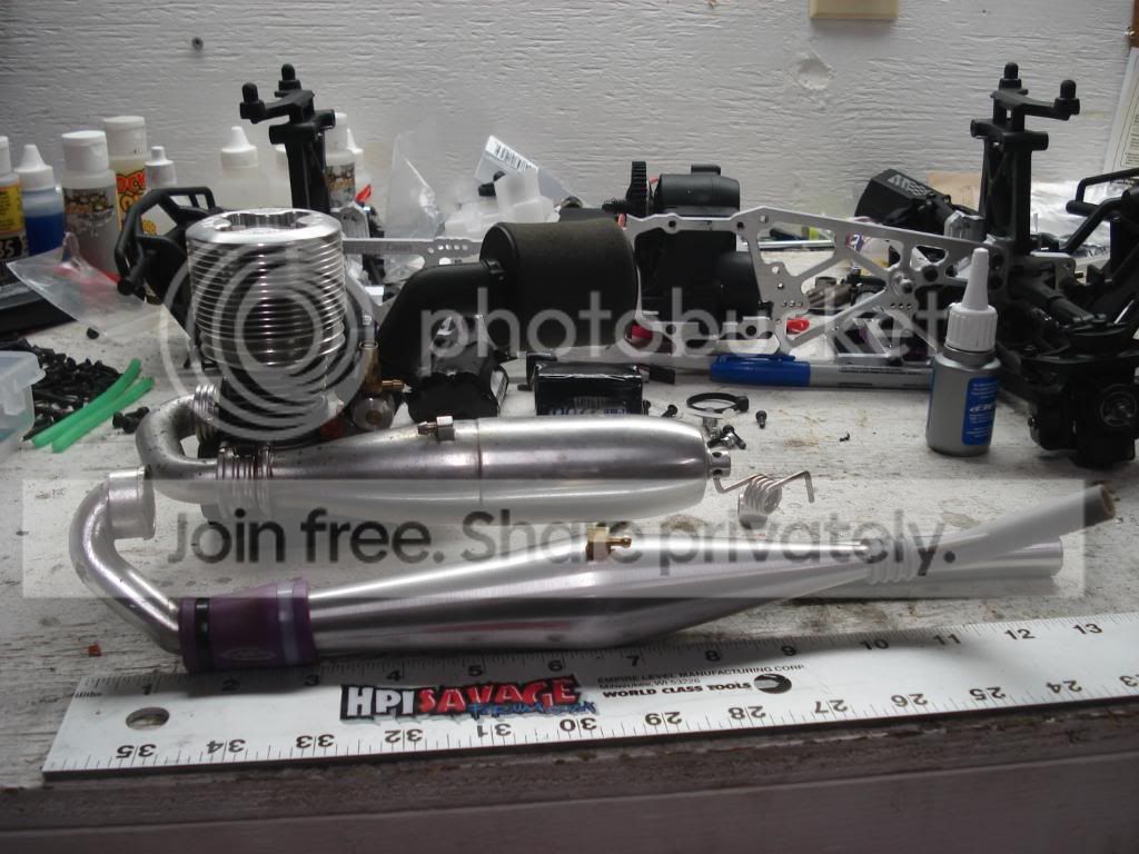

Here is some finished pics compareing the STS 0702 tuned pipe and the MacsPro Marine #1325

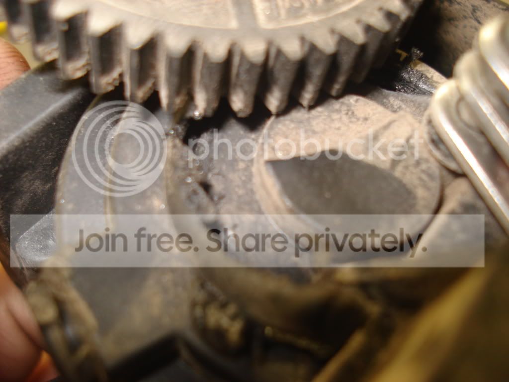

here is one of the first runs with the rb mod sts d30m, Now somethings wrong with the trans...tried to tune the shift and no go it is stuck in one of the gears the whole time..played with that set screw for about a solid hour, I'm gonna tear it down and see whats up might need a rebuild of the trans.

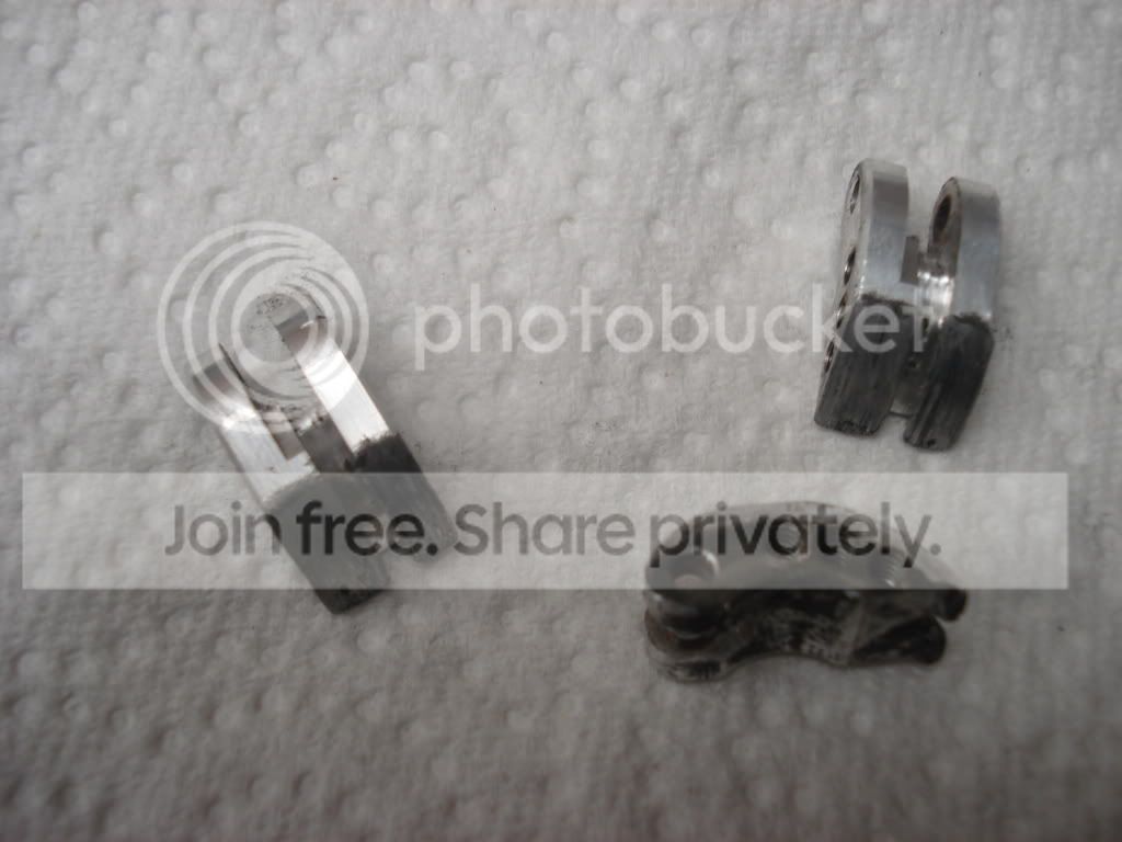

Btw in the vid I was running 20/47 gearing on the sts and 18/47 on the k5.9, and a trans that would not shift (brake cam was ripped out of place), not to mention my melted bran new nova clutch shoes.
Nova clutch shoes
Damage to trans
Nova clutch shoes
Damage to trans
how that all happen bro? i like your thinkin' take out the brakes to make it go faster.... kinda how the choppers (bikes) were born in the 60's; guys took off the front brakes, fenders & other "non-essentials" cuz it was all about going faster....lol
Can't see how that would affect performance, lol. That's some pretty bad carnage, can't wait to see it rip once you have it all fixed up bud.
Considering the rpm range of the sts's I would run a 17/47 combo, it won't be near as hard on the clutches as the 20/47 is.
