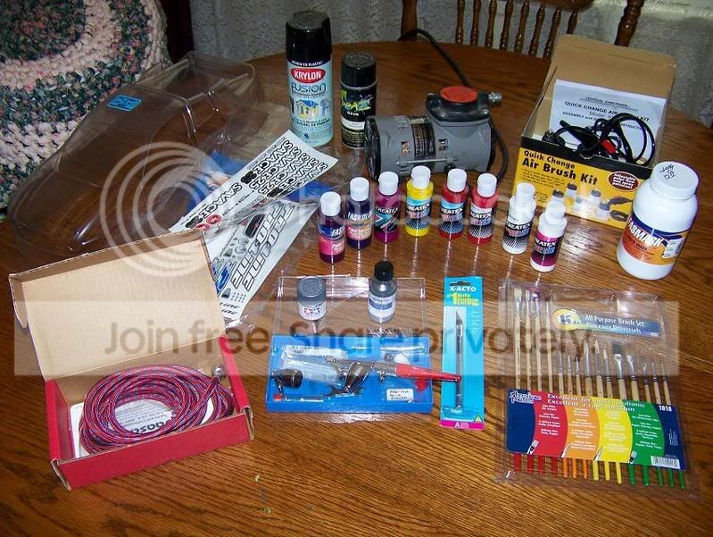

OK...day one is pretty much just gathering materials/supplies, and then prepping and masking the body...
here's the gear I'll be using (unless I find a spare $70-ish for a new airbrush 🙂 )

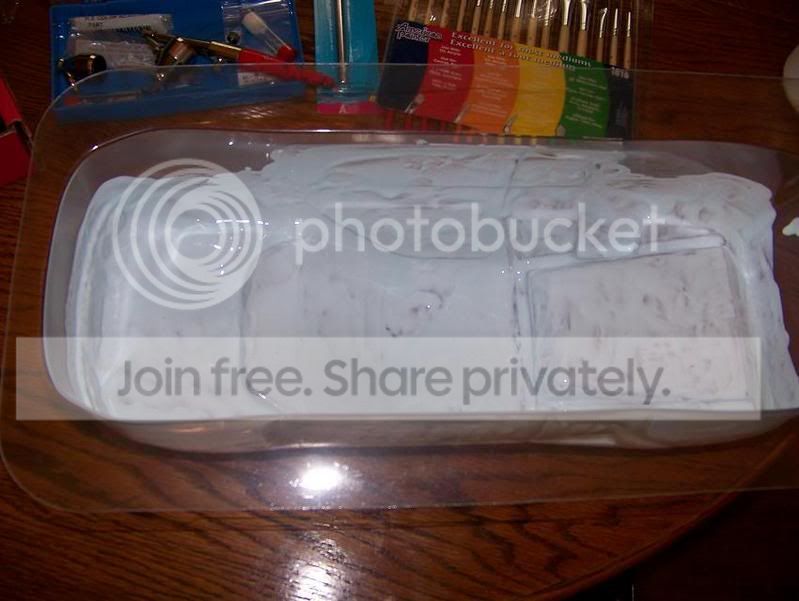

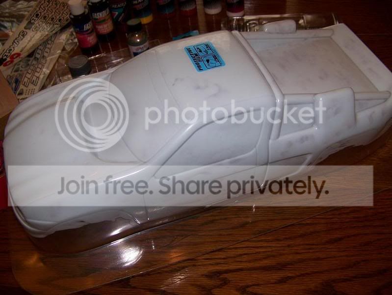

and here's the body, prepped and drenched in liquid masking (a few thinnish spots I may need to retouch):
so tomorrow I may get to start trimming the details in the masking as long as the masking dries by then...LOL

ok...here's a helpful hint (at least it would have been helpful to me...LOL!!) when using the liquid masking stuff, use many thin layers to build it up...I used a method I read online, where the guy poured the stuff into the body, and just smeared it all around with his fingers 'til everything was coated...it works, but while drying, any excess liquid pools in the bottom (roof and hood) of the body, which takes FOREVER to dry completely...I posted pics on day one, when I applied the masking, and as of today, there are still a few spots on the hood and roof which are opaque (not dry yet)...
so needless to say, no paint yet...never fear though...in the next day or 2 (I hope) it will be dry, and I can start cutting out for the details, and applying some paint...

I hd a problem with getting the liquid mask on too thick too, when cutting it it pulled up both sides on me, just pulls up too esy when too thick. I had a new exacto blade on it too and had a hard time getting it to cut through it smoothly, i guess thats why it pulled up, also could have been because I had very few coats on it too, thanks for the tip on many thin coats.
