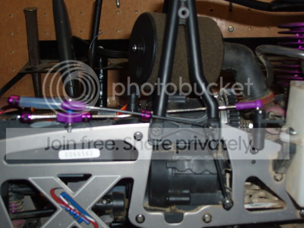

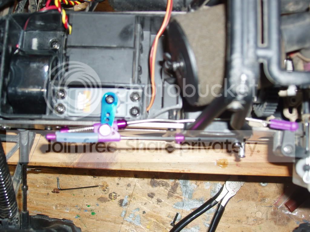

here are a couple pics
take about 1/4" out of your Fuel tubing on the brake side. You also may want to put kind of a z bend in the Rod going to the brakes but make the angles as low of degree as possable. This will help keep them from bending. You want the rod to slide threw the Purple slider fairly easily. Give this a try let us know back.
Or better yet flip the throttle one to the top and the brake one to the bottom this will give you better straight shots.
Then take 1/4" out of the fuel tube.
yea i was messin around with it and i flipped the throttle onto the top and brake on the bottom. and i found my problem. it was that i tightend the screw holding the sliders on to the servo horn too tight so i loosened it and now everything is working like a charm!!!
