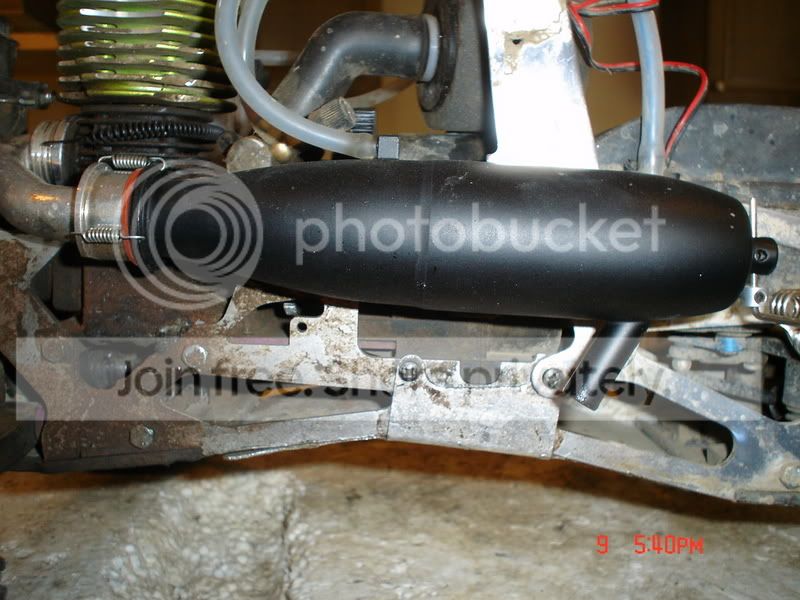

So, ive got a "Ths",Ribbed Hpi and my STS 07 is almost here...because I cant wait I'm goin to buy another pipe this morning .I'm sick of tearing gromets..(and the noise) outa the ribbed and the THS is all dinged up..so I was lookin at the Ofna Jammin #1,2,3 $69,$89,$109..(local)I'm sure ebay would be much cheaper ..but I want a pipe today:dunno:
the guy at the shop seems to think all 3 are made for >.21-.32?..
so ..I'm gonna pick up the #2 and see what it does ..If anybody has any input on these pipes or likes / dislikes let me know ...I'm sure theres only a small difference between them and I prob cant even tell..but after hearing the STS tuned pipes make a huge difference (for the .30) I figured it might bring the Axial 28 alive ?

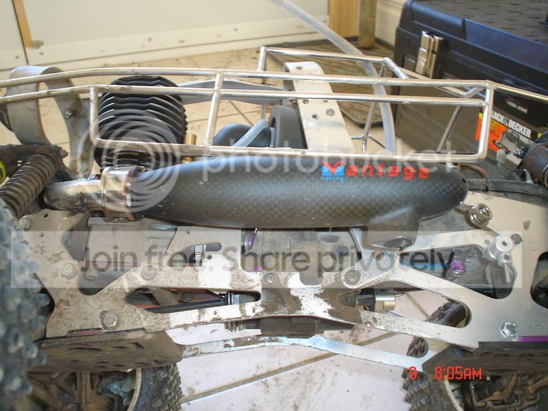

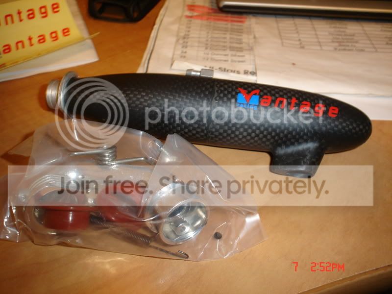

so cancel that ..I went ..bought it ..tried to install it ..no go.header didnt fit/ pipe had to run upside down..just a bad idea..went to another shop(5 shops within 20mins of each other)got this sucker ..Vantage st180c-03 .21-.28..headers good mounting system kinda sucks..to bad in puttin it on the sts.30
till I get the other 1..might swap it half way ..see how it goes..
Holy!!!!!!! crapola!! insane..I don't know much...but i do know that pipe was worth every $$$ ($114 cad to be exact) man o man ..I have a bita trouble tunein my trucks..gettin them to run crisp under 240f ..
I started the STS ..warmed it up for a min (sounds awsome ..kinda like a lumpy cam in a 454) then cracked her open ..right off the bat ..screamed !!! did a few runs pulled it in for a temp check ...198F!!! Ive never got that much snap and crispy-ness outa any motor yet under 200F ..i was pretty pumped ..so I leaned it out 1/16th at a time ..gotter up to 230F couldnt keep the front end down at all!! this trucks got the 2 speed and the 16/52 combo..perfect for the power this motor was producing ..any speed crack it ..wheelie ..1st-2nd wheelie ..its was just silly..then I fired up the axial ..blah ..felt like a run down .21 ..I didnt feel like puttin the pipe on it ..so I left ..but once the sts pipe come the Axial will get the Vantage ...and hopefully bring it back to life??

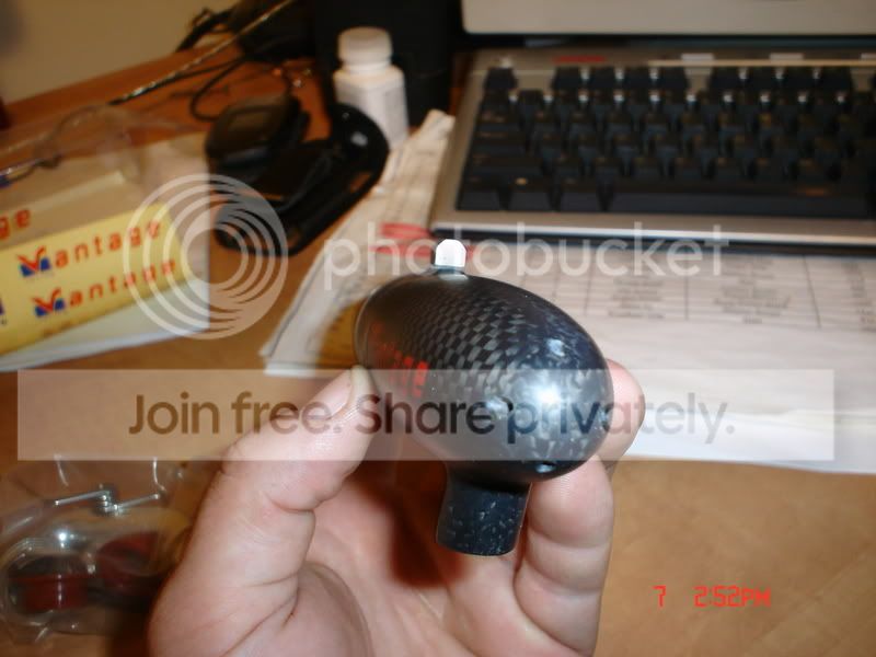

from the pics it looks shorter than most pipes if so that would explain the power, from what i understand the jp pipes work jp1 is for low end power jp2 is for mid range power and jp3 is supposed to be a combination of the 2 but from what i hear you have to really open up the motor to get the power out it.
It doesnt seem too much shorter..but the real problem is the carbon fibre!!.

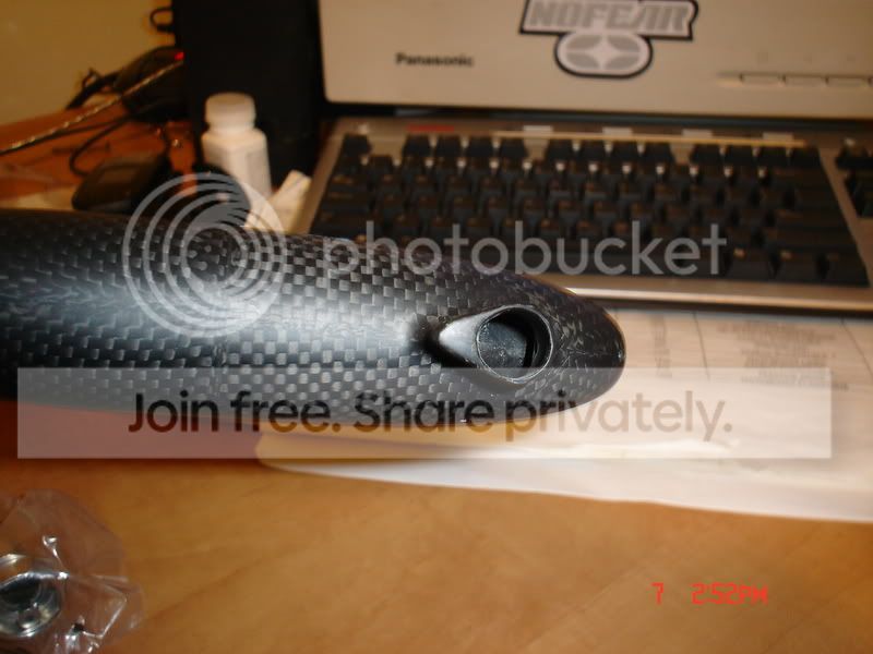

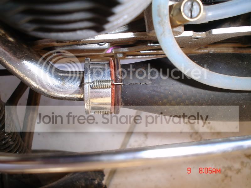

Only had 2 tanks of gas through it and I think it may be melting ..awsome pipe ..don't think its make for temps 250F and up?,I check with heat gun aprox 2" away ..while my motor 210F its 310-320ish ..and it smokes right around where the pipe connects ..
so,what an ordeal..emailed Vantage ..couldnt wait..went back to the Hobbie shop..guy was ready to give me a new 1 ..but..he didnt have any left.so I had to drive to they're other store..only 15mins away..get there they give me a new 1..I was gonna just take and leave ....then I decided to test it ..slapped it on went out to the parkin lot and fired it up!!

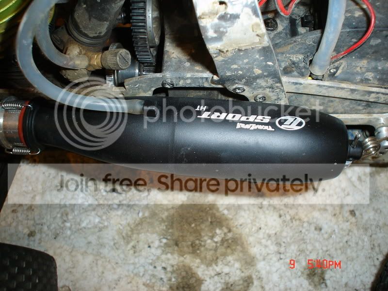

they tried to tell me I was runnin my motor too hot at the 2nd shop ...I said "O ya ?" "c'mon out and see for your self"..so I fire up thee ol Axial..(starts 1st pull ..and runs awsome the whole time) and warm it up ..getter up to Temp(190F-ish)..and then run it hard up and down the lot..6-7 times..from full tank - 1/4 tank..doesnt go past 220F !! which is pretty impressive for a 98F day and hard pounding ..so at 1/4 we take a peak at the new pipe and sure enough !!! same thing..smokein and cracked!,the look on the shop owners face was priceless ..then all of a sudden its a "manufactor defect"(chinese accent)..so I get this team LOSI pipe as a loaner till they sort it out with VANTAGE ..I put this pipe on and I have to say it was pretty good !! didnt touch my needles took er out again and with 1/4 tank to empty it ran 10f cooler?? cant figure that 1 out ..but didnt care took my new pipe and split..
