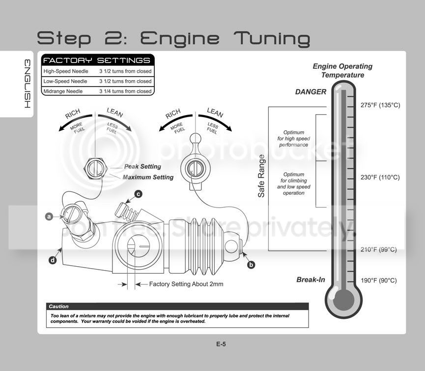

well i don't know what to set it back to its a nitro star .21 (3.5) engine with a slide carb
it should say in your manual. if not i think hpi's stock settings are all needles flush... but i am not sure
come to Lakewood(by Tacoma ) I will tune it fro yea .. other then that seat needles to flush on the carb body
heres a page of the manual....
its for a nitro star 21 bb

your needles
lsn start from closed = 3 turns
hsn start from closed = 4.5
After break in you can turn the hsn to 2.5 to 3 turns ( from closed )
and the lsn 2.5 to 3 as well. NEVER GO LESS THAN 2 ON LSn AND 2.5 ON HSP.
The lsn is gonna control the bottom end torque. I never set mine to do wheelies cuz I want to be able to steer the dam thing. about 2.75 on the lsn is pretty good. Once you get the lsn where you want it ( truck running somewhat smooth ) DO NOT TOUCH IT!!! Most of your adjustments will be made with the hsn.
