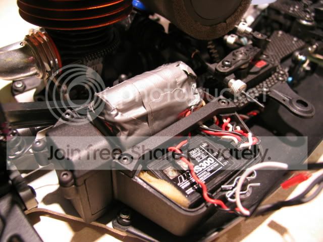

build ur own pack out of full size rechargable AA, can get them up to 2500 mah or even higher now prolly
i made a 2300 pack lasts a long time
Is there a write up on how to make your own and the charging recommendations?
jsut gotta solder the 5 cells in a series and then solder on a lead can charge them from 1 amp and down anything hgiher than an amp will damage the cells since they are only AA
not wrapped in duct tape anymore though it carries a tiny amount of electricity now its wrapped in heat shrink
don't have any pics of what it looks like under the tape though sorry i just used battery bars and soldered them to each battery in a series but be careful too much heat and you will fry the cell
