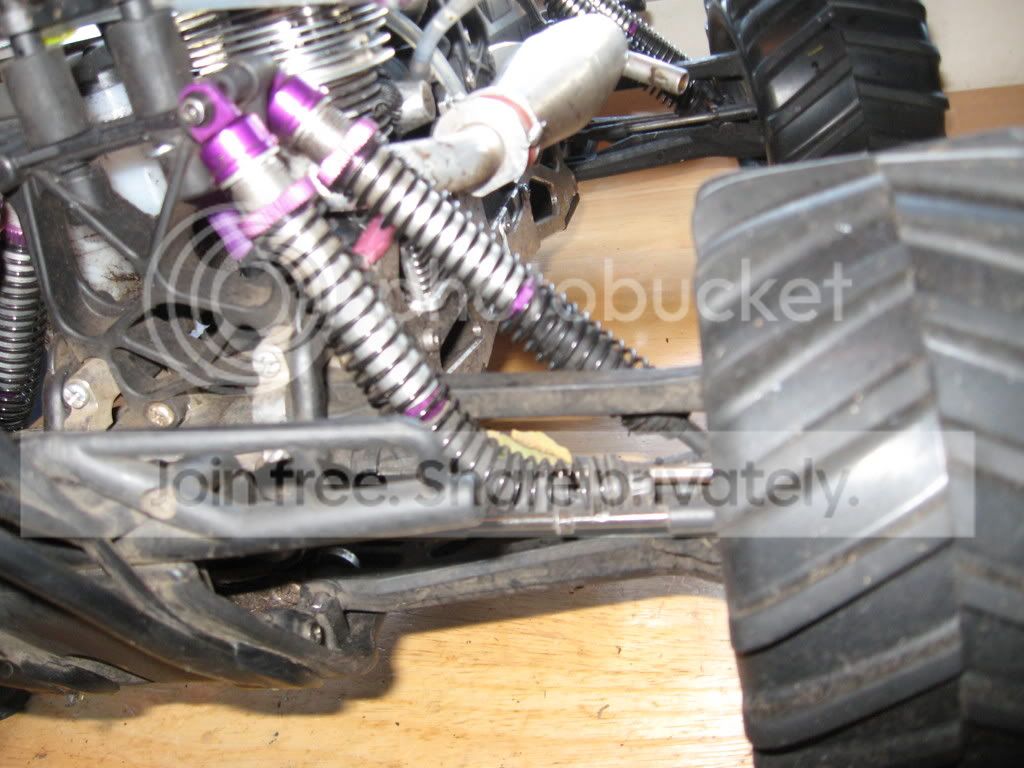

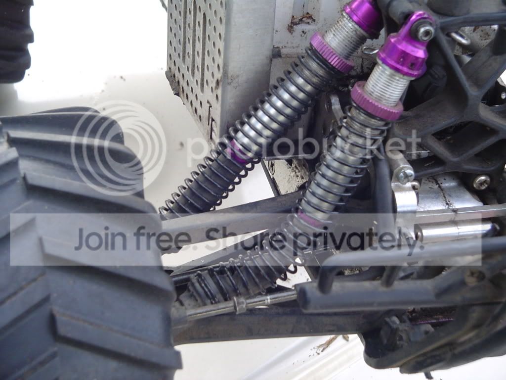

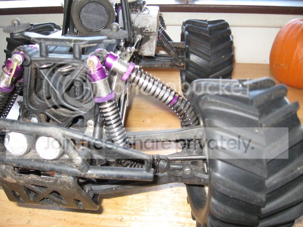

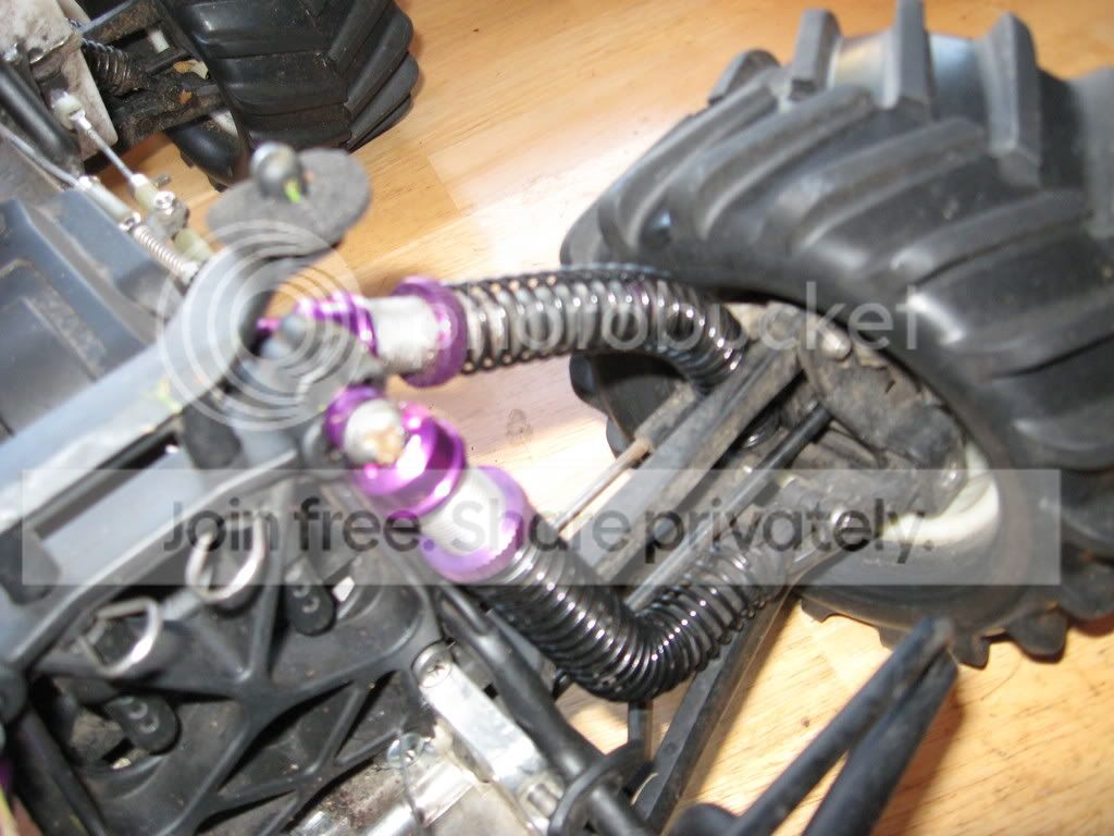

Yes today and 2 tanks this is what happened. So I will be replacing these shafts. And putting the other pistons back in.. Hope you like my damage.
Nice carnage SJ! love the one with the shocks going north and south. I believe a few shocks are worth bad*** baja, hope he wasn't whining about his shocks afterall. I'm sure he wasn't. I'd be grinning from ear ta ear.

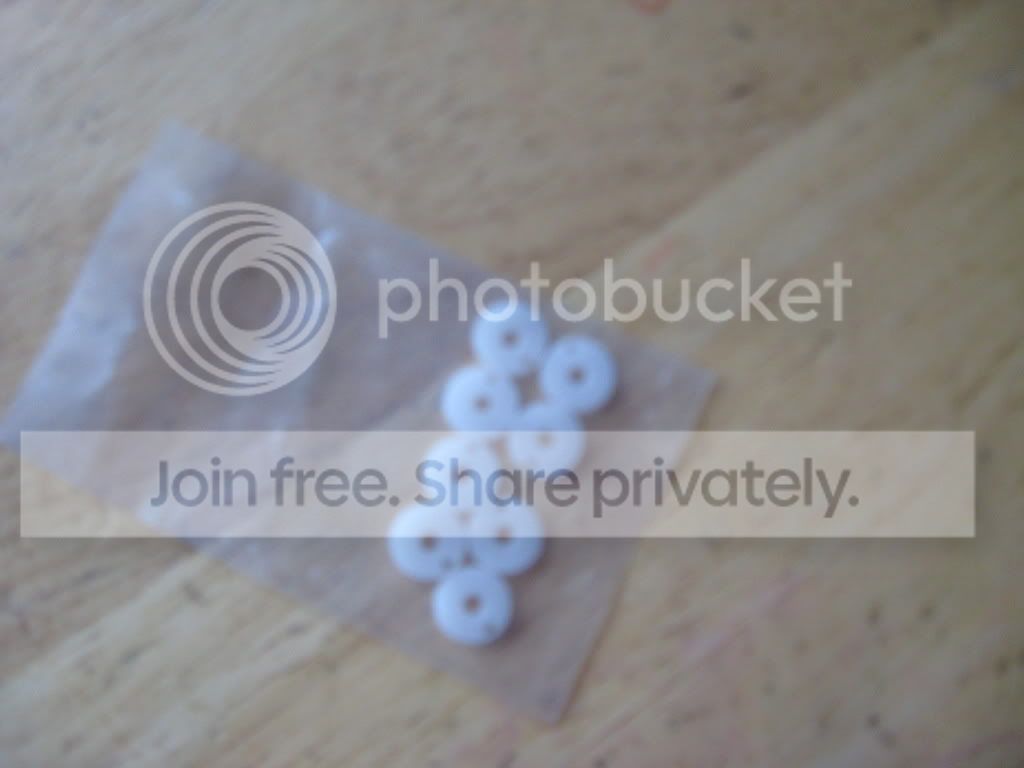

SJ great review, they were my first hop-up, I swear by them. Try installing the bladders(White disks) from the stock shocks. I find they work alot better. I'm a year into this set, I bash pretty hard and I've only broken 3 shafts. All in the front. Peace.
