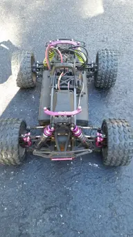

After all those tires I mentioned before I have stuck with 2.8 dirt hawgs on chrome jato wheels. It handles great (with new hpi aluminum shocks) & looks awesome. I installed integy cvd's in front and broke one 3-4 packs later. NOT HAPPY. (Decent impact straight to the wheel) but since I'm a suckered for pain, I just ordered the 5700kv motor from hpi. It's going to be outrageous! Waiting for hpi to get their poop together so I can get my hd cups that I ordered months ago and to stock up on slipper clutches. Next I'm going to start playing with pinions. 20160924_161622.webp
