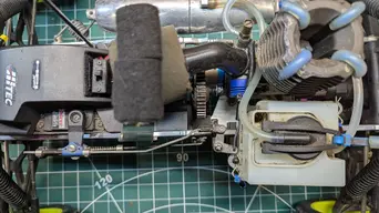

Note the way most people have their brake lever:
The orange line shows where the brake lever should be when the brakes start being applied - to ensure maximum mechanical advantage.

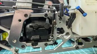

Sorry to change it up , looks like you guys got it figgered , horatio what side plates are those ?
FLM extended, LCG TVP's.
Essentially the chassis plates are extended at the rear, moving the weight forward and more centrally, giving better steering response and handling.
Less roll overs and less unwanted wheelies. 👍👌
