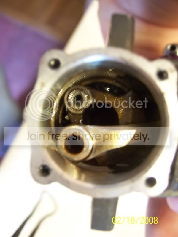

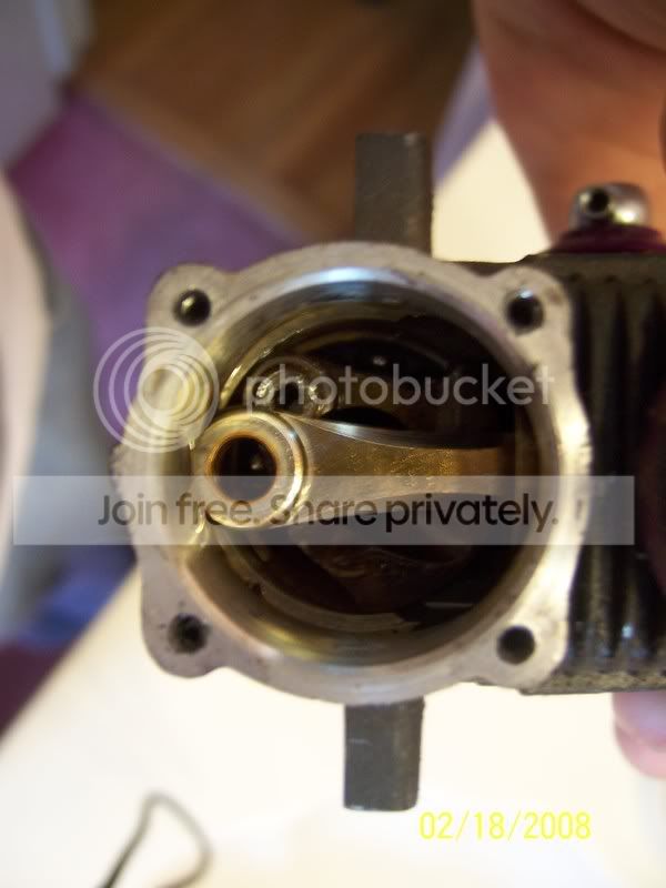

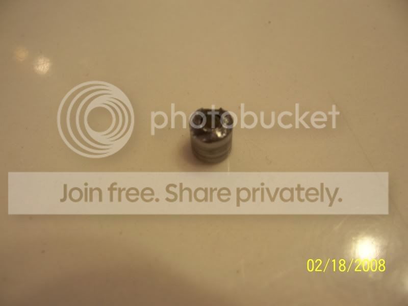

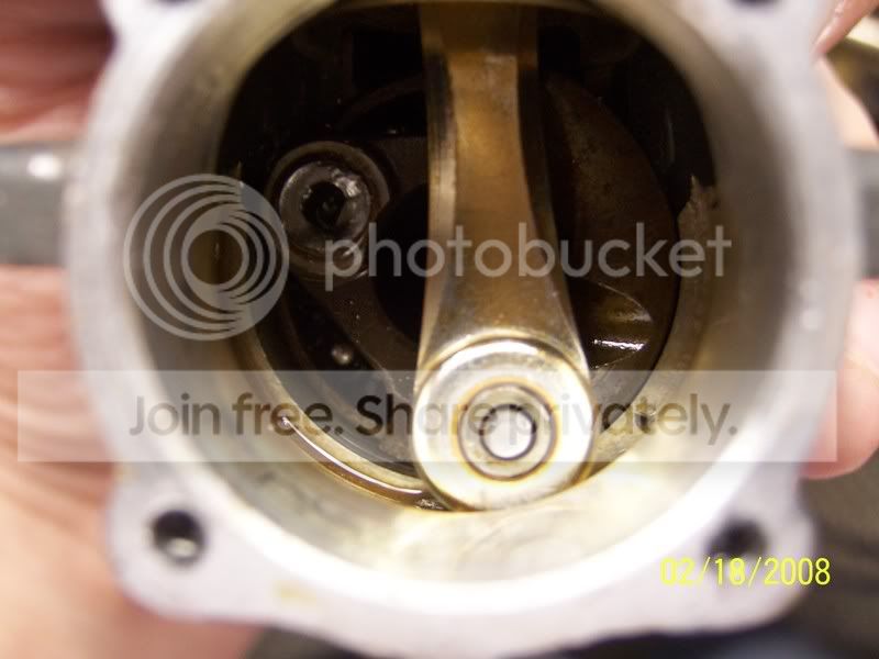

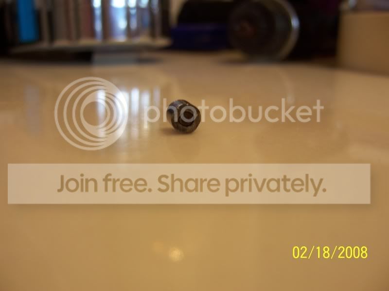

The truck has won 4 races so far and was running good until the carb came loose at the last race, got slammed into and thinking that might have caused it to come loose. I got a new carb for it and started to tune it back to where it was before. At about tank #2 with the new carb it was running in the 220's and was making awesome power. Anyways I nailed the throttle, did a wheelie and it just cut off and at that point I knew something went wrong. I tried to restart the motor, nothing happened so I tore the motor down. When I removed the backplate this is what I see....
At this point the motor had 6 1/2 gallons on it......all was running stong and perfect until this happened.

The truck gets ran almost every day unless its raining or broke and I would say it gets ran hard. I don't think I will be racing it at the oval anymore.....the oval track has claimed 2 motors now each at 6 gallons.
I think thats about a gallon every 2 weeks....
