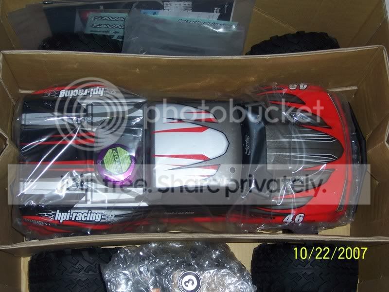

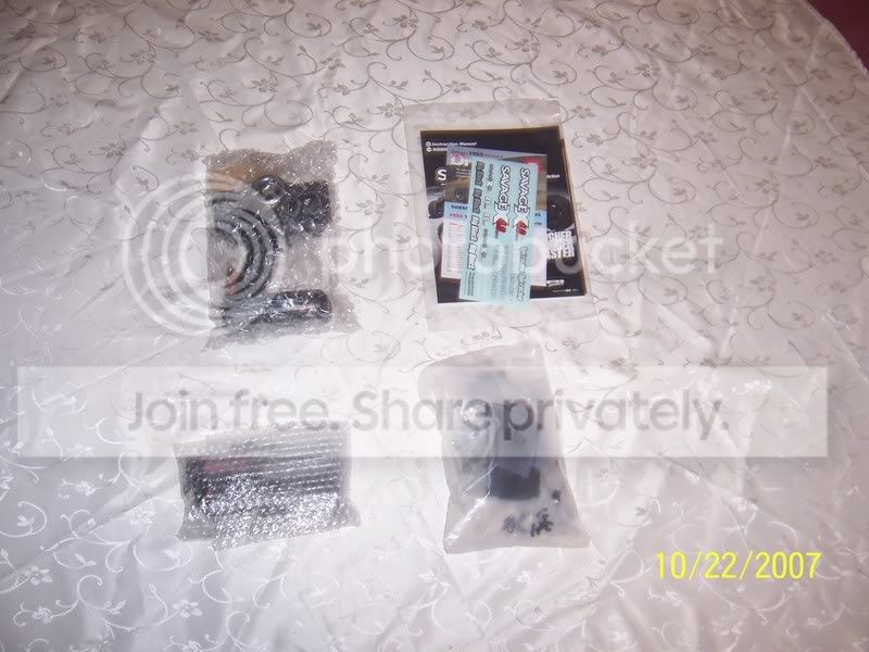

Here is a list of everything included in the box:
1: HPI Savage X 4.6
2: Roto Start 2
3: Transmitter
4: Manual and stickers
5: Inner cone for the exaust to make it quieter
6: 2, 2.5, and 3mm allen keys
7: Tie Rod adjust tool
8: Roll cage that protects the engine head
9: 14mm hex's
10: Extra body clips, radio box clips
11: Tall body post, servo horns, various other linkage items

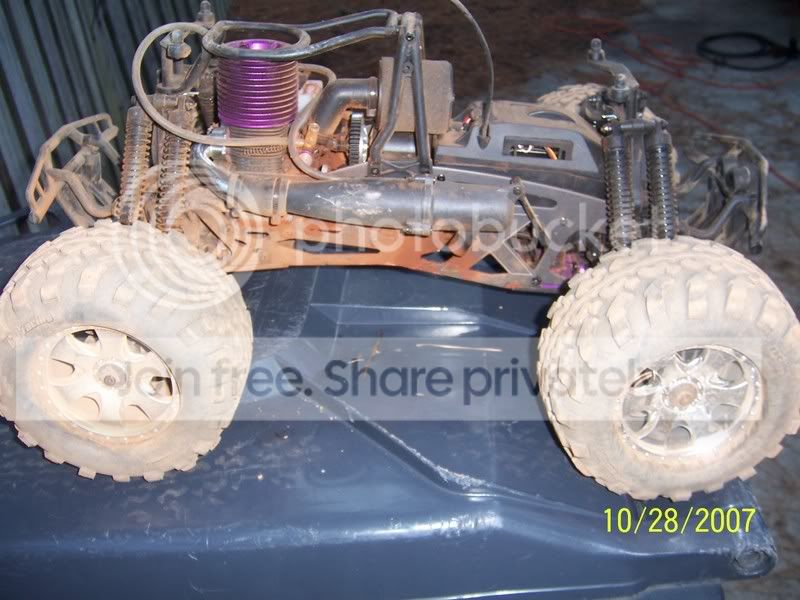

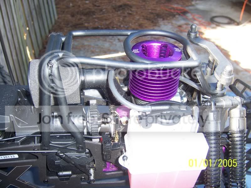

Here is a picture with the extra spring added.
Picture with roll cage installed.

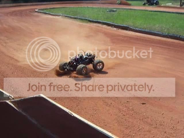

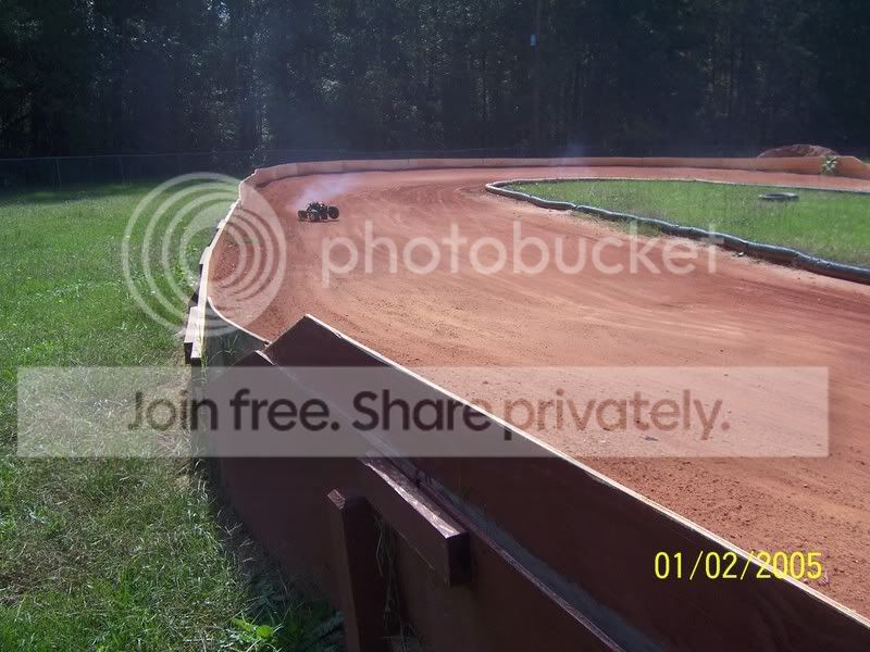

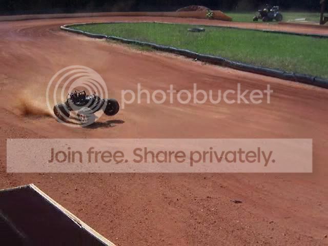

Track Time: After break-in of the motor I went to the local track and ran it on the dirt oval. I started out by tuning the motor out in the field in within two tanks the steering went out and upon inspection the steering servo stripped a gear. I just happened to have another truck and I took the steering servo out of it and put in and it went back to tuning. The truck came with 1 shock spacer on each shock and for bashing around that would be good but for an oval track it made it too stiff and was top heavy. After running a tank with the shock spacers in I then removed all shock spacers then ran the truck again, with much better results. The track was very dry today and made it very loose, almost like driving on ice. I myself do not have a temp gun but a friend of mine does and while we was at the track we tested the temp of the motor after each tank and a few times during each tank with the motor never getting above 245degrees with the outside temperature being around 70-80degrees.

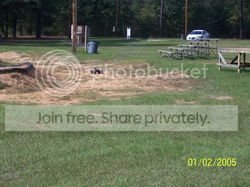

Bashing: This truck has taken some MAJOR abuse. I got me a bigger ramp last week and set it up in the court across the street and was hitting the ramp for about 3 tanks until it finally gave up. So far I have only had to replace a steering servo, motor plate, and a spur gear.

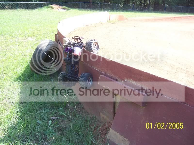

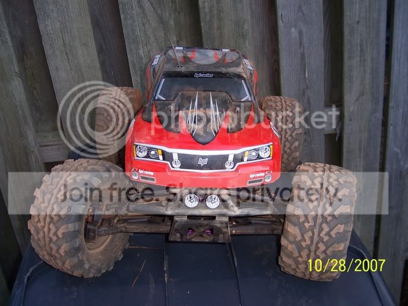

The picture with the truck on the wall hanging, that was actually pretty funny. Basically I was making laps around the track and I still had the shock spacers all the way around and another truck tapped me and caused the truck to get sideways then it started tumbling and it just happened to land right on it.....still running. Besides the steering servo stripping on me the truck ran fine the entire day without breaking anything else. The truck was hit several times in the side, tumbled, landed wrong a few times and it still kept on going. I did to get run over at the off road track but didn't get any pictures taken this time but the truck handles the jumps nicely and lands smoothly. It is pretty easy to control in the air but I did have several bad landings where it tumbled about ten times.

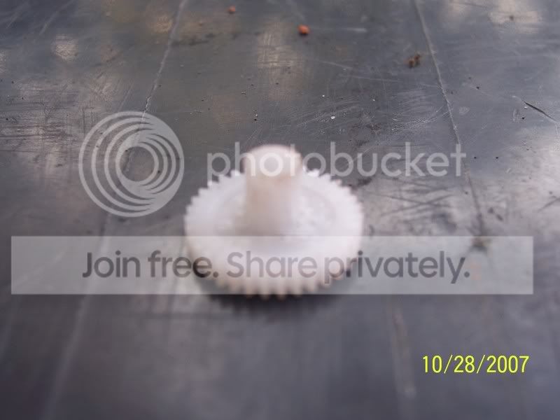

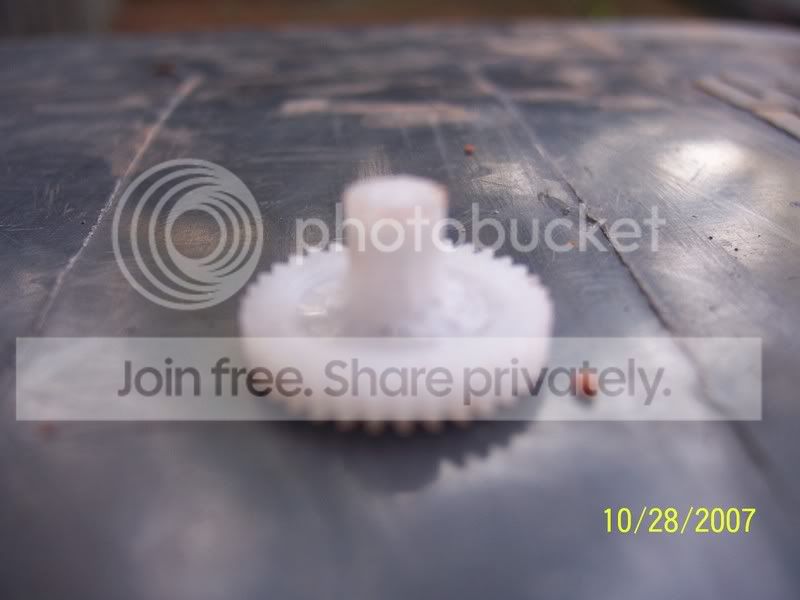

Picture of gear that stripped in servo.

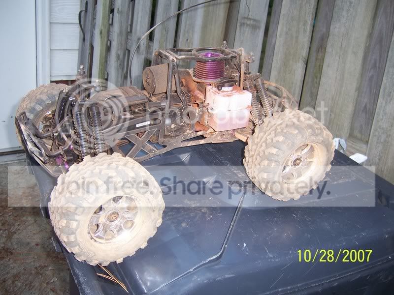

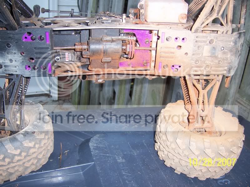

After shots:

The parts I have had to replace hasn't really been anything major. The steering servo I was already prepared to replace considering I haven't had any stock savage servo last more than 1/2 gallon. The servo went out while at the track, first tank for the day and was just driving around in the field and noticed it wasn't turning as sharp and was getting less responsive until it finally stopped working completely. The motor plate, spur gear, and the bent shock was damaged from hitting a jump in the street and having some awkward landings. The ramp I was hitting is almost 3ft wide and maybe 1-2feet tall ( I will post pics of the ramp later). While hitting the jump I was getting maybe 5-8 foot of air and launching maybe 10-15feet outward.

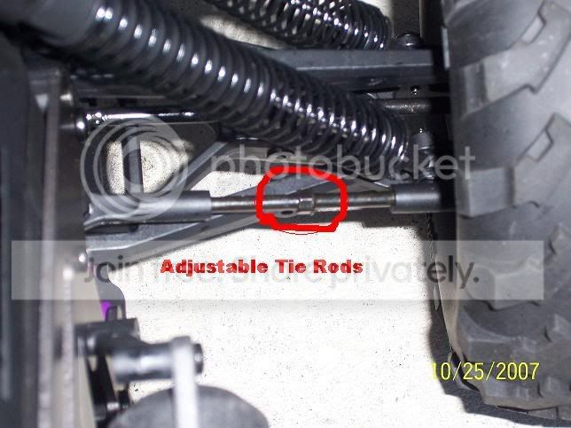

Adjustibity: (10) I gave it a ten because it has the adjustable transmission and the tie rods. Not too much you could ask for in this part.
