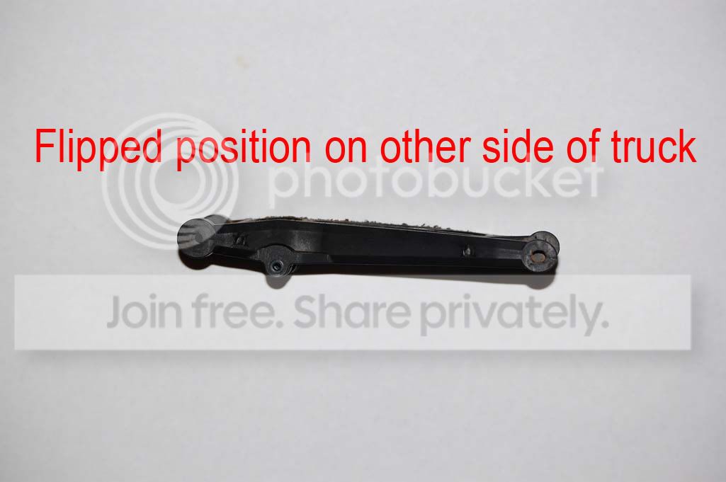

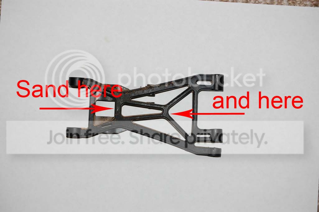

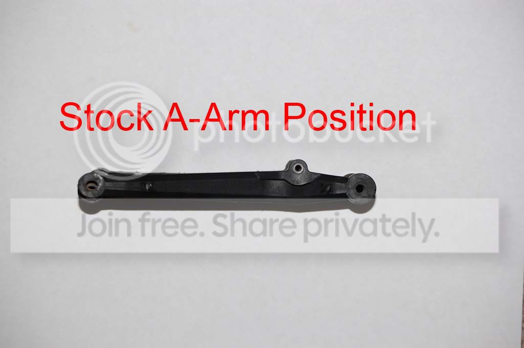

I was thinking about getting more travel with the Savage X A-Arms. If you were to flip the stock arms you could lower the shock mounting hole about .625†of an inch... so you would get more travel with 5b shocks using stock X arms…
First thing you would have to do is get out the dremel and sand some clearance spots for the dog bones.
Then put the right arm flipped over on the left side of the truck, and the left on the right side of the truck. Sounds wacky but it should work…
Only other thing I can think of needs some kind of spacer so that the bottom of the 5B shock clears the a-arm and upper arms…
I haven’t tried it yet, but might do it next week see how it works out..
What do you guys think of my theory…?
that should work fine sunk but one would have to keep an eye on the shock eyelet and mounting point for wear as you rub the truck over things.
true, but you could also use a longer bolt.. also its pretty close to the wheels so i don't think it would be much of a problem...
