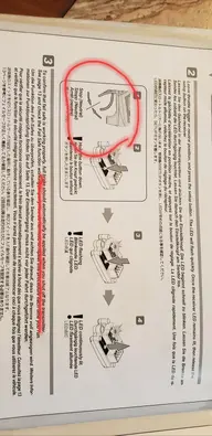

Hello everyone I just purchased a savage X 4.6 a couple months ago and I unlike others always read my instruction manuals from cover to cover on anything I buy . I found 2 mistakes in Hpi X 4.6 manual.
don't get me wrong I love there savages but I'm trying to help out other savage owners.
1st mistake is on page 45 where they show you a picture saying "note direction" of rotostart bearing when replacing I installed it there way and engine would not crank a hair I turned bearing around the opposite of they it is shown and wala it turned right over..
2nd mistake on page 40, to set failsafe leave throttle in neutral position. Pic shows you neutral position but you need to apply full brake when you set your failsafe. Otherwise it will not brake if you lose communication with your transmitter..I hope this helps someone out.20190616_232845.webp20190616_232845.webp20190616_234654.webp20190616_234632.webp
Yes. When I got my Savage X 4.6 recently I have noticed this. I couldn't set the failsafe until I watched a video by HPI themselves explaining how to do it. I have told HPI about this upon getting my truck but they did not seem to care. See the manual on their website because that's the most up-to-date one. I cannot understand how it is even possible to send an outdated manual with the truck. If they've just been manufactured, why don't they print the latest one?

Olds I agree with you failsafe to idle would be better then full brake but hpi says to set failsafe to neutral then shut off recuever and full brake will apply itself . Wrong it goes to neutral.
