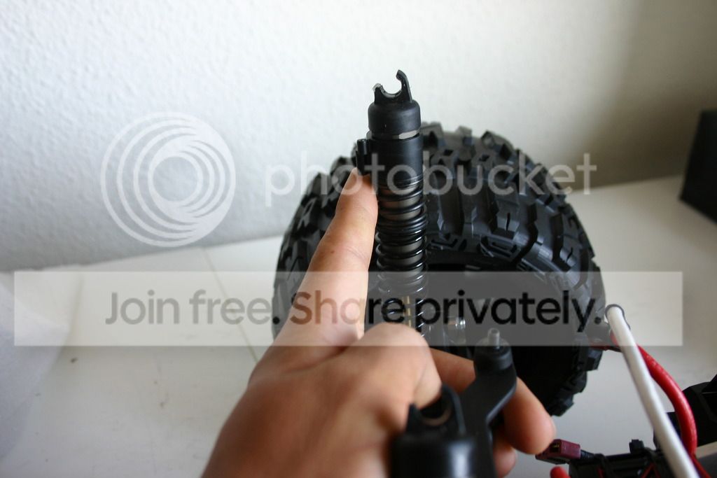

So I ran my savage yesterday with the aluminum big bore shocks. and I'm not happy, one medium sized jump and the rear shock caps busted right off. both, in the same spot.

I had no luck finding hellfire caps off my big bores either. Got these from Integy image.webpcomes with caps, threaded bodies and 3 different sets of springs. Uses all the internals from your big bores. I've given them a pretty good beating so far with no troubles at all.
I had a bunch of money invested in them fancy shocks and had nothing but problems so I ended up building the stock ones from my kit and have never had any issues with them other than a bent shock shaft driver error. My recommendation would just go with the 8 stock plastic ones.

They are Integy T6710. not sure if the caps would fit on the Hpi bodies. They come as a kit anyway, don't think you can get the caps alone.
The caps don't fit on the stock bodies. I also have those shocks and have had great luck with them. They are basically just an aluminum replacement for the shock body itself and the cap. The rest of the parts (shafts, seals, etc) stay stock.
