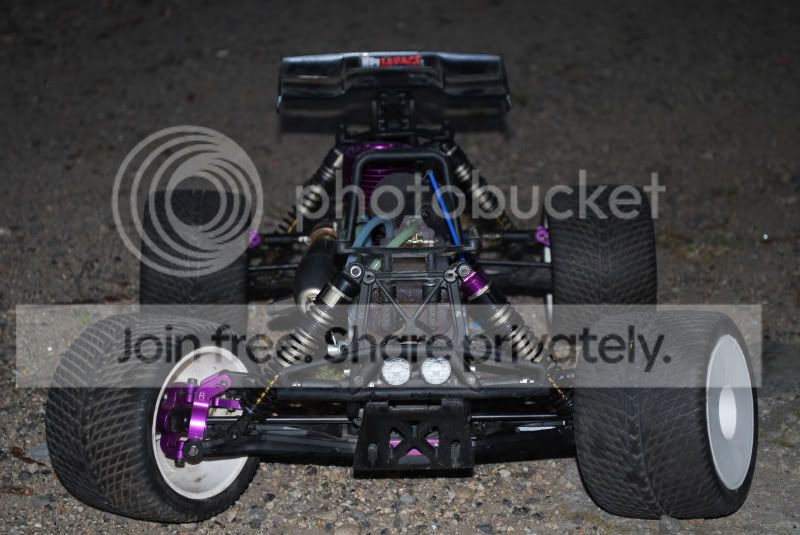

hellfire caps ...
Right front...
Question for Bankrupter. How do you get those Hellfire shock caps to seal air tight? I cant get them to seal air tight, they leak out at the little holes. I looked at the Hpi site and the Hellfire shock bladders look the same as the big bores.
lol you didnt put the bladder in ? Yes it needs it. Hellfire shock is the same as the big bore. the pic I posted has HF shafts, caps, springs.
