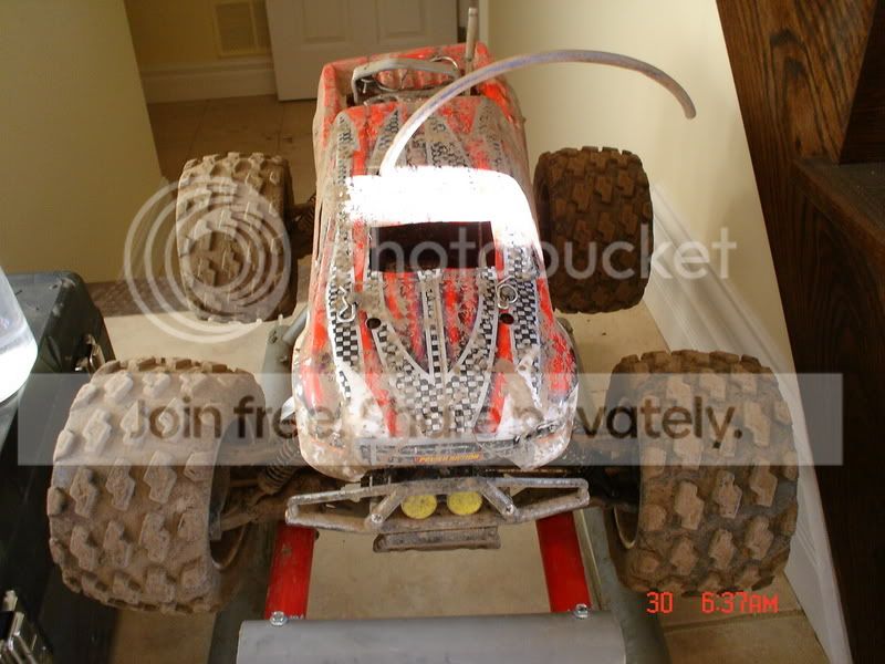

How can I break 6 heavy duty dog bones in 3 weeks?
awya14
156
Is there something I don't know about hardened dogbones?
I'm assuming they are all the same size>123mm
but if the newer x-xss where 130mm and I used them would it be the cause to sheer?
same spot ..front and rear..sometimes crash related sometime not..
even snapped 2 center bones
sure I beat the thing silly everytime I go out ...but so does my buddy and he's snapped 1 in the same time frame..his is a .25..
just thiought there might be a simple answer and I don't have much time to search it ...thanks for the help:jamout:
