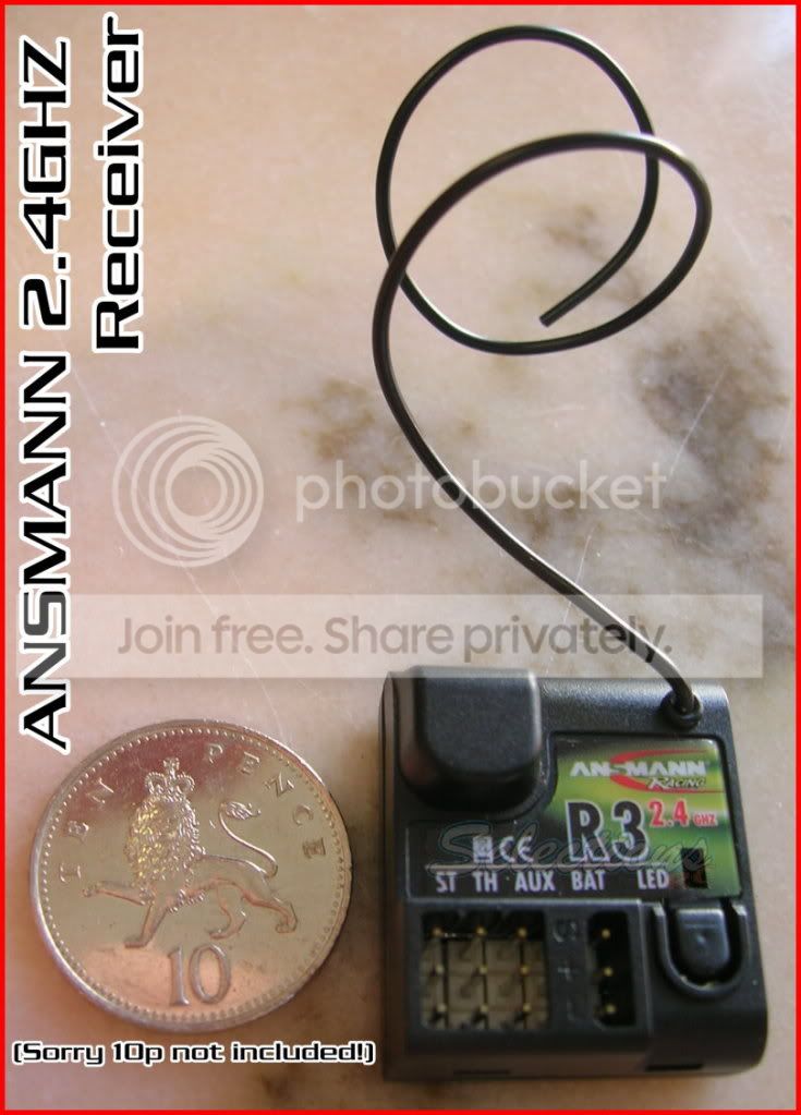

Here is a pic of the receiver:
On the far left (ST) is where the servo goes) and TH is for the ESC.
My motor is working now but the servo is still not working??? Am i doing something wrong or is there something that needs to be programmed???
