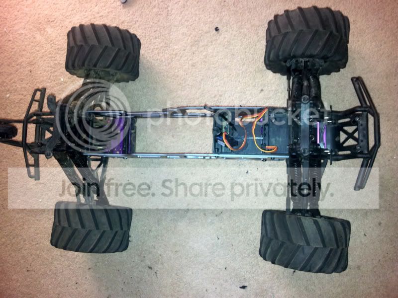

Another project begins. The X is stripped.
Front and rear diffs rebuilt with the aid of another Savage X now mounted to XL TVP's.
Just have to put the stuff in the middle. I reckon I get equal enjoyment out of building them and bashing them. lol

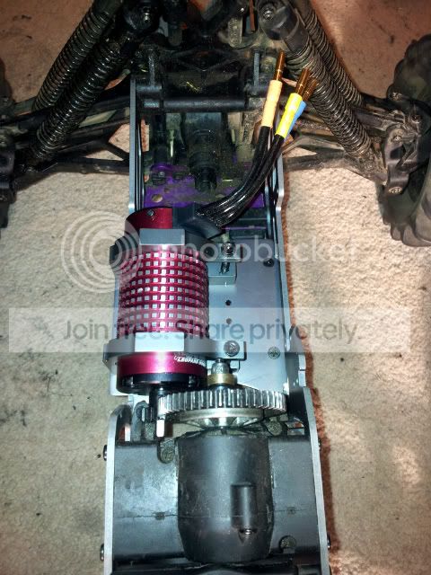

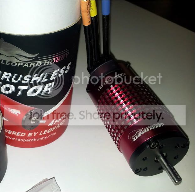

Choice of power plant this time. No cheapy The big blue no namer in the X failed big time.

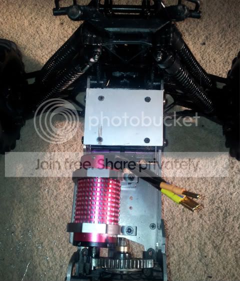

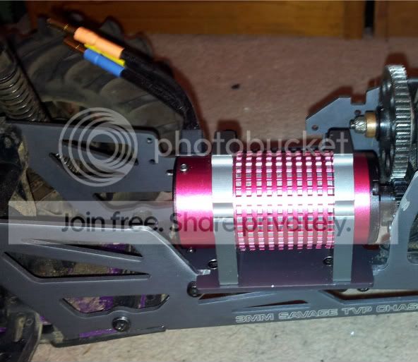

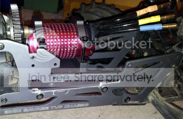

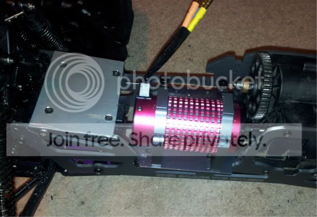

Motor installed with a little work from the Dremel. The Flux motor mount made it a lot easier but still not a bolt on to the XL TVP's.
Had to remove a top section of the TVP here to allow the Flux motor mount room. Will have to reinforce next.

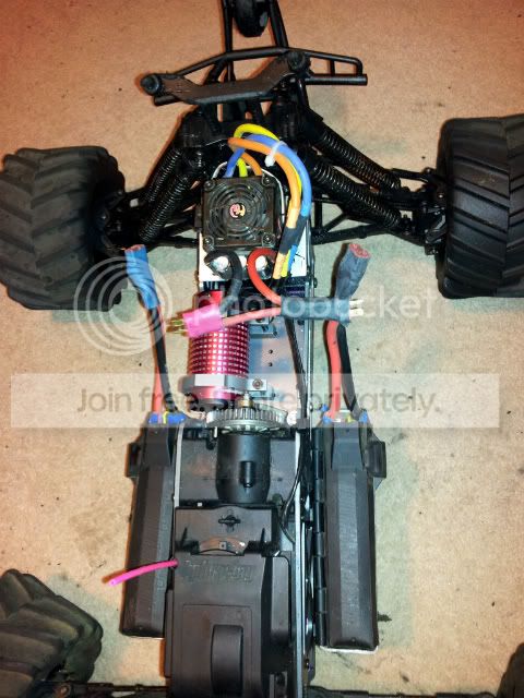

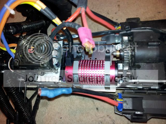

47T spur, 16T pinion. HobbyKing 150A esc ATM supplied by 2X3s 5000mAh 30C Zippy Batts.
Reckon the ESC will sit nicely behind the motor. Bonus of the XL TVP's.
Also bolted these on for a bit more width.
Made up ESC mount plate. Those extra 2 inches of the XL are very handy.

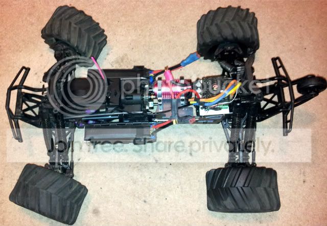

It's alive!

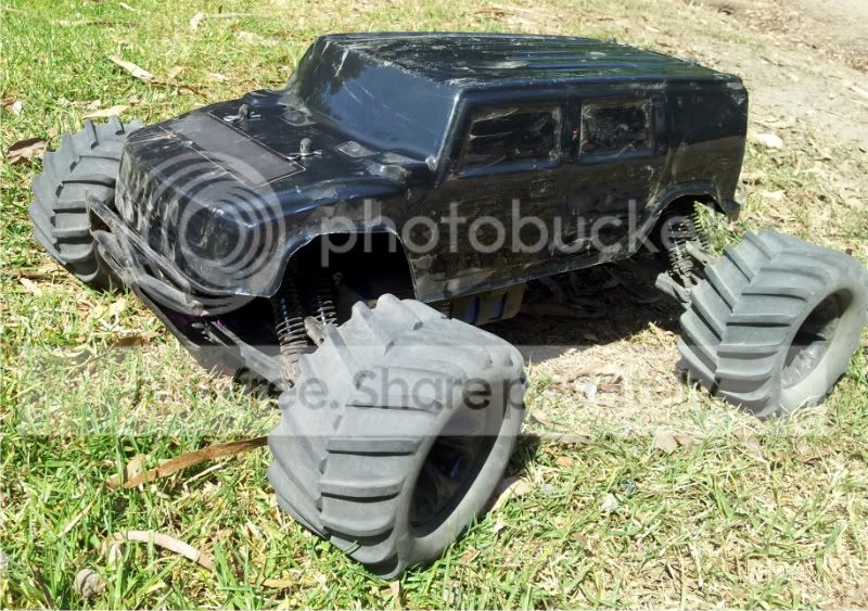

Finished off the electrics now just the shell to go. Not sure what to get as I need one suitable for a 400mm wheel base.
Could just buy a HPI XL shell but want something different.

Shell wise I've got my eyes on a Humvee ATM. :cool:
It is finished!:woo:

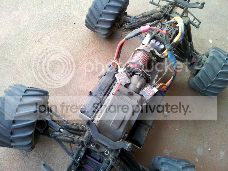

Running 16T pinion 47T spur. Torque is unbelievable. Going to try an 18T pinion the calm it down a bit.
Serious bashing for 20mins in ambient 30C and the motor never got above 68C. No cooling fan needed.
I can now see the difference between a cheapo motor and a good one.
