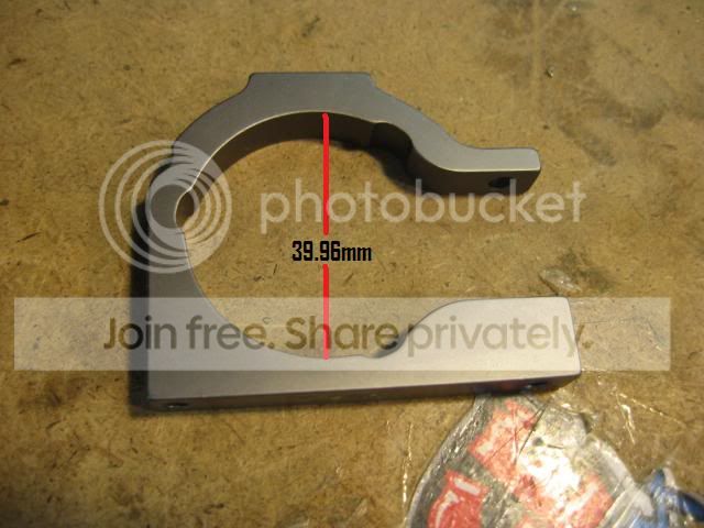

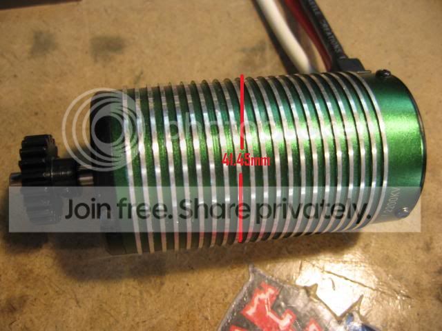

One thing to remember with the castle 2200 is that it's 1.45mm bigger in diameter so the stock hpi mounts will have to be bored out.
Sorry my bad the difference is 1.49mm
