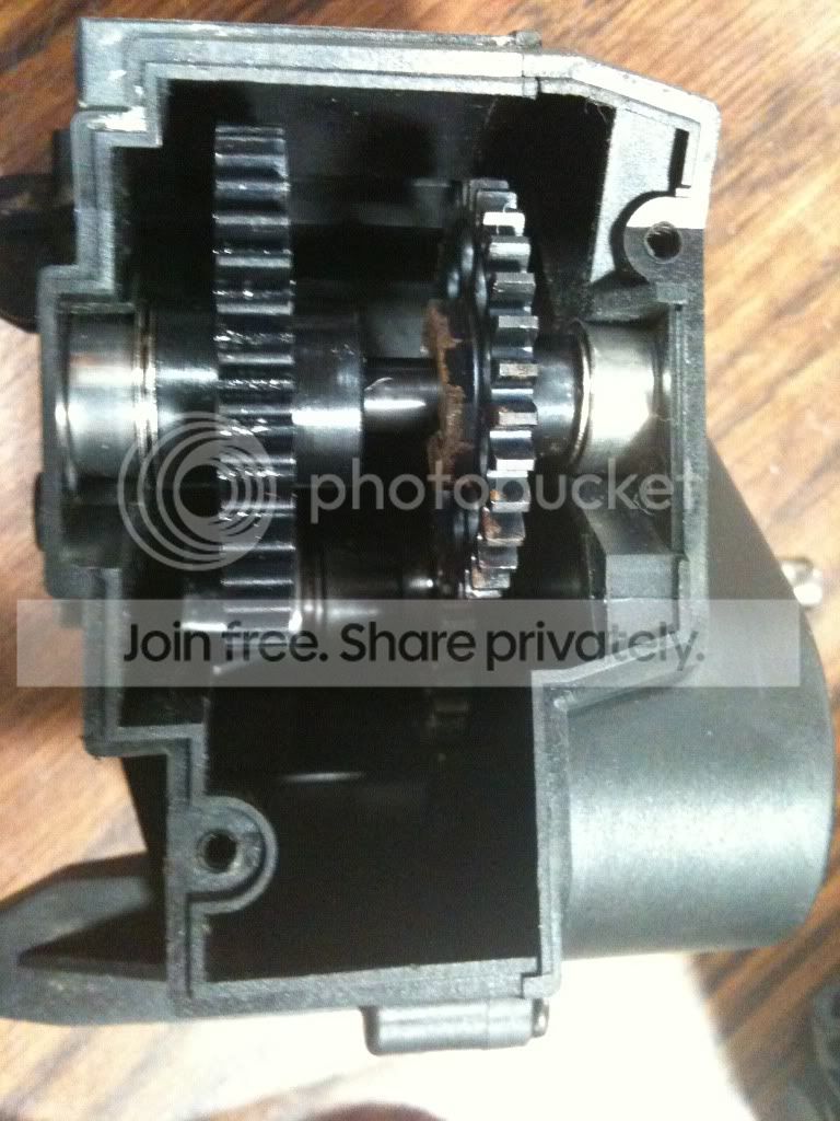

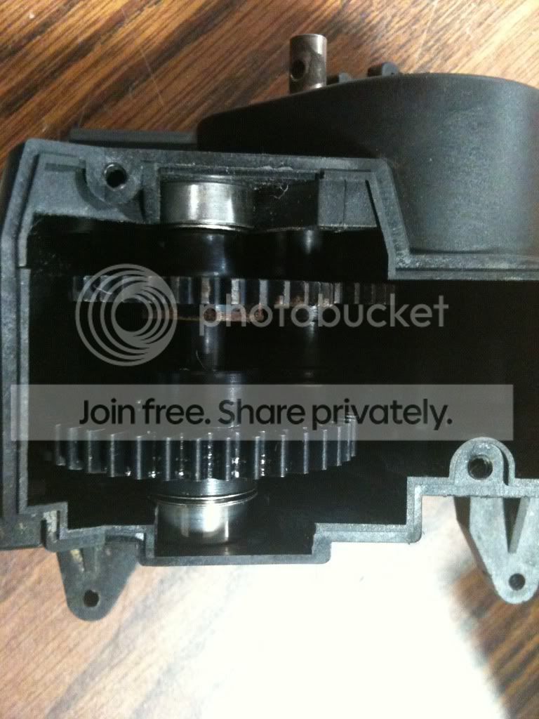

full machined gear flux tranny, "bulletproof"
Jon
791
parts needed:
HPI86275 hpi light weight idler gear 29T
HPI86274 hpi light weight drive gear 32T
HPI102514 hpi HD drive gear 18-23 tooth
HPI 102244 hpi high speed idler gear 39T/ shaft set
the assembly is pretty straight forward so i don't think i have to make a step by step guide but if someone needs help just shoot me a pm...
after installing these gears this tranny feels butter smooth... i have not had a trans ever feel this good. I'm hoping this will be last set of gears ill have to buy for this thing.

no a flux uses the cast gears that i keep breaking, these are aftermarket HPI gears to replace the poop cast ones.

yes i just got this setup for my flux.steel gears replace the cast,much stronger much smoother.more speed,not bad for a $30 upgrade

Sorry to recycle an old thread. Ordered these gears too, just wondering are they hardened like the machined HPI 102514 18-23T drive gear?

There's a few guys in the UK that I know who are using the lightweight/hardened gears and not getting hugely improved times between changing gears.. I've got a tranny that I've just built with them, sealed it up with silicone sealant and running "wet", as I believe that much of the problem with the gears failing is down to them battering against each other without lube. So far I've only managed a couple of runs as I hadn't sealed it up properly, but will be doing a long term test with a pretty big motor chucking torque at it. I'll put a thread up at some point soon and take some pics!

I've used some fairly thin MTB oil in mine (Finish Line "Wet Lube"). I'm not sure what formula it is, certainly not pure silicone but comparable in viscosity to 2k diff oil.. The main reason I used it is because it seems to reduce the drag between metal-on-metal contact much more than other oils that I tried. I decided against anything thicker because I didn't want to reduce the efficiency of the drivetrain by adding excess drag, and figured that with the tranny about 1/2 full of thinner oil it would be splashed up and cover everything, so should do the job properly but weigh a little less... We'll see how it goes, as it's all been guess work so far!

Not sure about the other guys, apart from 1 who defo did but's now gone onto a CD mod. I've shimmed mine so it's all lined up perfectly and there's as little movement as possible. The gears aren't meshed quite as tightly as I'd like, but that seems to be a problem you can't easily get round, if at all..?
