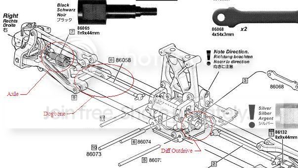

Ok, so everyone is on the same page... here is the name of the parts VVV
If any one of the three circled parts is from an XL or flux, they all have to be from either an XL or flux. You can't use XL diff/outdrives with x dogbones, or XL dogbones with X axles.
