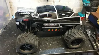

I'm away with my family atm when I get back tomorrow I will show you what I have done I have about 3 sets of tvps spare so I had a little play with a damaged set. Only 1 set I have are standard the others are aftermarket not sure of the make as I got them as a job lot of savage parts off sleasebay I was running a nitrostar 4.6 but it is getting a little troublesome hence the conversion. I have attached a pic of what (show shell) I will be using and also the motor, I got a good deal for an esc and motor off of banggood , as well as 2x 4s 50c 5000mah lipos I will try and post some links.
