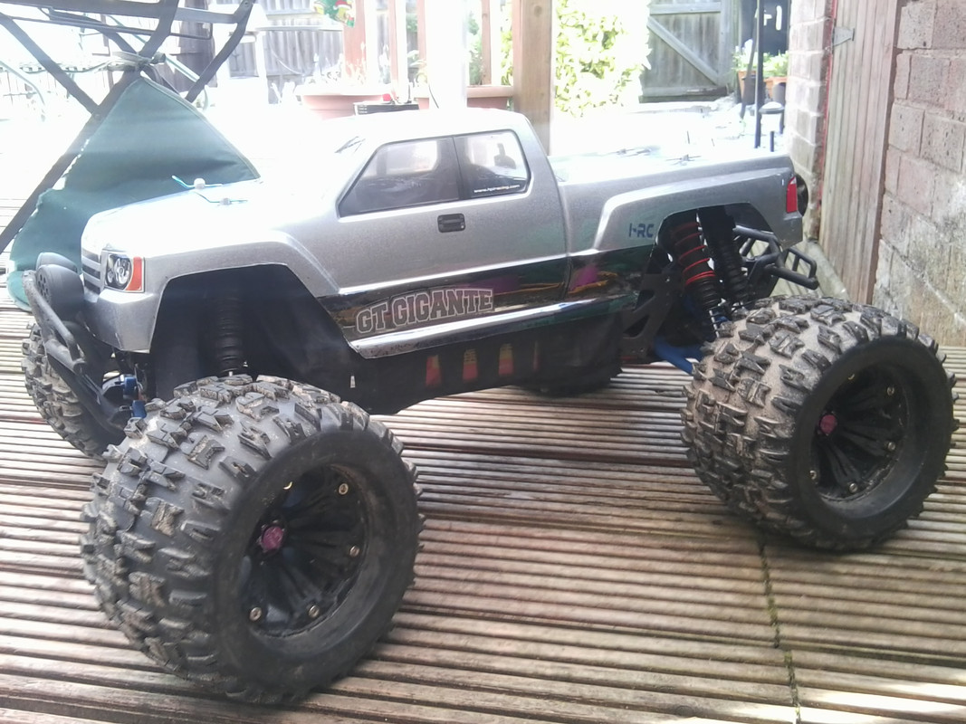

got round my mates this morning and he had finished the conversation, looked amazing
but hadn't noticed he had changed the outer axles to the longer xls and added wheel extenders they seemed a bit loose but not enough to worry,so got to the beach put first 4s in seemed fine for 5minutes then the esc kept thermaling and cutting power so thought it was power problem and changed new lipos same thing
The motor and esc were also warmer than usual so checked her over as it seemed like something was binding the drive and causing the motor and esc to work harder and shut down,noticeD my IRC dogbones were sloppy as hell as the xl axles are larger than the hp one by a couple of MMs causing the dogbones to bind up
so stopped running and watched instead at least I don't have to charge lipos for next week haha
so plan is to change outer cups back to my hp ones and lose the alloy extenders as they have to much play which my flux hp didn't so will just sell the xl axles and extenders on I think,got a bit of footage will do something with it later as am starving now and need my sunday roast
so for the 10 mins I got to run she seemed to handle a lot better xl size hardly any wheelies etc and better up the dune hills with the extra length it also looks a lot more badass stretched hehe
all sorted now removed the xl outer drive cups and put hp ones back on ( 2mm ball difference ) with extenders and had a test run no thermal so no binding hehe ready to roll baby :cool:
Another test run this morning all good still loving the xl size now wheelies a lot less on 4s and turns a lot better cant wait for the bmx track now
