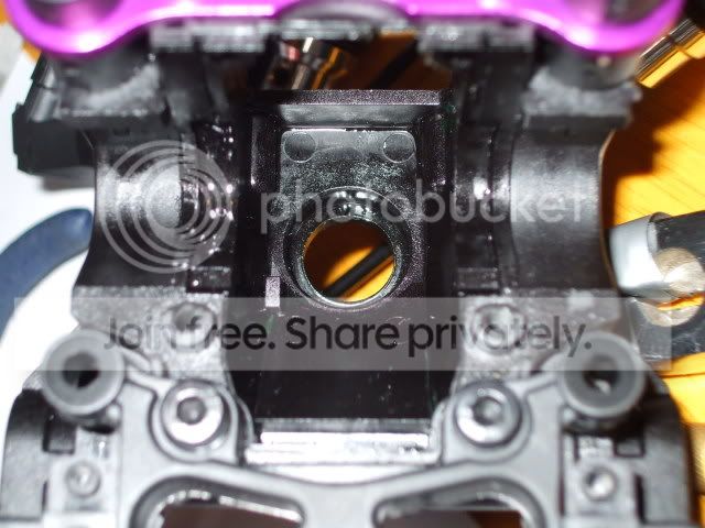

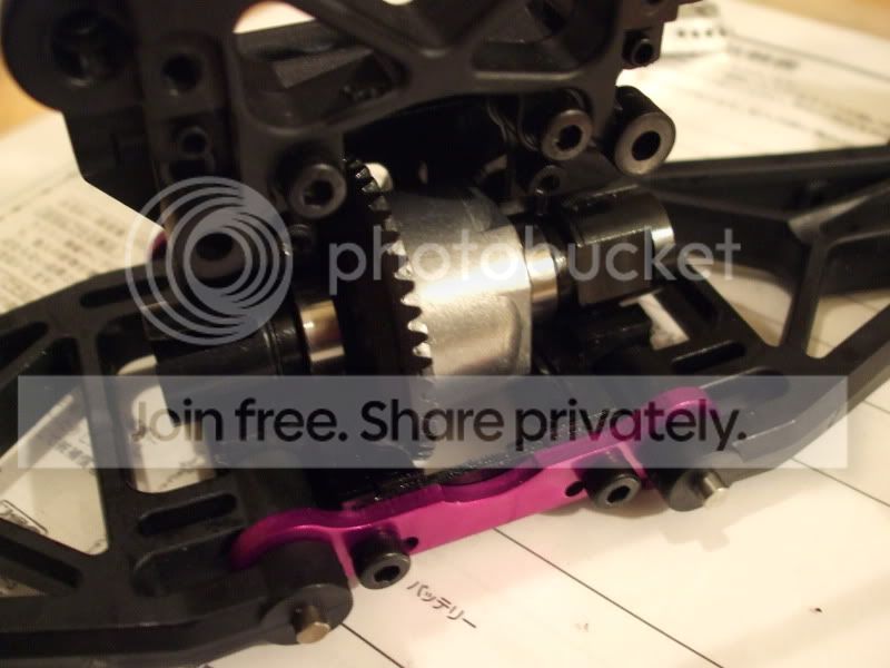

Well I've only got the flux so I don't know if it's different material to the the other savvy's. Both bearings are 16mm od, 8mm id on the gear and 10mm id on the cup here's a couple of pix.
Yes they say it's (The flux diff housing) made out of a better composite material and it does use a bigger bearing on the ring side but the internal case is the same size as all other savages.The bearing sizes are 10x16x5on one side and 8x16x5 on the other so the outer size is the same so you can use 4.6 and other savages diffs in this housing I hope this clears up any ?'s
