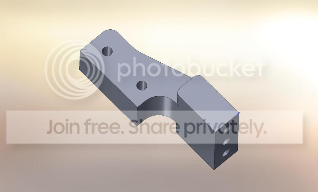

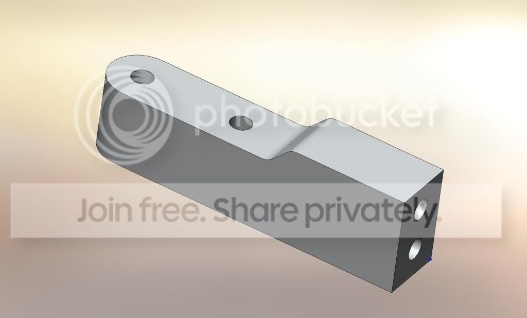

I can draw them up if someone wants to make them. I can even market them. I personally just don't work with metals. I do have staff at my full time job that can but they would be to expensive to have make them. Looking for cost effective to get them to the market as cheep as possible.

Jason, draw them and LMK when they are done. I have 3 shops to try.
How about this? I removed the pin and replaced with screws so the lower pieces get 2 screws and the ends get 3 3mm screws, which I have bulk of. This will reduce any chances of the threads pulling out and secure the packs to the TVP's better. Also to reduce machining costs.
Now all we gatta do is find someone to make them for a decent price. So if your interested contact me. I will check with one of our machinests to see if he will do them on the side for an extra buck.
Justin I will get the drawings completed and sent to ya. PM me your email addy.
(Sorry drawings do not show the threads)
http://i151.photobucket.com/albums/s123/larsenracing/Our Parts/prc208-cad.jpg
http://i151.photobucket.com/albums/s123/larsenracing/Our Parts/prc207-cad-1.jpg
lol I would not want them to show Jay... fastest way to see pop up makers is to do the part they cant and post it on a site lol ...
Looks good! As far as the pin, its a sweet idea... but the extra tapped hole may add to costs. That is yet to be seen. I love it!
Actually, the pin is far more expensive than a tapped hole. That pin adds on an entire extra machining process that you have to reset the piece for, where as a tapped hole is all of a couple seconds on a thread cutter machine.
