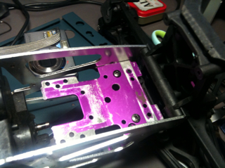

On my first build, I made the mounts from scratch - not hard, just used aluminum angle iron. But getting everything to fit just right was a pain in the tail... This is the "before" pic:

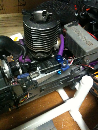

And this is what it looks like now with the FLM mounts and TVP:
I suppose the argument could be made that buying is not as much fun as building, but it does take some of the frustration out of the process :)

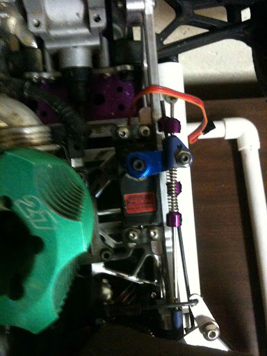

I see your linkage is different than most. It looks good but are you going to switch the servo. Anything below SF-10 in my opinion is not going to last for long. I just got the ACE1015. Alot of good raves from the guys
Typing to fast i meant to say the SF-1 may not last for long. Had mine for about 3 months and then it died.
