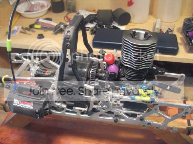

i just got done swapping everything over to the flm lg extended chassis...now i having problems with the stock throttle/brake linkage working right....
anyone have some pics of their setup with the servo in the stock location? and a parts list on what they used? thanks
I found out with the stock th/br mixer it was to big for the spot on the flm chassis. I took my file to it and made it fit.
Here is my linkage set up :

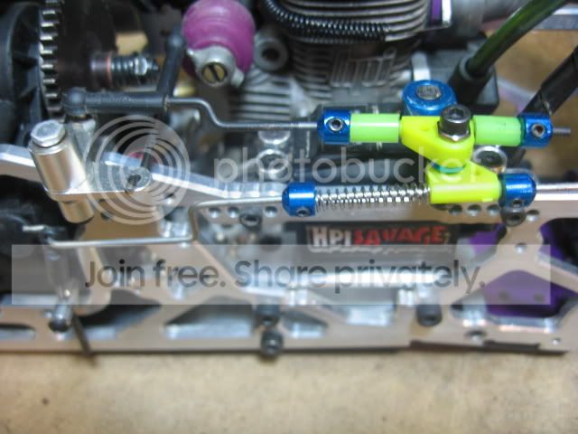

In this picture the spring should be on the top linkage not the bottom like this :

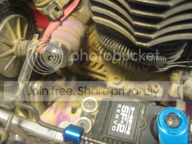

From the other side:
I don't know what i was trying to take a picture of but this might help too :
