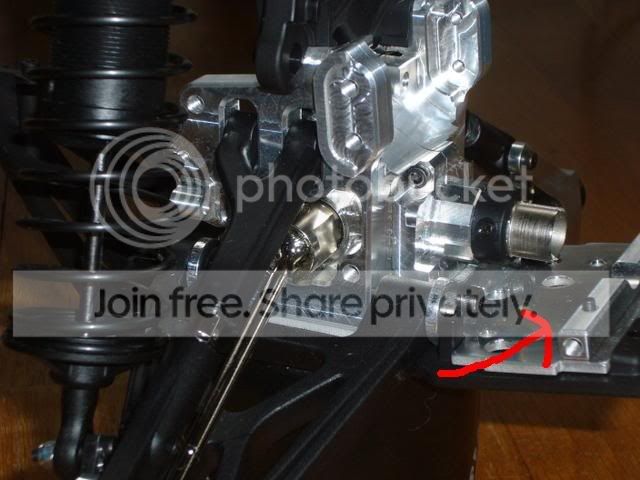

I just read your PM HopIt. You need the FLM drag link to get things all together. I just happen to have a pic of said part. It is the aluminum part between the towers. The part number is "FLM4800".
Also - while you have your truck apart, you should replace the 4 plastic bushings that the steering towers pivot on with ball bearings ... unless you've already done that mod. If you haven't done it, HPI has a kit with the bearings in it. However, the bearings are a common size. I just took the plastic bushings to my LHS and asked them to match it with a bearing. It is a good mod.
