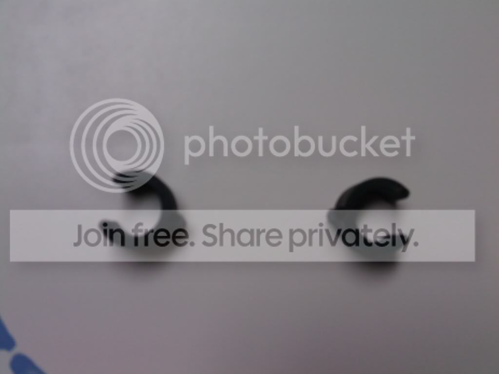

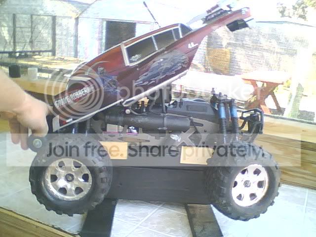

I am new to this forum so don't hate me if this has been done before. After reading the thread by maximusraylius on modding stock shocks, decided to experiment a little. If you look on the stock shocks there is a plastic piece above the springs that is removable (not sure what it is called).

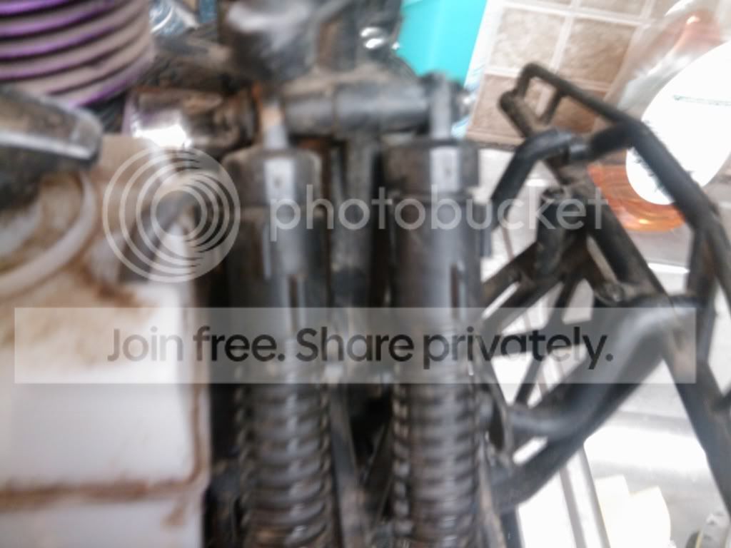

So what I did was remove these from the front shocks.

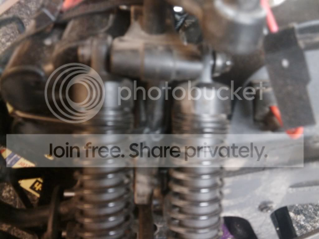

And put them on the rear shocks.
So what this did was lower the front end and raise the rear end.

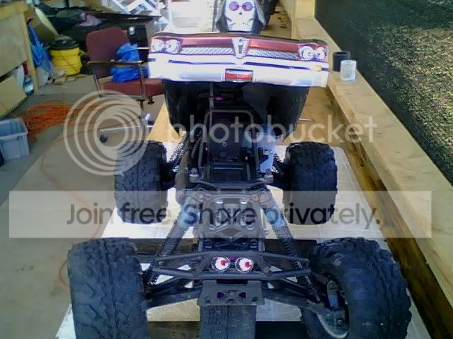

This allowed the truck to dive into corners and turn on a dime. You could also remove the pieces from the front shocks and leave the one on the rear, this will be a little less agressive. I know this is not a permanent mod, but it does allow you to change the ride height and see how it handles different. When I permanently mod my shocks with the fuel tubing I will put a longer piece of tubing in my front shocks than in the rear.

Ok well i sort of did the oposite. You added to the front and back. I took them out of the front, which in turn lowered the front and raised the rear a little. The only down fall is less rebound in the front.

Well I think you have done the complete opposite of what your trying to accomplish. I found the lower it is and how the a$$ end almost drags around the track the faster it is. It digs in the corners and less sag to put the power on the ground. Raising it up only adds to a higher center of gravity! That is very poor on the track, roll overs and sliding around the turns and massive sag. 1/2 fuel tubing in the stock shocks all
Spacers removed and it sits level to the ground and 40wt oil. Best combo. It will bottom out but better than rolling over in a race.

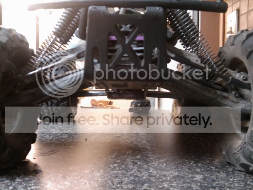

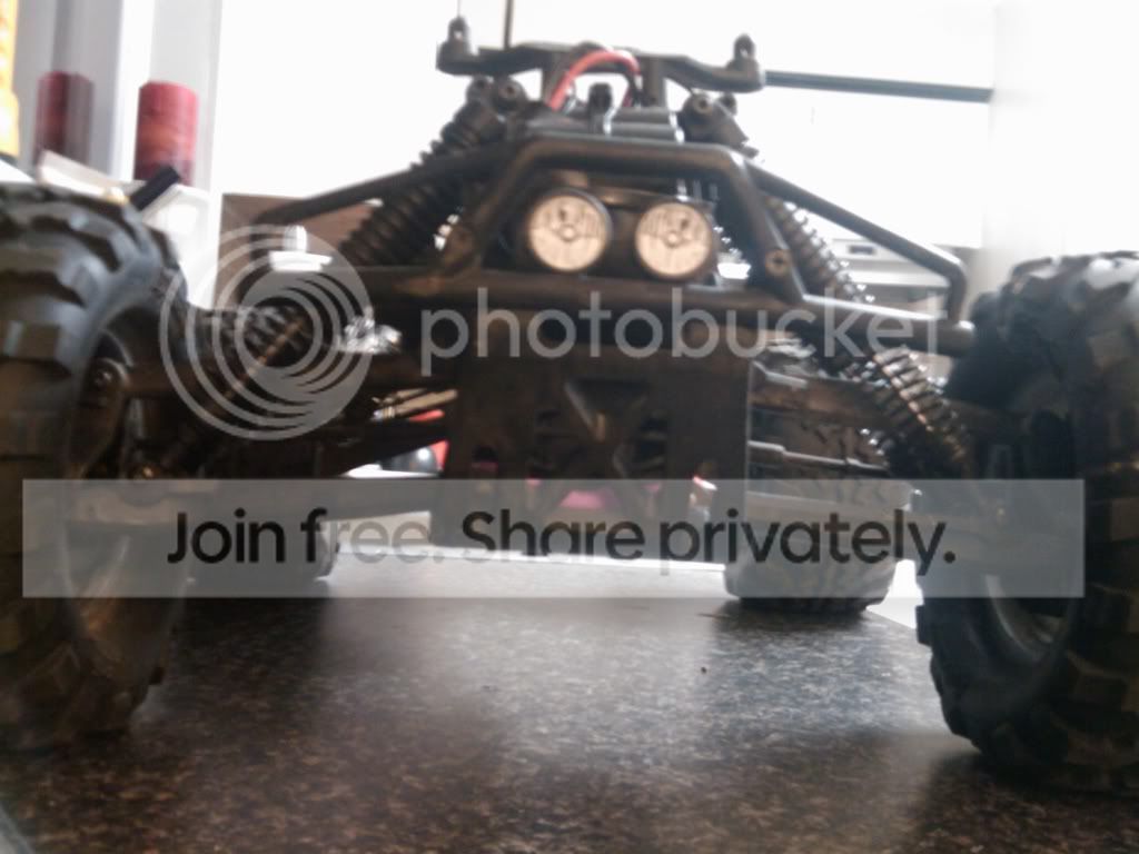

Here's mine with the mod to stock shocks before I got my big bores. Notice how flat the a arms are.
That answered my question I will add a 1/2" and call it good. Thanks. Did the shocks become stiffer after the mod?
The shocks will not become stiffer just less travel. Mix combos of colored springs and wt oil to fine tune on your track your on. Only thing the fuel tubing mod does is lower the center of gravity and less sag and sway in the suspension. Just experiment on how the truck takes and lands the jumps. It should absorb the impact without bouncing back to much. Running it flat a arms and 1/2 off

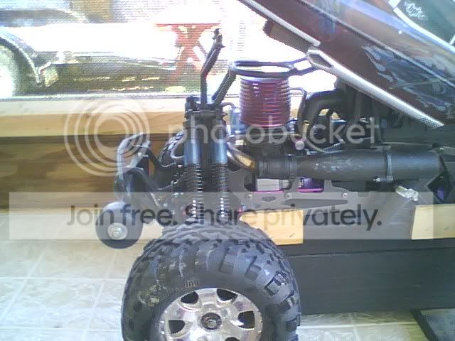

I have mine a little higher in the front. I did a 1/2 inch in the back and about 3/8s in the front. I did it for a little more ground clearance in the front as to where I mainly bash at has a lot of uneven grounds.
ok if you just pull out the spacers (the little black things that you picutured in the first post) you are reducing the preload on the springs, yes this lowers the truck a bit but you lose the preload on the springs and it will cause you to bottom out alot more.
