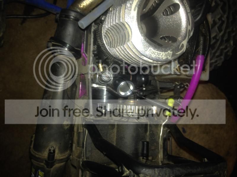

i circled in black what looks to be the problem but cant tell for sure because of the pics bent tvp
I have the same problem, my spur gear is the standard plastic which is a bit thicker too. I shelved the idea for a winter project so hope you got it sorted I am just reading through the posts. ps; you could give it a clean :)
