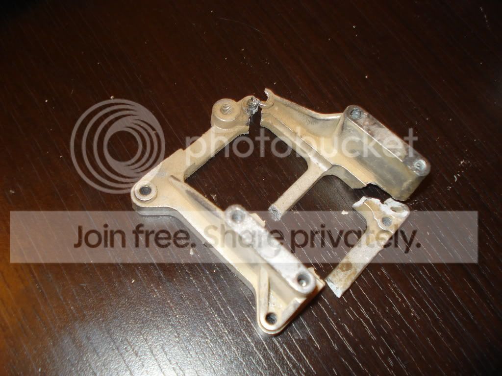

This is my engine mount, the stock one. I said ok after 8lt it should be normal to break. By the way i have to comment here that having listened to guys in here i had steel spur gear so nothing stripped, even when the engine was about 20degrees off it's original position.
I replaced it with another one. After 1 tank on the new one it's cracked again, though only slightly.
What am i doing wrong guys? Is something bad happening to my mill, that keeps breaking those mounts? Could it be that i replaced the orignal mill screws with innovative-rc ones?

the motor plate could be bent putting stress on the mount
The plate is flawless! It's the mount that it's failing on me.
idk mek, id pull the plate completely out of the truck & go over the plate very carefully, even throw a straight edge on it & make sure she's not bent.
just sayin caz ive only seen dudes break more than 1 motor mount when the plate has damage. even a slight bend or tweak can do it.
I have to agree. The engine plate is weaker then the engine mount in my experience. If the mounts are broken the plate would more than likely suffer some damage as well.
I'm currently having the same problems,i thought it was just my bad luck!Ive broken a few of these recently but it usually happens after its been landed upside down :duh:. As suggested above,check the engine plate & the engine mount brace's & check the screws haven't snapped as well.It might just be a coincidence as well,but the one time i didnt replace the plate,the mount broke without taking much of a bash.cornfused

I had a bash yesterday with the cracked mount (not the one pictured) and nothing went wrong, even though i had some bad landings. I guess i am gonna leave it there as long as it's not messing with my gear mesh and have the new one i ordered as a spare.
