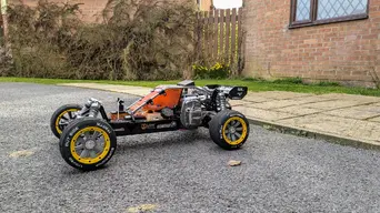

The Baja ain't no slouch! This is on a well prepared, 20 year old CY Fuelie 26 cc
The Savage has to bring it's A game to beat it. Let's see what happens......

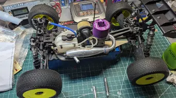

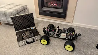

There's all manner of 1 piece engine mount modification going on with my rig. I'll take some pictures and detail the alterations.
Essentially, the TVPs lower the engine position - but the 1 piece mount had to be machined to clear the centre driveshaft. They also extend the wheelbase significantly.

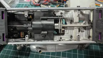

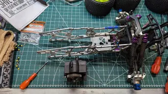

Here's the rather agriculturally modified one piece engine mount. As the FLM TVP's lower the engine and transmission significantly, the burly engine mount had to be hacked quite severely. 🤣

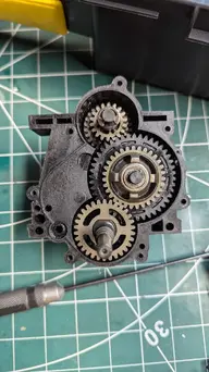

Transmission was in good shape. Pawls were working nicely, all teeth present and correct.
High speed 3rd Gear set fitted. 👍
