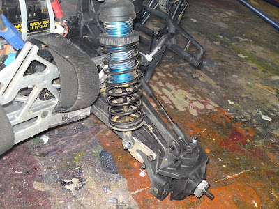

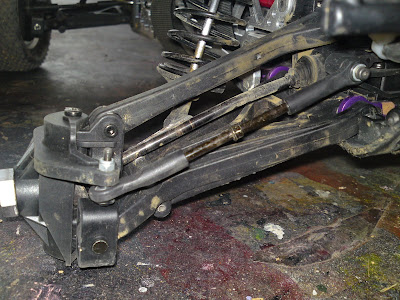

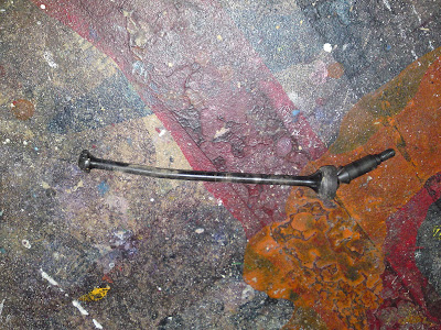

Here are some pics of my most recent bent CVD. I was lucky I noticed this early, I was racing and everytime I tried to accelerate hard the truck would take off to the left.
So no one has any brilliant ideas on why this always happens and how to fix it? I must admit this CVD looks a lot better then I was expecting it too.
CVD's rarely hold up to bashing at least on the Savage. Dog bones do snap but a great upgrade to them is the FLM Super Duty Dog bones from the SMF Store, they run about ~$7 each but will last. As for the Drive cups they do wear out, if you get the chrome ones they last longer as they are heavier duty but do wear out. If you run in sand or dirty environments it will wear quicker. This is part of Wear and Tear.
