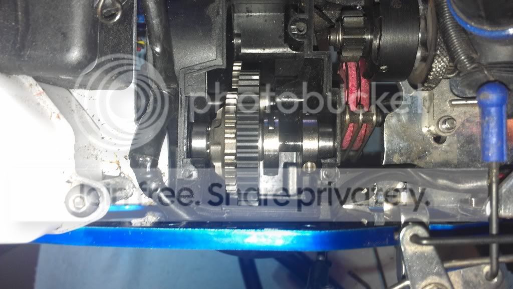

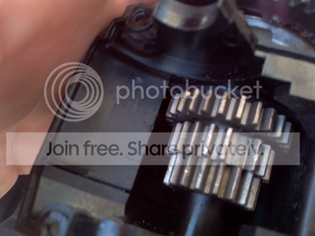

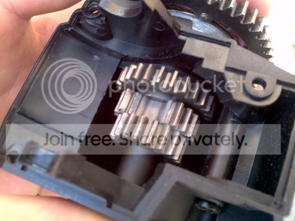

The top of the Blown 3spd, I've seen worse, but not on an un-tuned engine. The ERCM Drive Line Curse starts already :lol:
The Fix, an SV250 Bullet Proof Single Speed Tranny 8) EDIT: Just noticed this is just the Single Speed Mod, I have since installed the 2spd Idle and Drive gear. Guess I didnt take a picture of it.

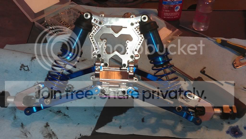

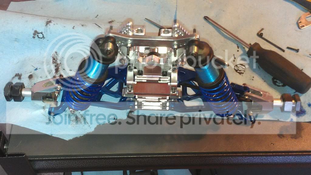

The FLM Bulks and Towers with GH arms and Integy Hubs. LST shocks and Powder Coated Raven Dual Rate Springs.
I'll get some pics of the whole Truck Aluminum'd out once the Blue Tranny comes in 😀
