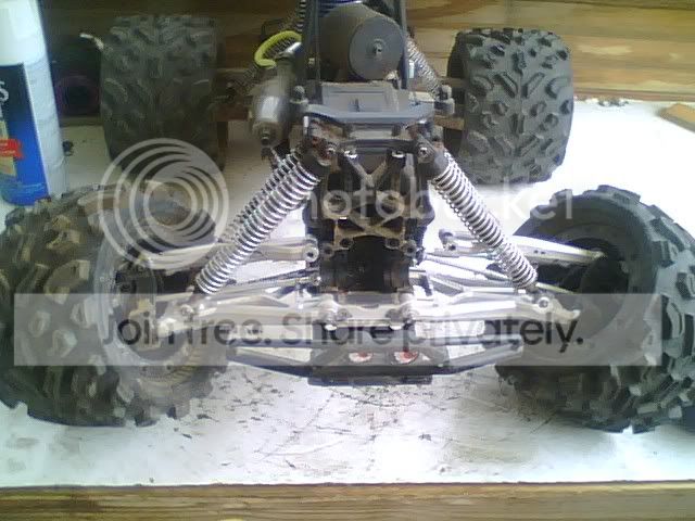

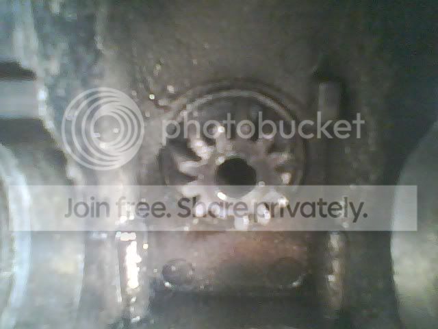

come on people....post a picture or something.. i really don't know what a pinion gear is.
s the gear that is inside the bulk head runs off the drive lines...that link is the part....
http://www3.towerhobbies.com/cgi-bin/wti0001p?&I=LXDLD3&P=Z
Oh I see. I checked it, it's fine it's not stripped or anything still looks brand new . I'm not sure what the problem could be.
Check the bearings either side of the diff, behind the outdrive cups, if the bearings let go you can totally lose the meshing between the pinion and ring gears altogether without neccesarily stripping the gears, its happened to me.
This one strippied the gear but it has happened to me without the gears stripping.
[/IMG]
