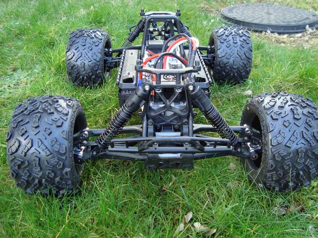

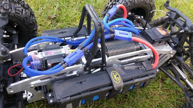

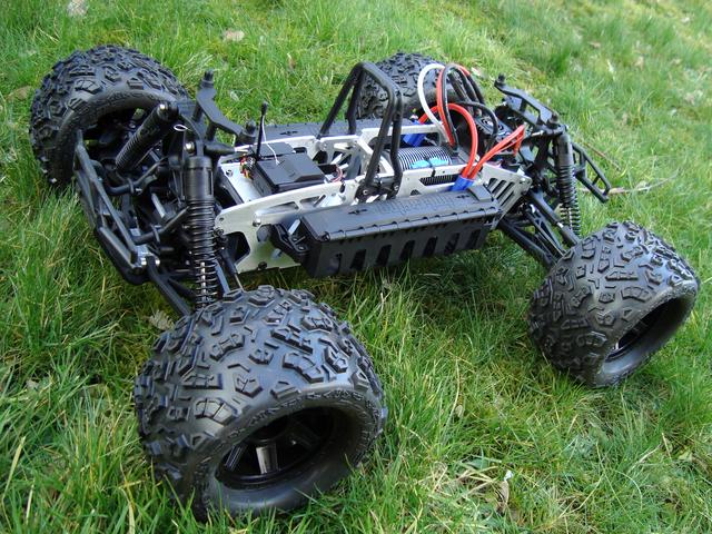

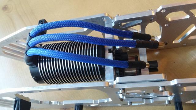

As promised a big dump of photos. The Journey of my Savage so far and beyond.

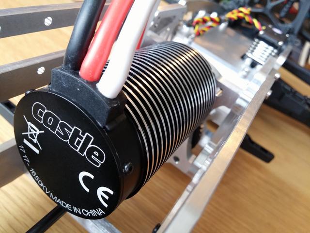

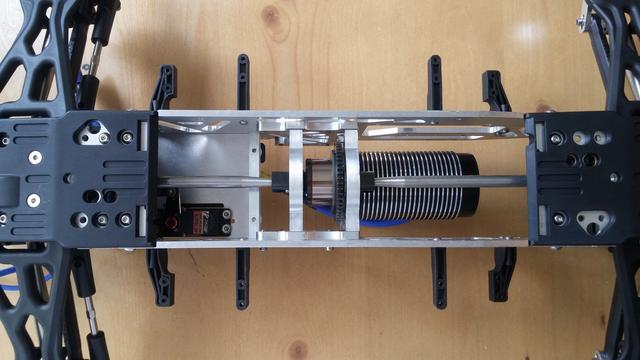

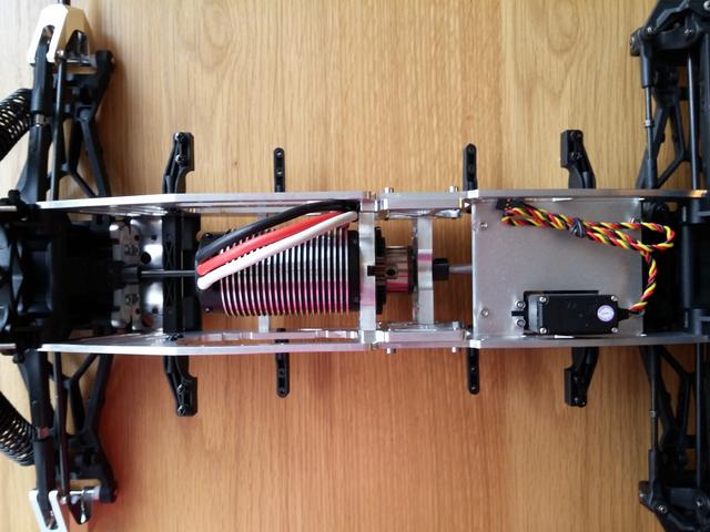

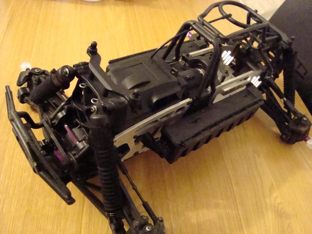

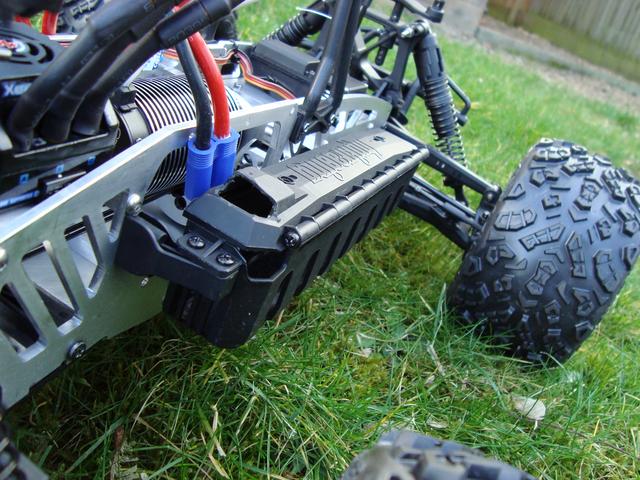

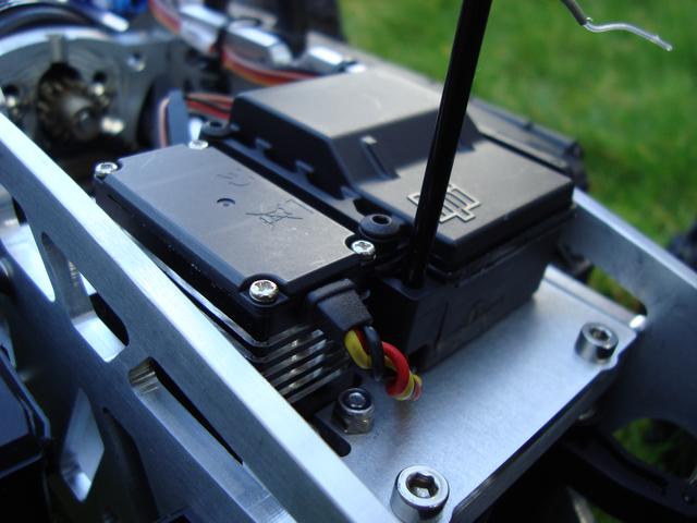

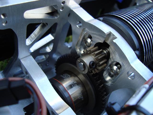

Purchased as a Flux roller in 2015

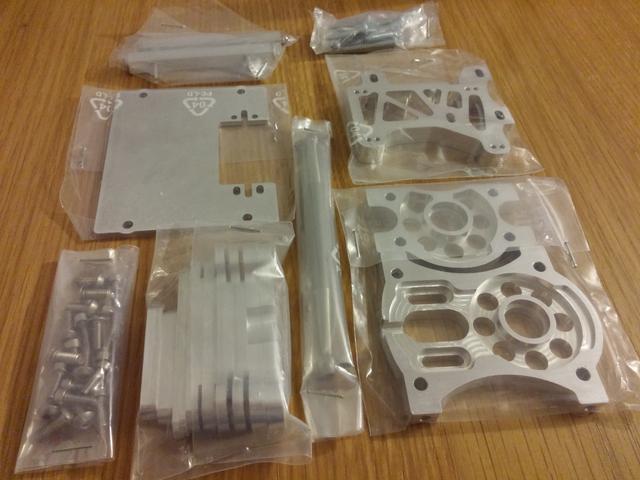

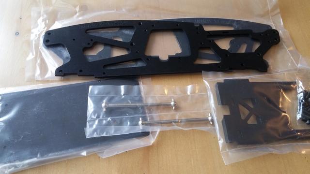

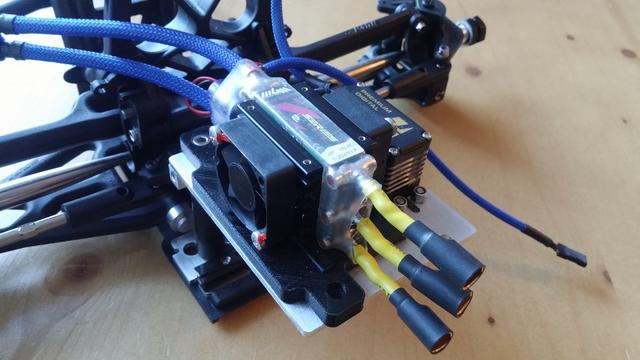

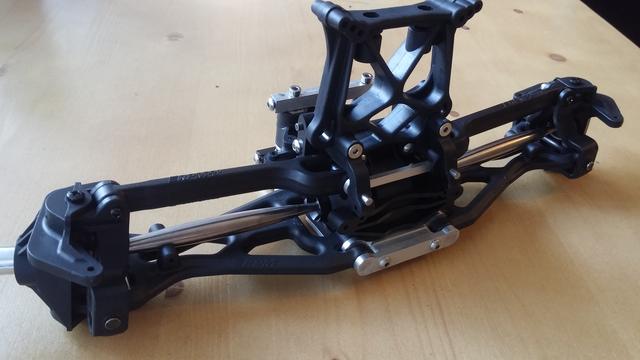

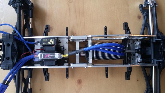

Acquired parts for the first build.
Got building.
Build one complete.
DannyP
17

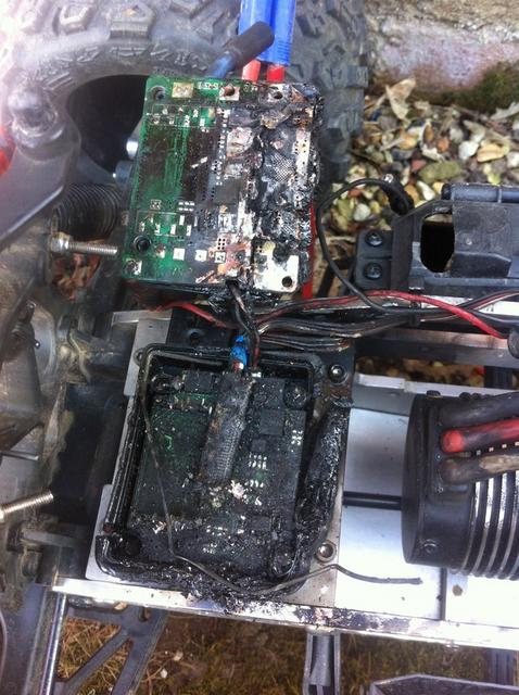

Then.......FIRE!

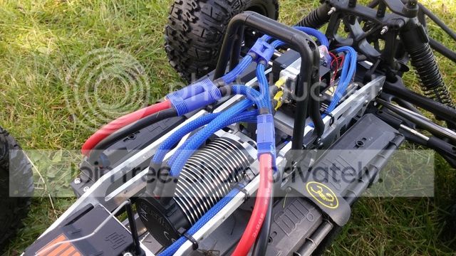

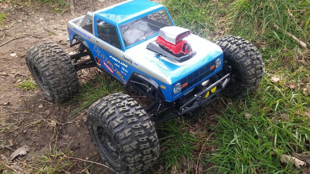

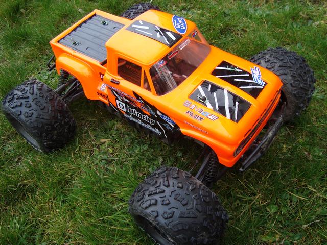

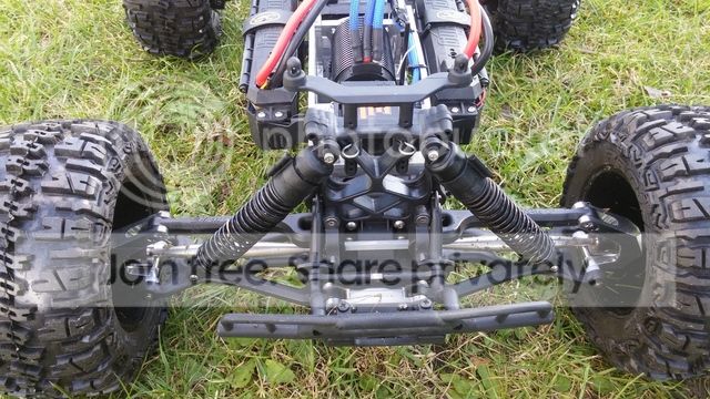

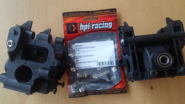

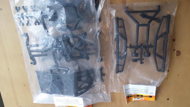

After beating on the truck a bit I pretty much replaced all the plastics and bearings as well as upgrading a few more things.
That was build two.
Sorry about some of the images being small but the forum doesn't seem to like some of the links but I can post as a thumbnail?..
Sorted most of the images.

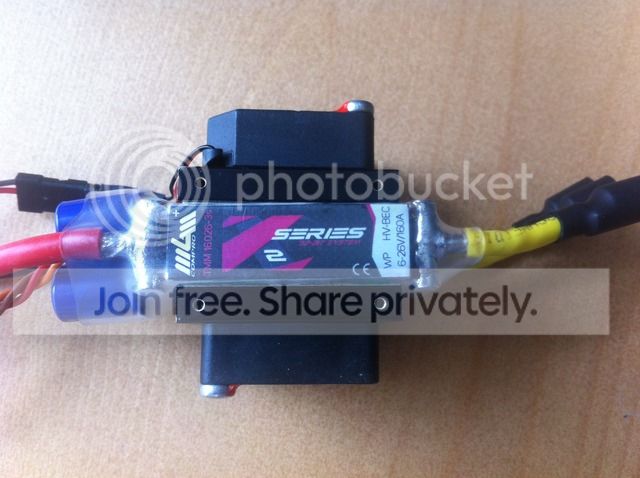

Build number 2 looks a beast (y). What lipos are you using ?
Just edited post above so you probably didn't see before you posted. I was just using the standard blue Turnigy LiPo's.

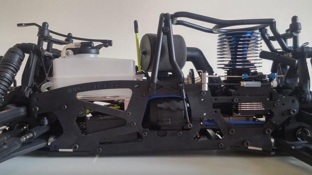

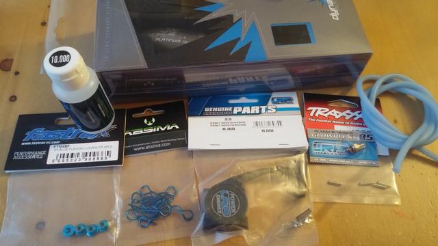

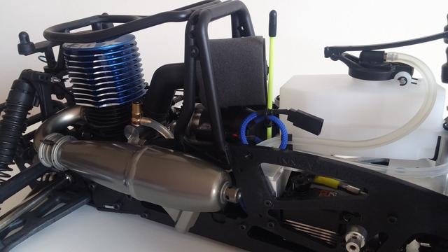

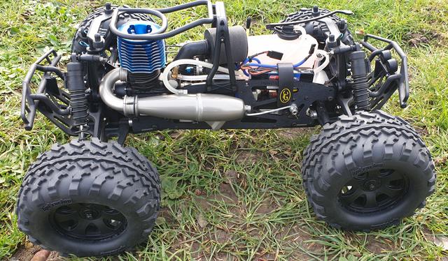

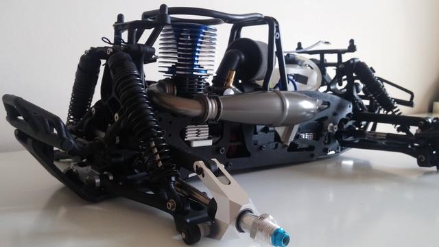

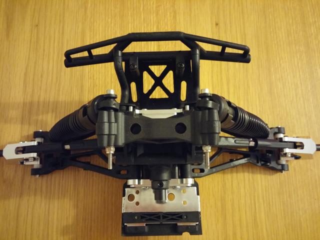

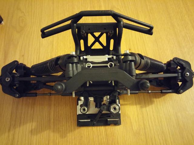

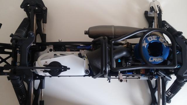

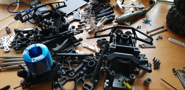

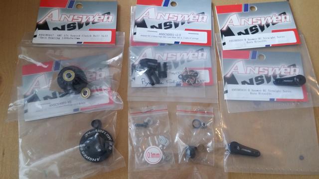

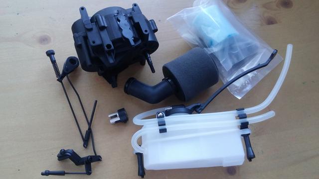

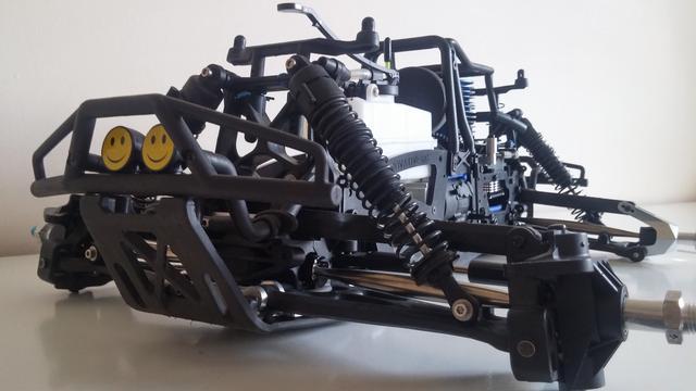

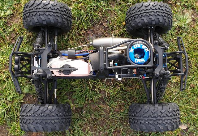

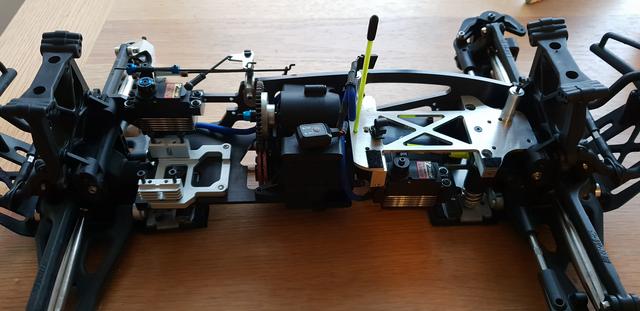

So that was build 3 and it's still pretty much the same. I ran the engine in and still not run it in anger. The truck has sat for a good while but with some inspiration from my 4 year old I have completely stripped it, cleaned it and started to rebuild it.
Might sound a little wierd but the truck just isn't "dumb" enough. I converted it to nitro after watching my friends bash there nitro Savages. Wheelies, tip overs, smoke, screaming nitro engines, madness! This thing feels like a truggy.
So I am making some changes.

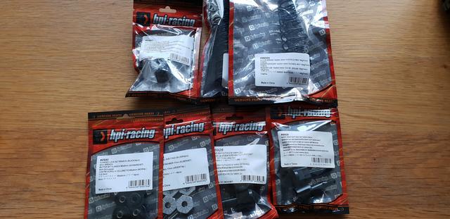

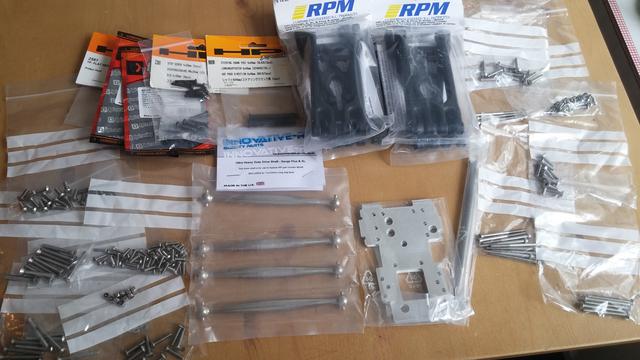

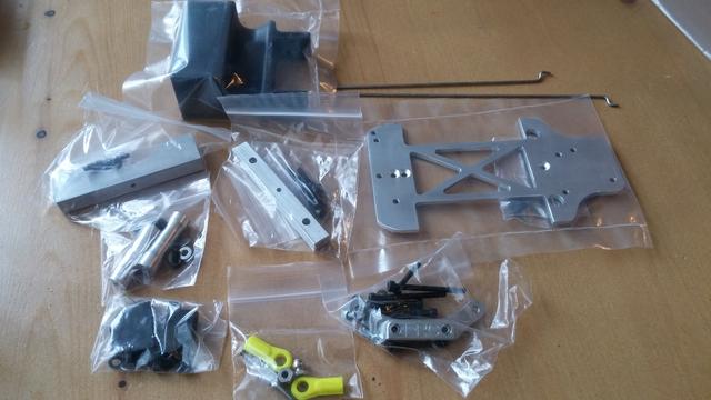

Hellfire red springs
Super Heavy Duty X axles
17mm hex and pins
Flanged lock nuts
17t HD clutch bell

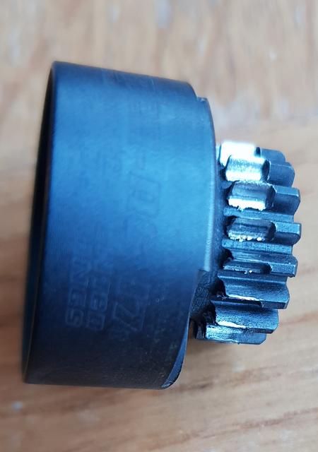

HD clutch bell to replace this. Steel spur ate it.
This is where I am at right now.

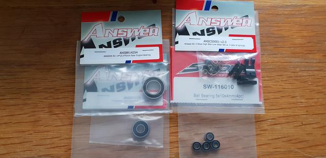

Waiting for new clutch bell bearings to arrive before I can do anymore, forgot them on the last order :wacky:
So that's it, the short version of the story so far.

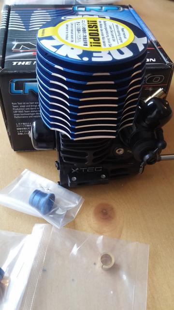

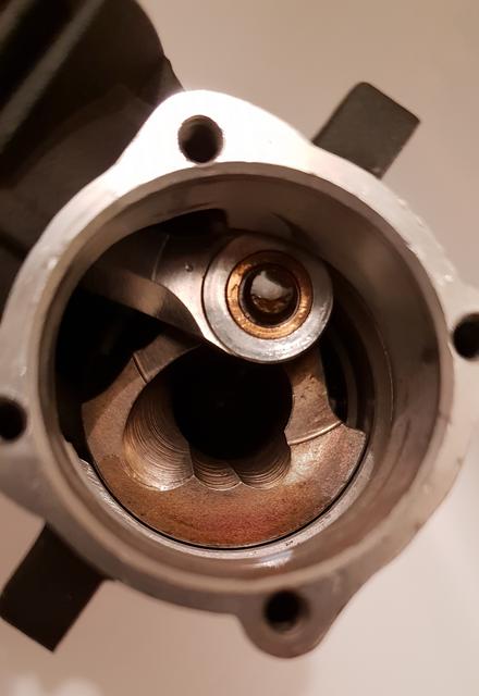

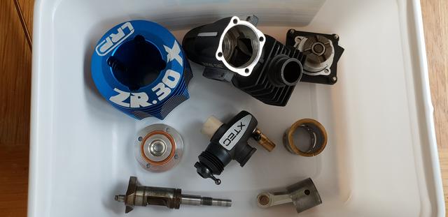

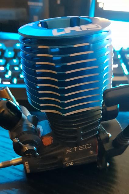

Stripped engine the, some surface rust on the crank and bearings.
olds97_lss
1,837
Dekalb, IL 60115

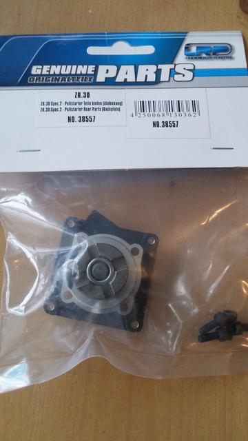

I thought the 30X was a bump start engine. A guy I ran with a few years back bought that engine, then bought the pull-start backplate, owb, starter, starter shaft and crank. Seemed like a long and expensive way to go about it to me.
Looking at the parts comparisons now though, looks like they use the same crank. Different piston/sleeve and carb though. Normal 30 being a 5 port vs X's 7 port. Probably good for a few more rpm's. Got any video of it running from before?
DannyP
17
Yes you a correct, the 30x comes as a bump start. All I got was the backplate with OWB and pullstart to convert.
Unfortunately I don't have any videos at all. The engine has probably seen 15 tanks maximum but I neglected it a little in the fact I didn't use AFO the last time I used it and let it sit for well over a year with no use.
I actually never really got it fully tuned tbh and I spent a lot of the time trying to get the 2speed set up.
Engine now rebuilt and sealed as per the thread on here.

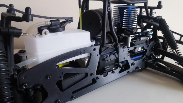

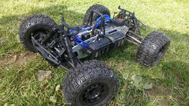

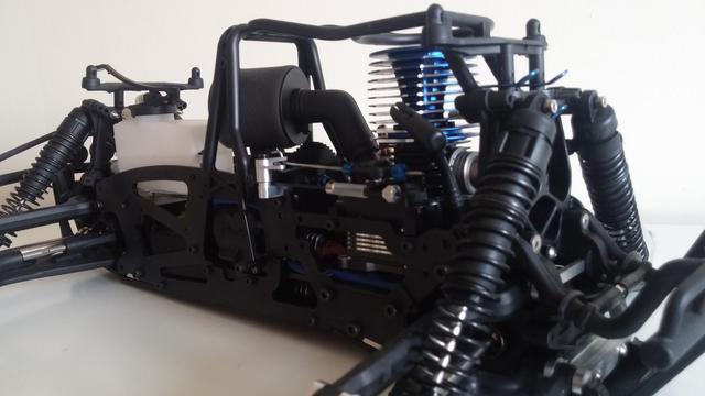

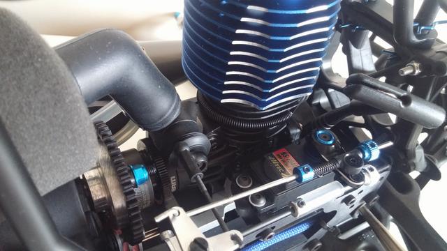

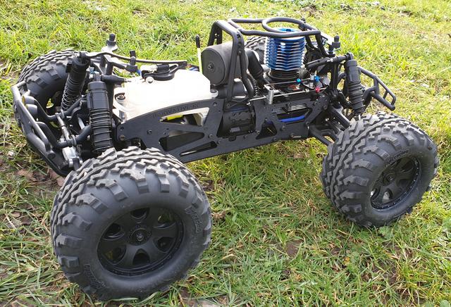

Weather has been terrible here in England so waking up to a clear sky mean't my boys where straight on my case to get the LiPo's on charge so thought I would take the Savage for a little shakedown after the strip and rebuild.
As they drove around a water logged BMX track I stayed in the carpark.

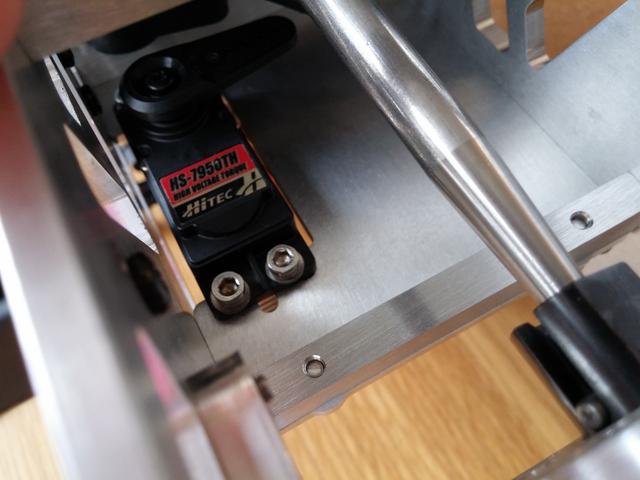

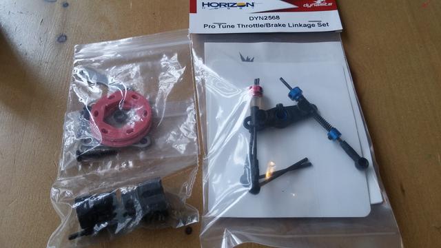

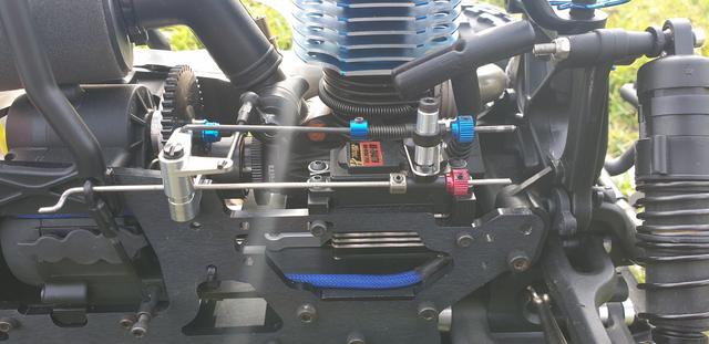

Got the linkages all sorted so everything has clearance. Smooth and it snaps back to idle with no movement of the carb slide under braking. After taking this pic I realised the brake rod end wasn't where it was supposed to be 🤪
Fired right up, idled well and popping on acceleration. No room to really open it up to get a final tune or set gear changes tho.
Harder springs doing a good job of holding the weight of the truck and not allowing it to wallow around under acceleration, braking or cornering. Will have to wait to see how it performs on a proper run for landings.
After each pass I brought the truck in to check it over a discovered the carb had come loose so I will be removing the sealant from the carb neck.
Overall happy and can't wait for better weather to give it a good run.
